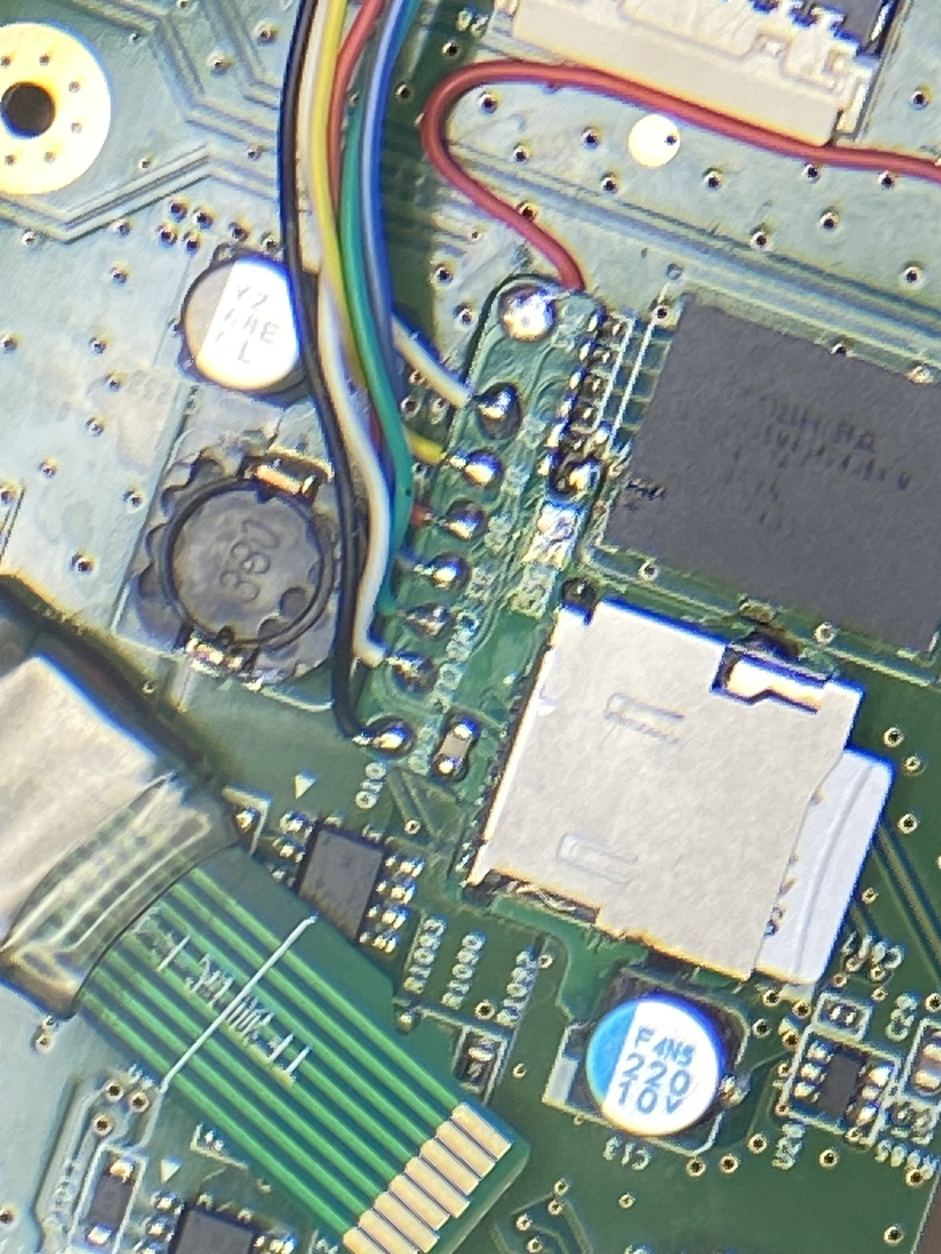

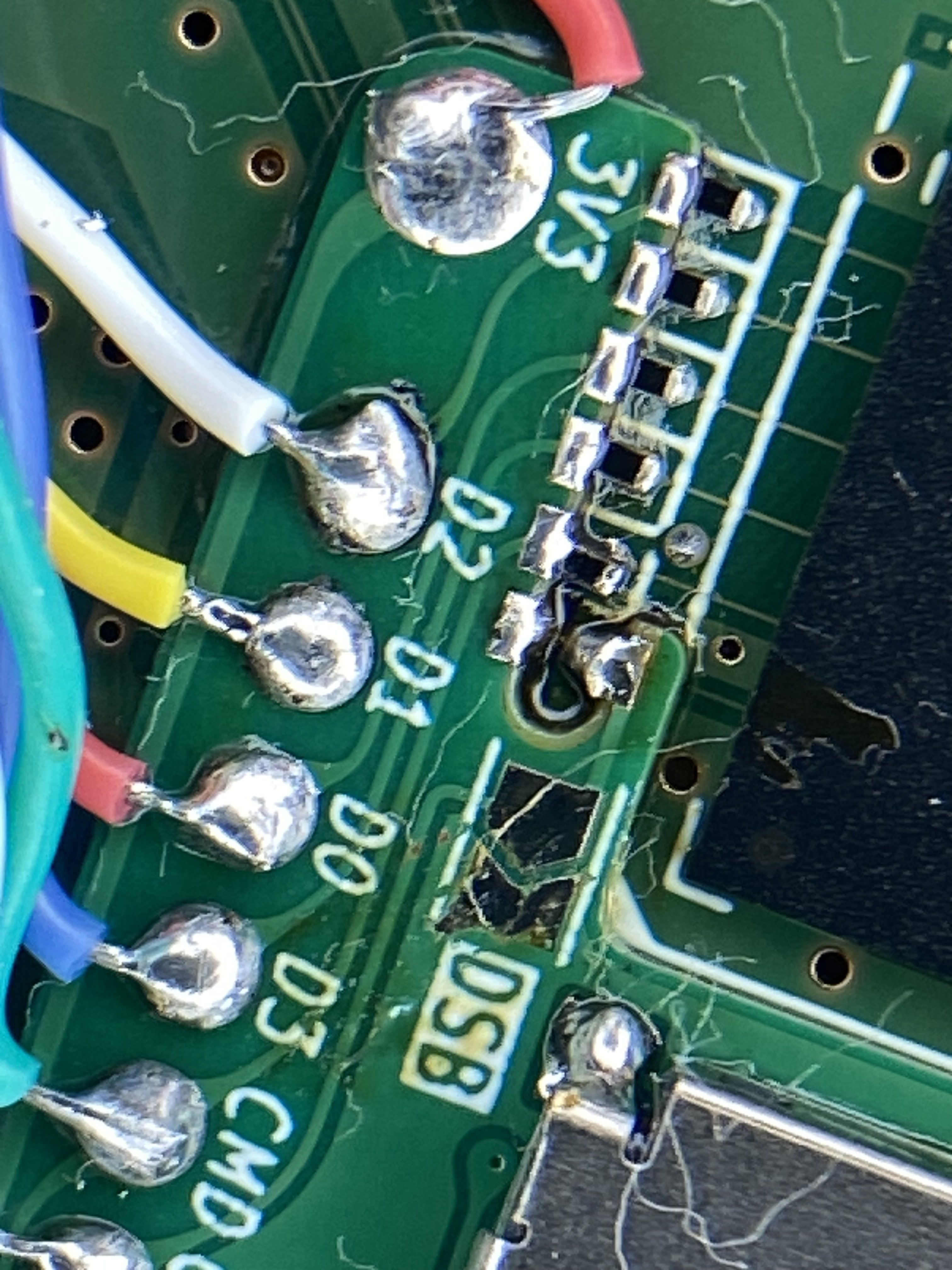

I installed a nand-aid on working a soft-modded (Aroma) WiiU. I know I shouldn’t have tried to do this because there was no nand issue before, but I just wanted to see if I could do it. I repair console and wanted to see if I could accomplish this but I’ve failed. Ultimately, I can just use this console as parts if I bricked it completely.
I backed up everything except for the MLC when I soft-modded the console. I powered down the console, installed the nand-aid, connected the nand to the computer via the SD pins on the nand-aid and used Win32DiskImager to read the entire nand three times. I compared the dumps with diff and all were the same.

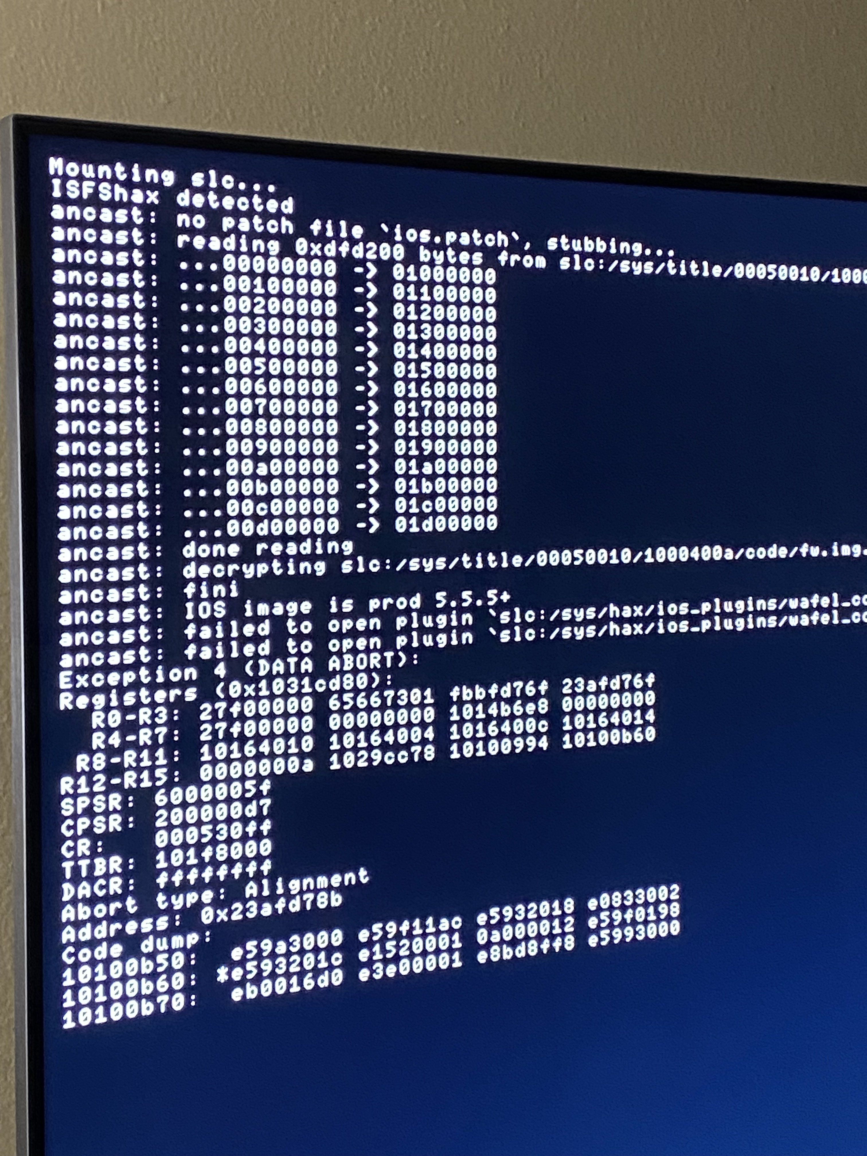

I booted the console and it goes straight to minute. When I try to use option “patch (slc) and boot IOS (slc)” I get “Abort type: alignment”.
I assume that means SLC and MLC are out of alignment.
What can I do to fix this? I tried restoring SLC but still can’t get the WiiU OS to boot.
I tried with the DSB jumper closed and opened on the nand-aid but still no luck.
Thanks for any help in advance.

You probably don't have the wafel core and isfshax patch on the SLC, but on the SD, so you need to choose the third option: "Patch (sd) boot IOS (slc).
Since the patches are missing, minute tries to execute garbage (when it means to execute the main in the patch) and that is causing an unaligned memory (RAM) access. Since ARM can only do aligned memory access, this is causing a crash.

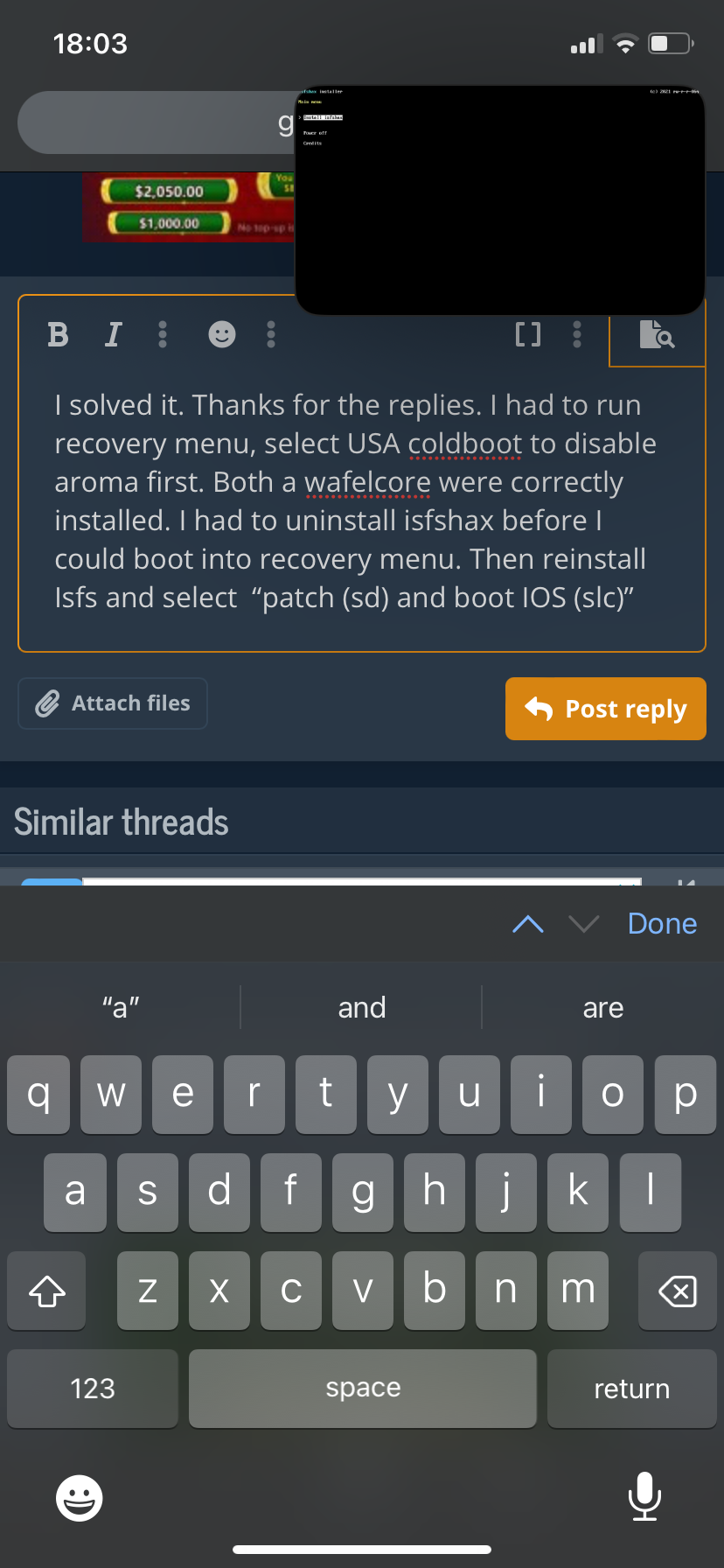

I solved it. Thanks for the replies. The forum is not letting me post certain words so I can’t post the solution. I’m too new I guess. So see the image for solution. That sd card breakout was expensive and I think some people sell a similar device with the nand aid but the one I got from violator only came with the nand aid.
