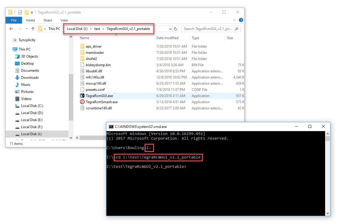

4. Copy biskeydump.bin to the TegraRcm GUI folder.
5. Open a command line and go to the TegraRcm GUI folder.
6. Run this on the command line
TegraRcmSmash.exe -w biskeydump.bin BOOT:0x0
