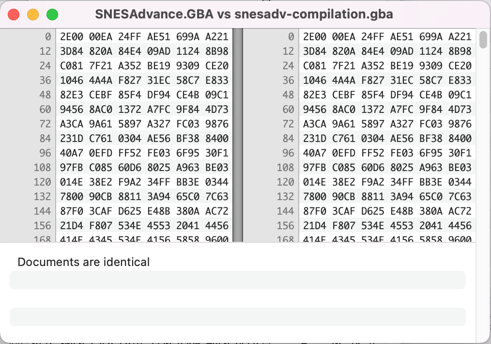

I have made a builder for SNESAdvance :) available at the above GitHub repo.
I was able to code it to produce the same output as the old Win32 application, relying on the SuperDAT file, thanks to this handy technotes.txt document. You can also replace the graphics assets in the same way as before, provided the relevant graphics files are present in the same folder. I did however extract and embed the default skin into the Python script to avoid having loads of file dependencies.
There is one thing I can't seem to figure out though. The official builder application is altering the autoscroll Scale value which is written out to the compilation. All the other flags and settings are written out to the ROM header exactly as the values in the SuperDAT but for some reason this one is being altered. I cannot figure out why, nor what the pattern is. For instance:
  • Super Mario World - SuperDAT scale value 0A becomes 19 via SNESAdvance.exe
  • Chrono Trigger - SuperDAT scale value 05 becomes 0C via SNESAdvance.exe
  • Gradius III - SuperDAT scale value 32 becomes 80 via SNESAdvance.exe
My script follows the spec and writes the value from the SuperDAT, but I can see that the behaviour of the official builder gives more optimal display results. These bytes are the only divergence between my script and the original Win32 builder.

Comparing hex numbers is hard on the brain. A bit more analysis does reveal a pattern, though as a coding amateur I'm not seeing how to replicate it perfectly:

Ok got it. As the numbers grow larger the scaling factor trends towards 2.56 which resembles a power of 2, not x2.5.
The easiest way to get x2.56 without floating point numbers is to multiply by 256 (0x100) and then divide by 100 (0x64).
Applying this operation precisely matches the observed hex results. Hooray. Well this has been a fun challenge :).
scale = int((scale * 0x100) / 0x64)
The result of building a compilation of all of the above ROMs in the original builder Vs my script:
SNESAdvance build script complete! Preservation goal achieved.
