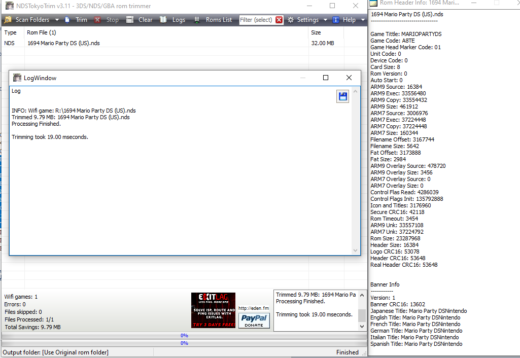

I doubt I even have to link you one. Within nds-bootstrap, the one major game with this issue was Mario Party DS, as its multiplayer mode is solely cloneboot.
Interestingly enough, some testing on my own end seems to show that it works. (It also detected Mario Party DS as a Wi-Fi game, but it isn't... perhaps that's why it works?)
Well, the rom does have a Wi-fi section though, 136 bytes after the game data, my app detects and keeps that:
1694 Mario Party DS (US)
Rom Size: 23.287.968

Hi, does NDSTokyoTrim retain the 0x88 bytes at the end of the trim data for NTR cartridges? This is specifically required for usage of cloneboot-based Download Play playback on real hardware, as those 0x88 bytes are the RSA keys.
TWL cartridges do not have this issue as the 0x88 bytes are within the "data size" header of the ROM image, but NTR carts don't retain this.
In this case as the per rom data in the file, yes, it does keep those 136 bytes. The app checks for this block on its own, it doesn't follow some rom database to determine whether or not to check for it.
