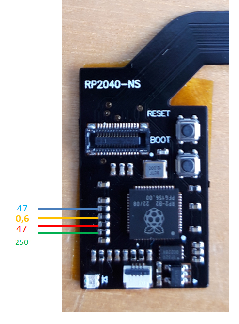

Thanks for the feedback. I took the chip out and measured across the resistors, this is what I've measured so far.
I guess the 250 one is dat, the other two 47 makes sense for the clk. The 0.6 one seems off, maybe that's the problem?

Yea, that's what I thought. Unfortunately, I don't have any 100ohm resistors on hand. I ordered a few resistors and two new RP2040s so I can compare the values on them. They should arrive in 10 days, I will update the post with my findings.

Is there any update? I have the same one reading the same values and am wondering if i need to replace the resistors also.
Is there any update? I have the same one reading the same values and am wondering if i need to replace the resistors also. Also to note it is brand new and never installed yet.
