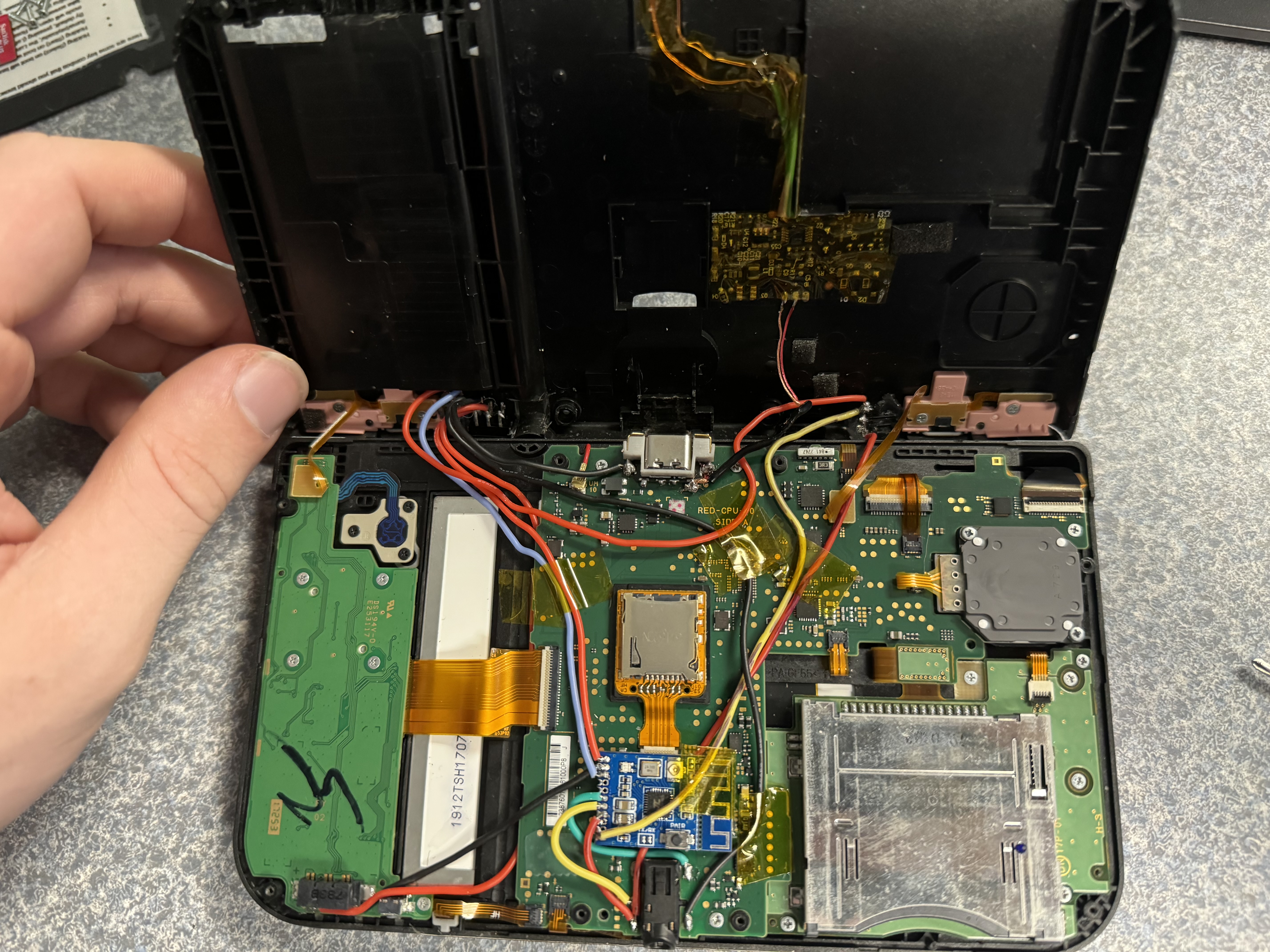

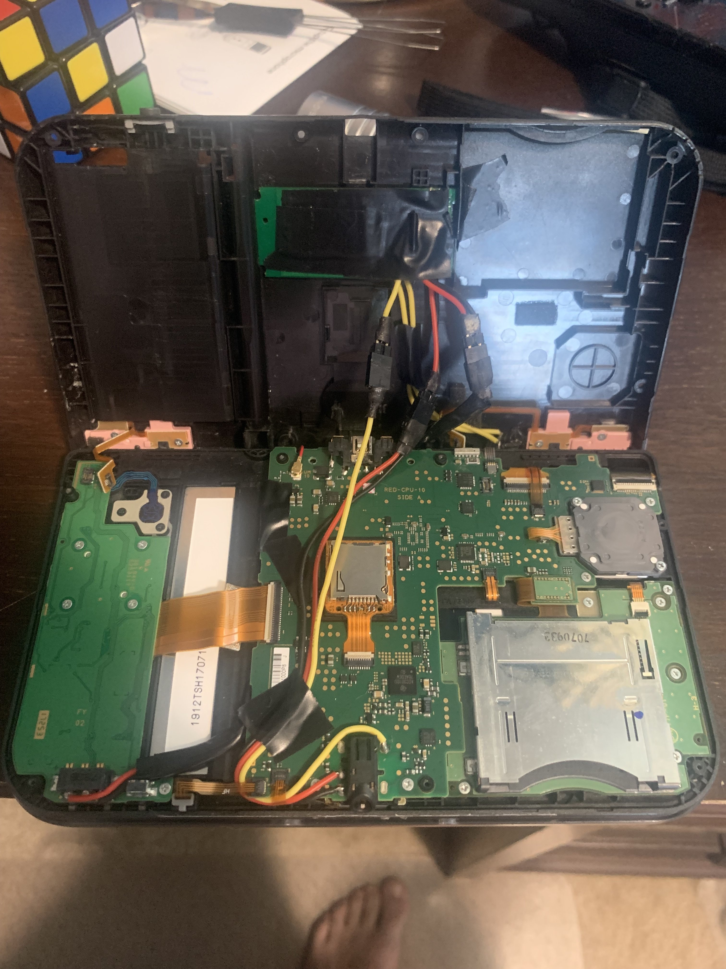

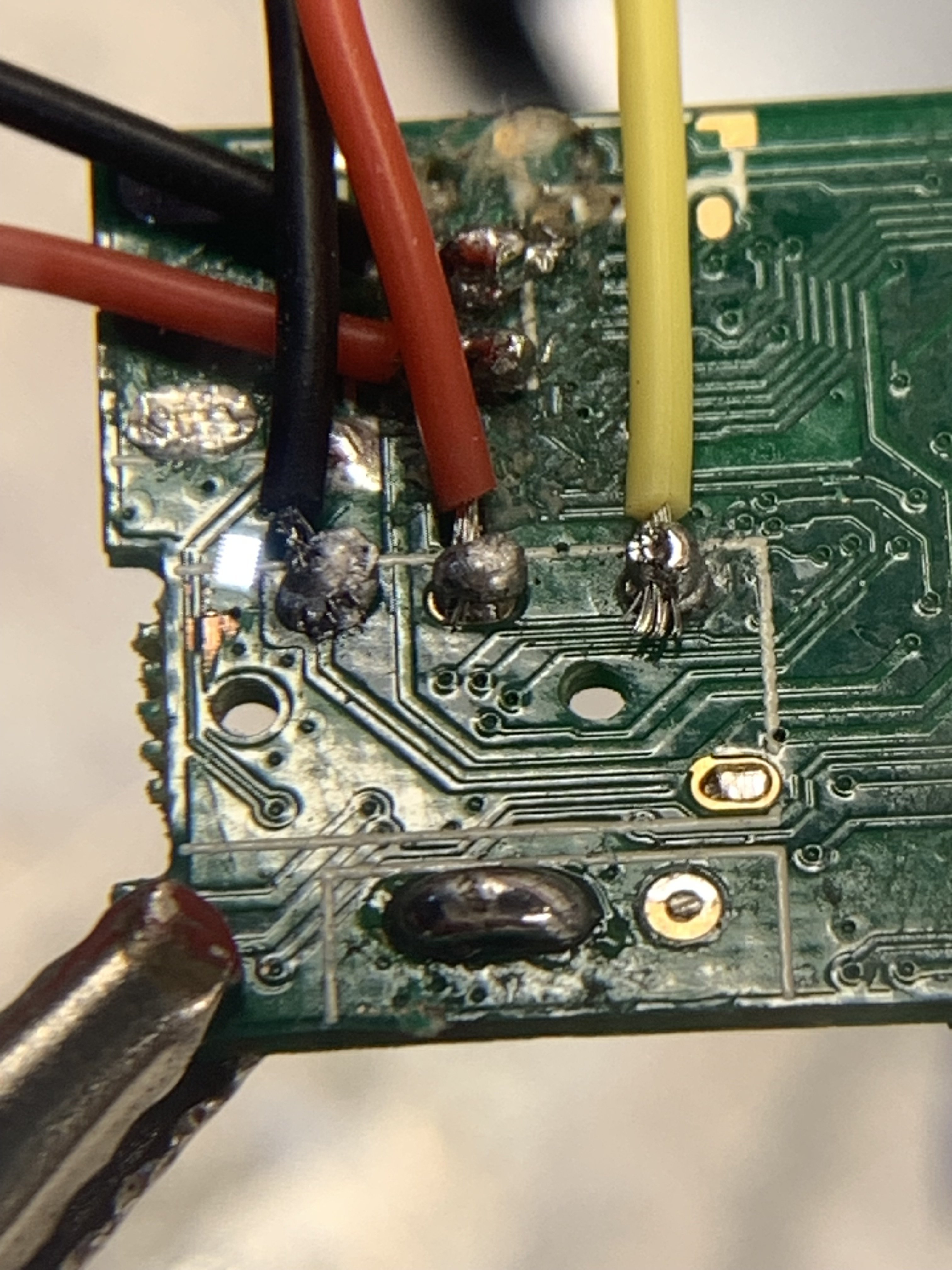

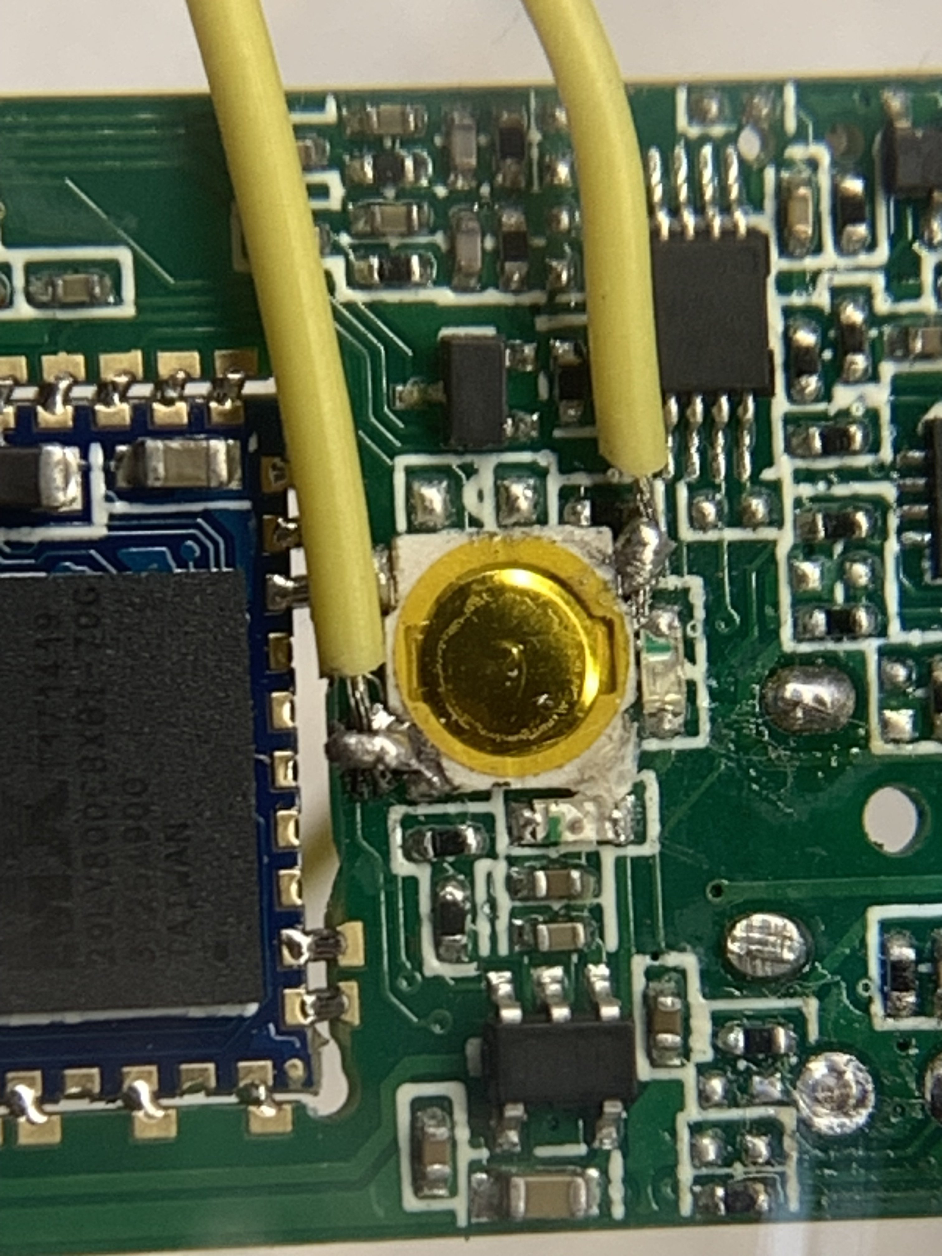

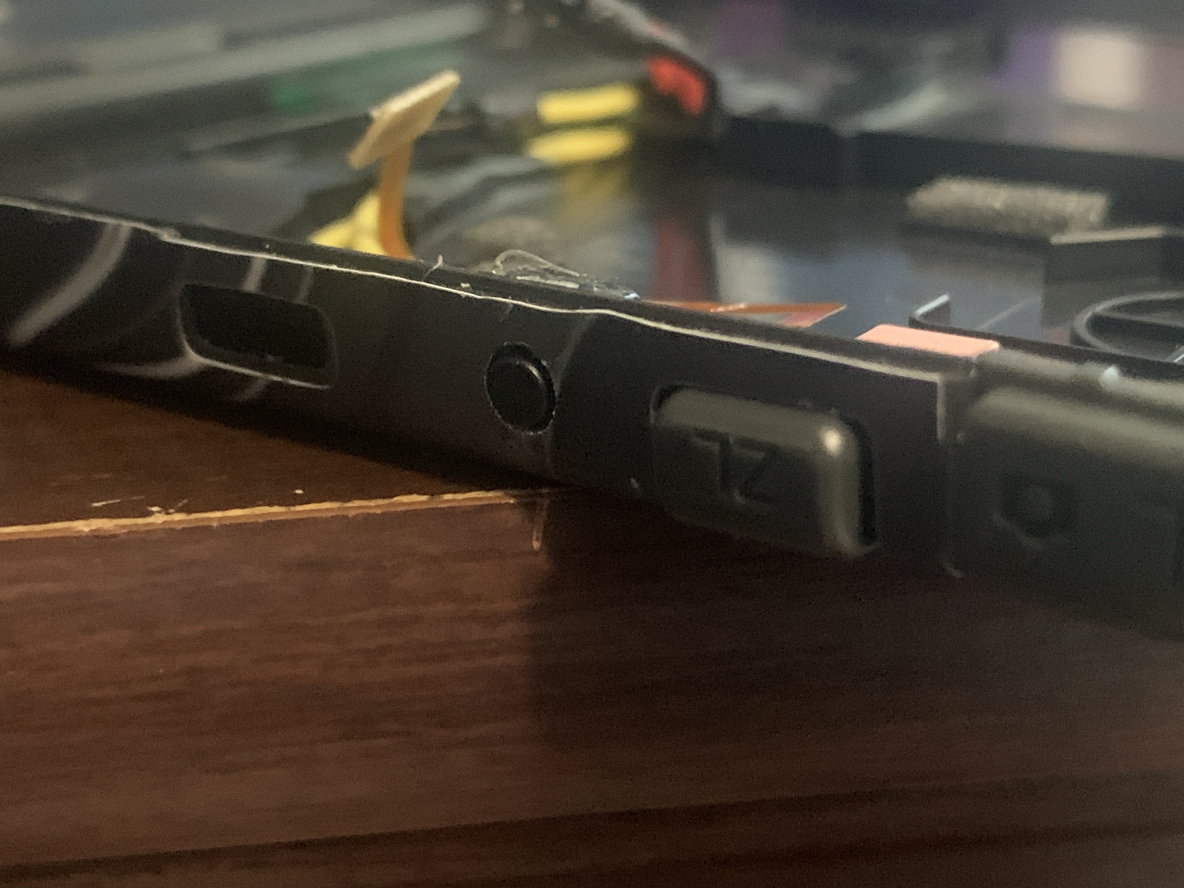

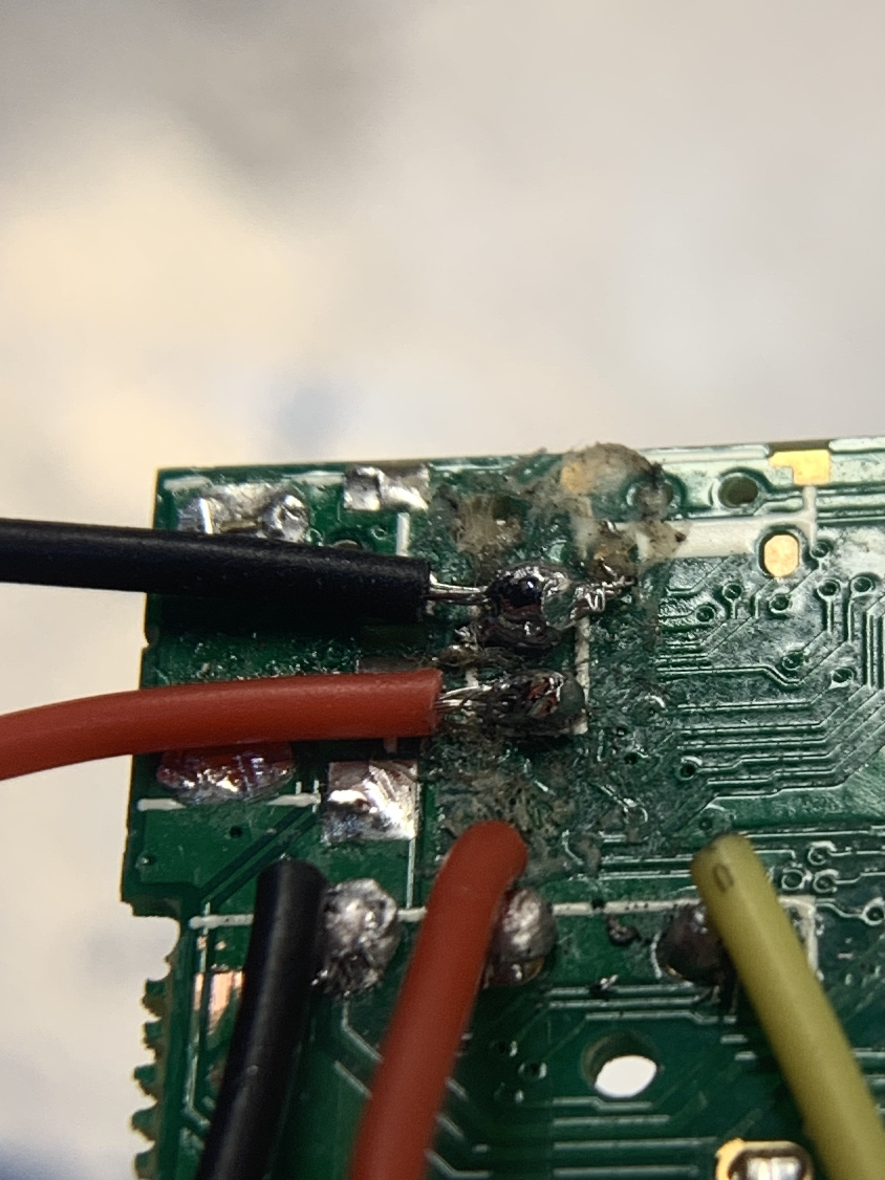

Don’t mind my bad soldering 😅 but I managed to get all the solderwork done up on the chip. Tomorrow hopefully it should be done, or mostly. Let’s hope I finish it tomorrow for my sanity’s sake
coconutmallman
Aug 28, 2023
11
18
51

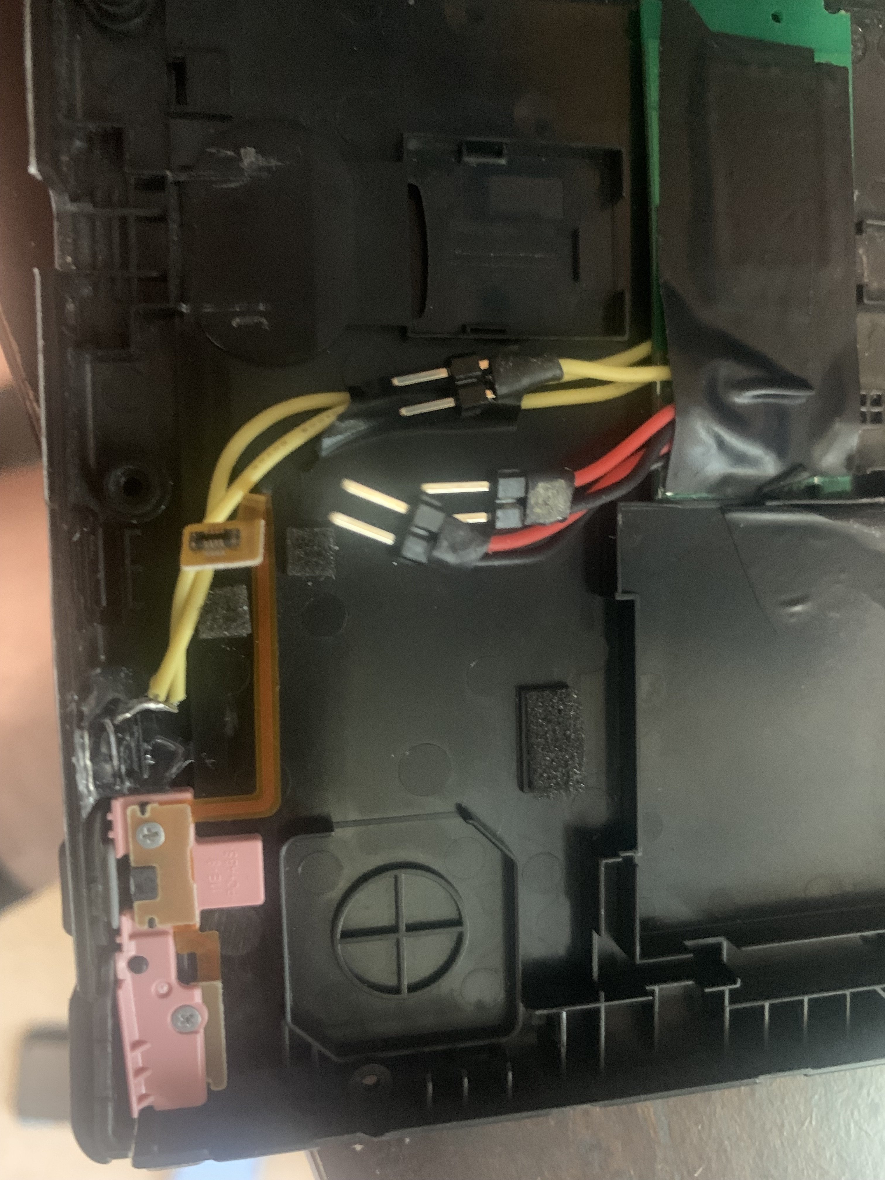

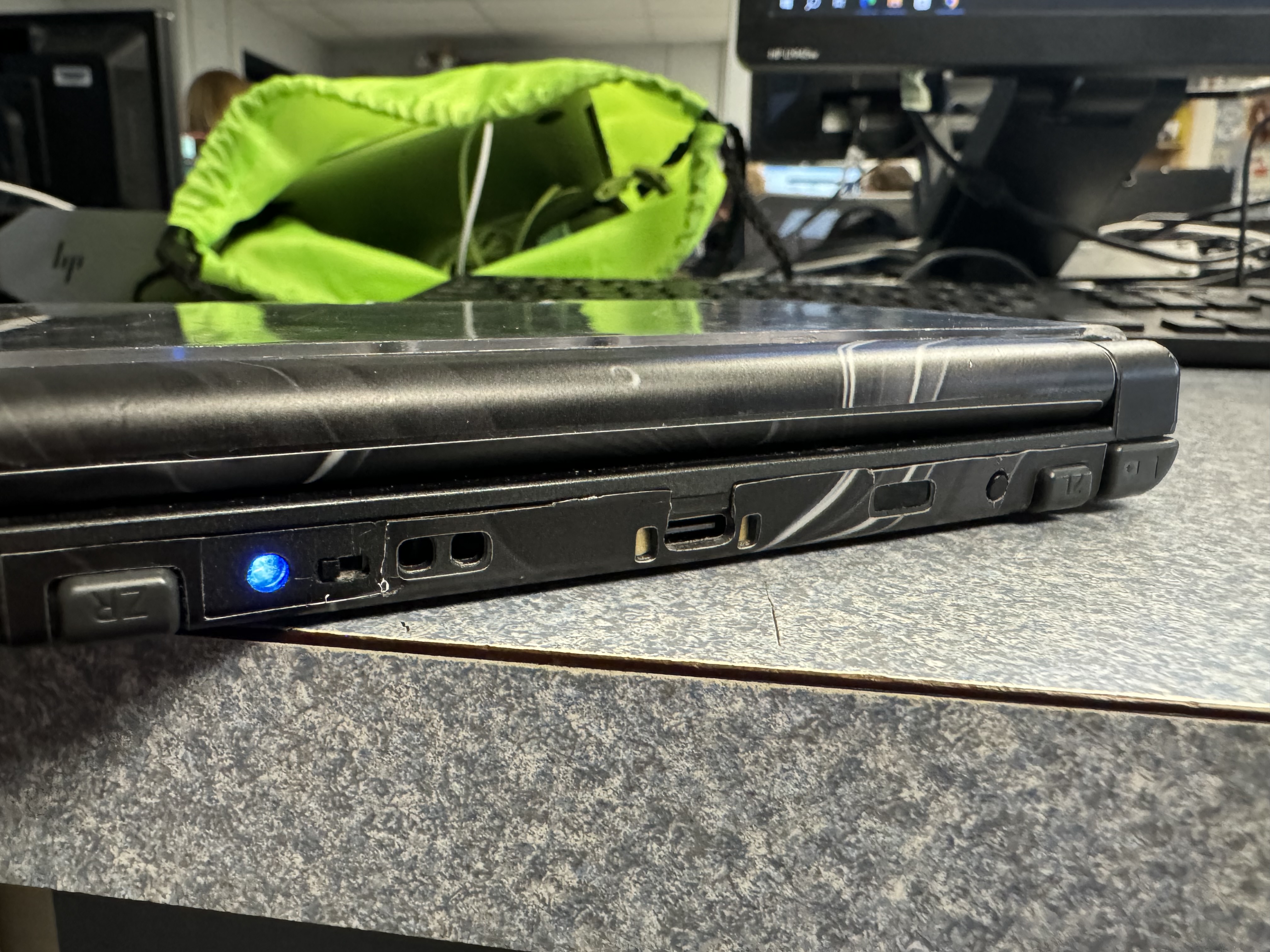

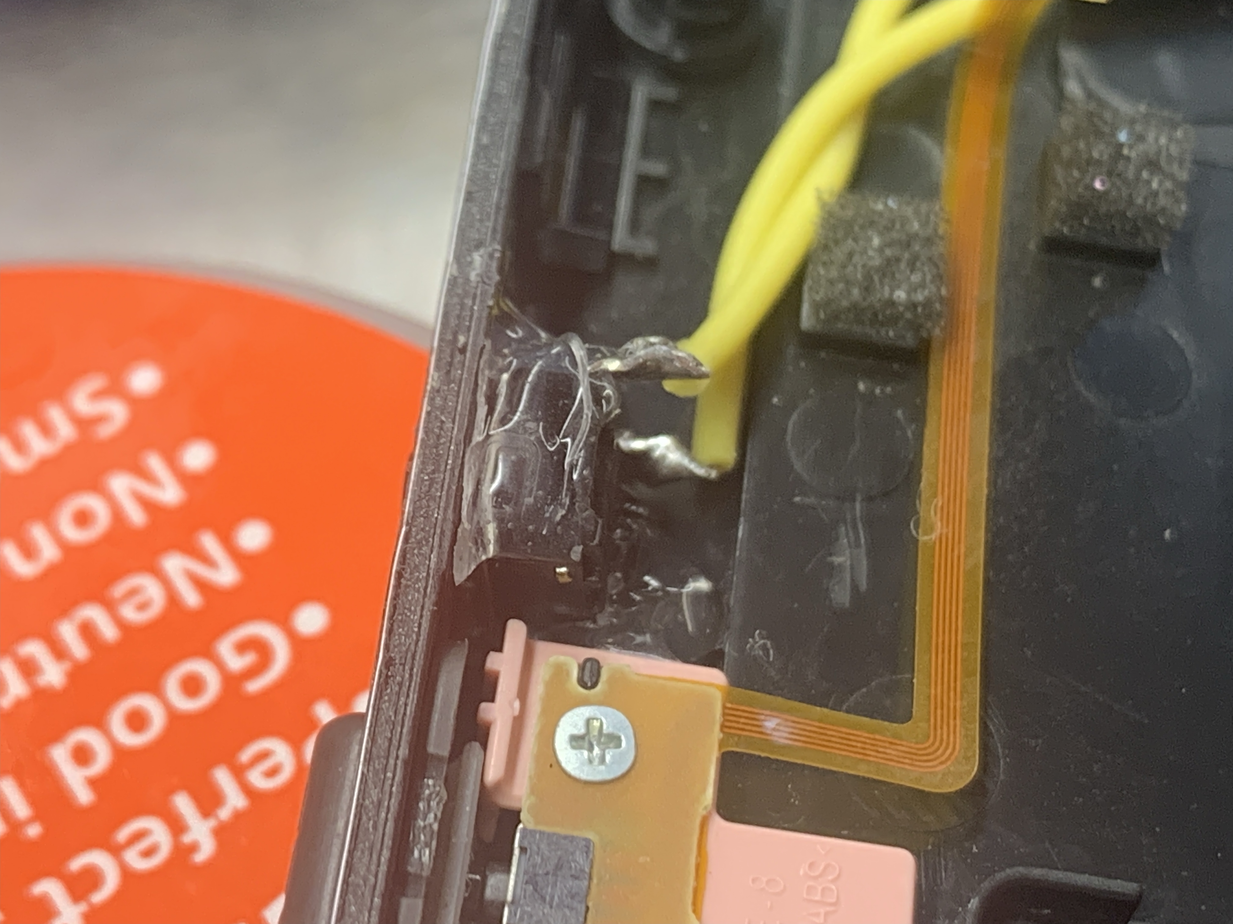

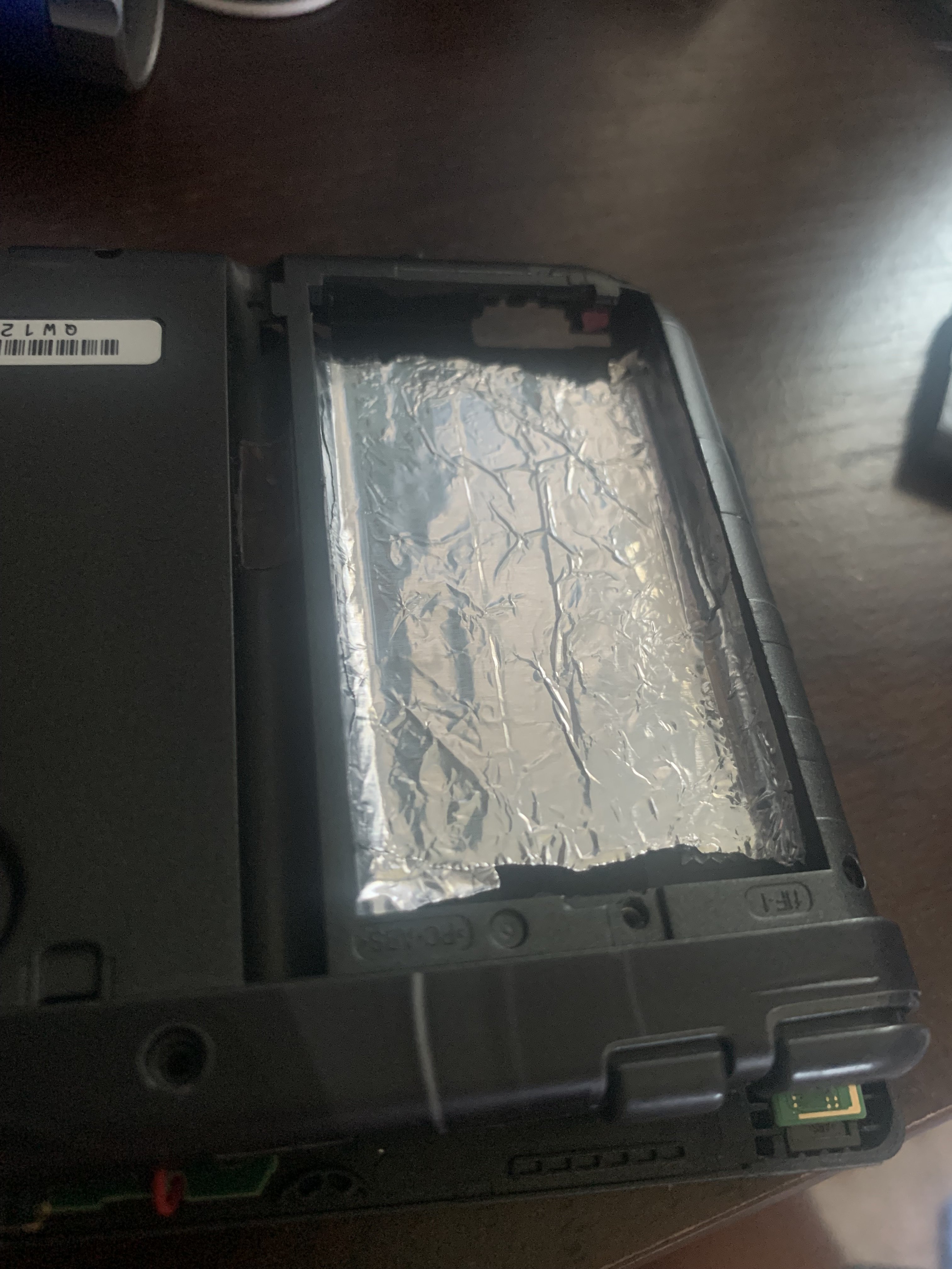

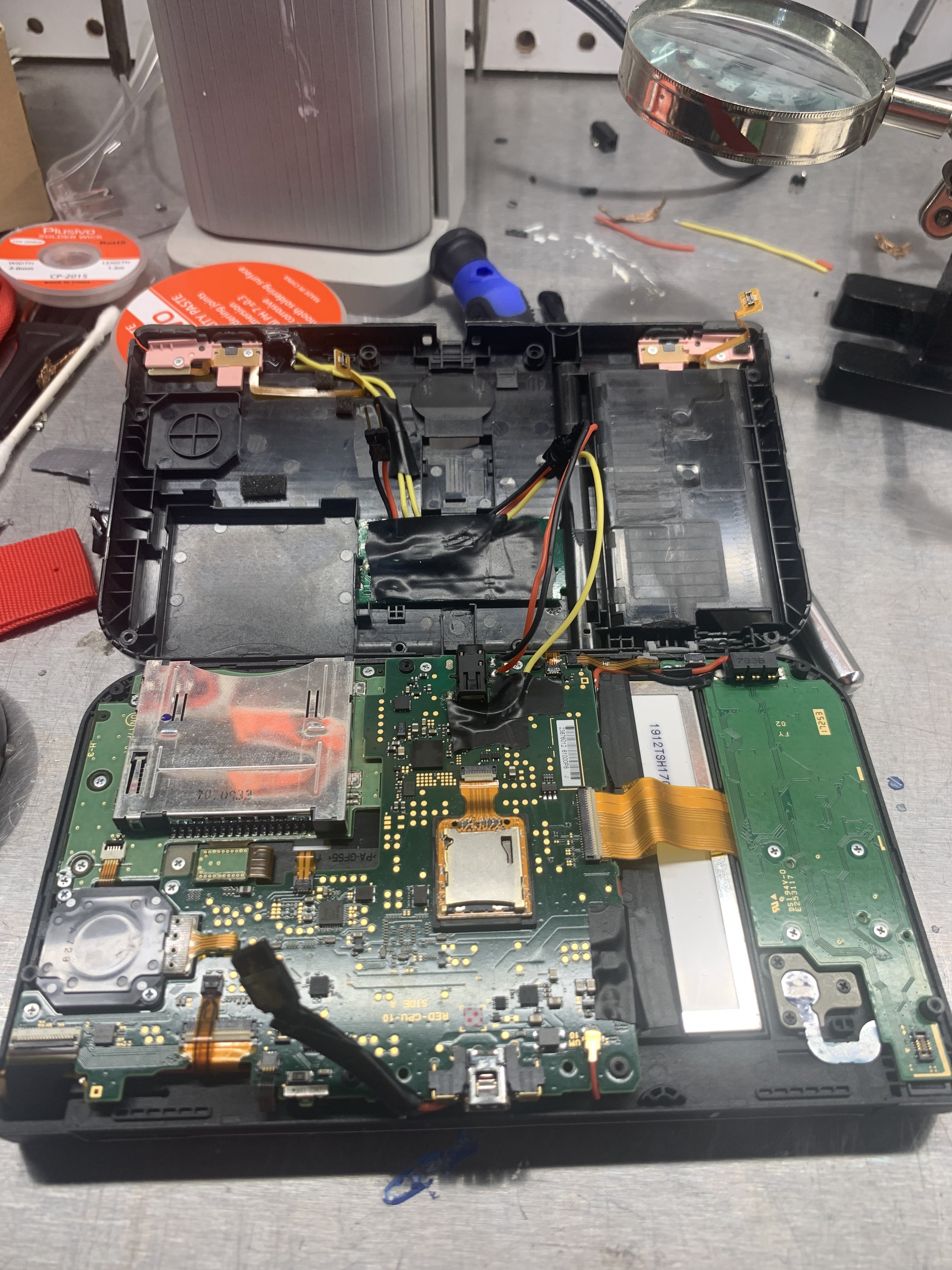

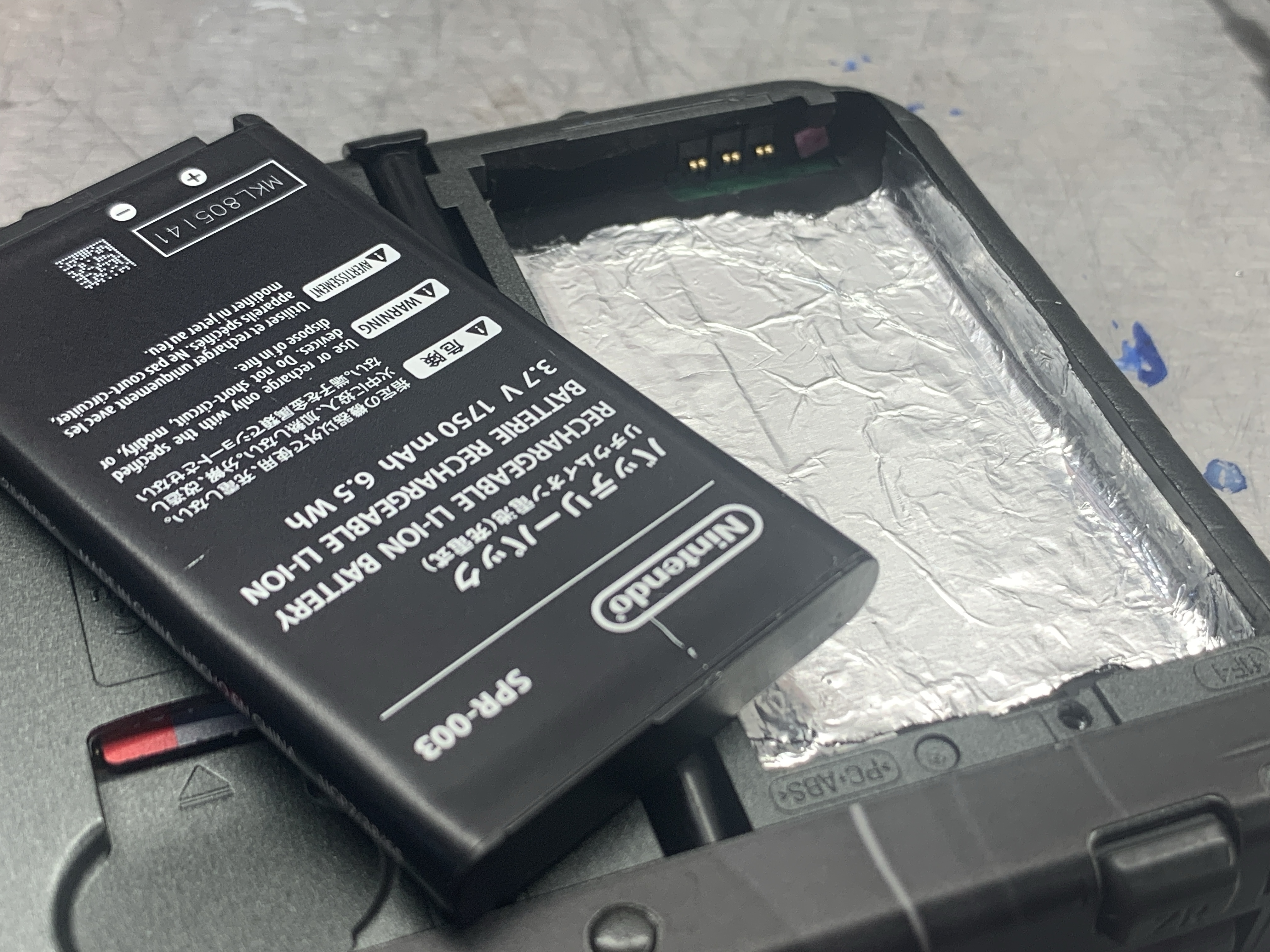

Ok so it’s basically 100% working now, with the chip and wiring all contained within the 3ds! I just have to work on two things:
1. Resoldering and rearranging the wires so that the case actually fits on the back 😅
2. Figure out how to get rid of the very prominent background static. I’ve shielded the battery compartment with aluminum foil and have shielded most of the power cables running to the battery as well, yet the feedback persists. I could use some help on that…

I can send you the ones I attempted to use but I couldnt make everything fit with a connector, so the headphone Jack cables are soldered in but the power for the Bluetooth chip is removable. I just finished this mod I’ll post something in a bit.
Female end: https://www.pololu.com/product/1012
Male end: https://www.pololu.com/product/965

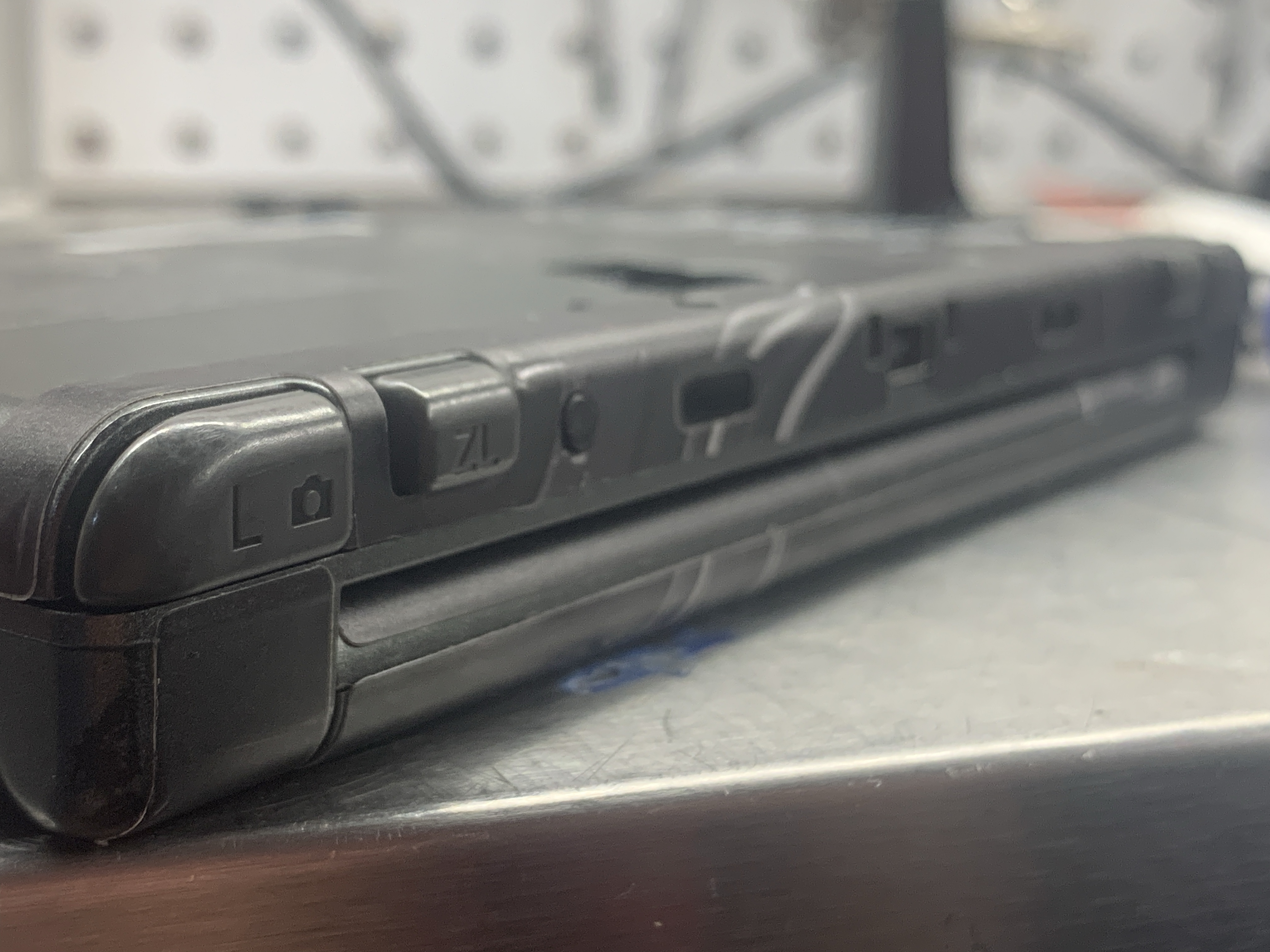

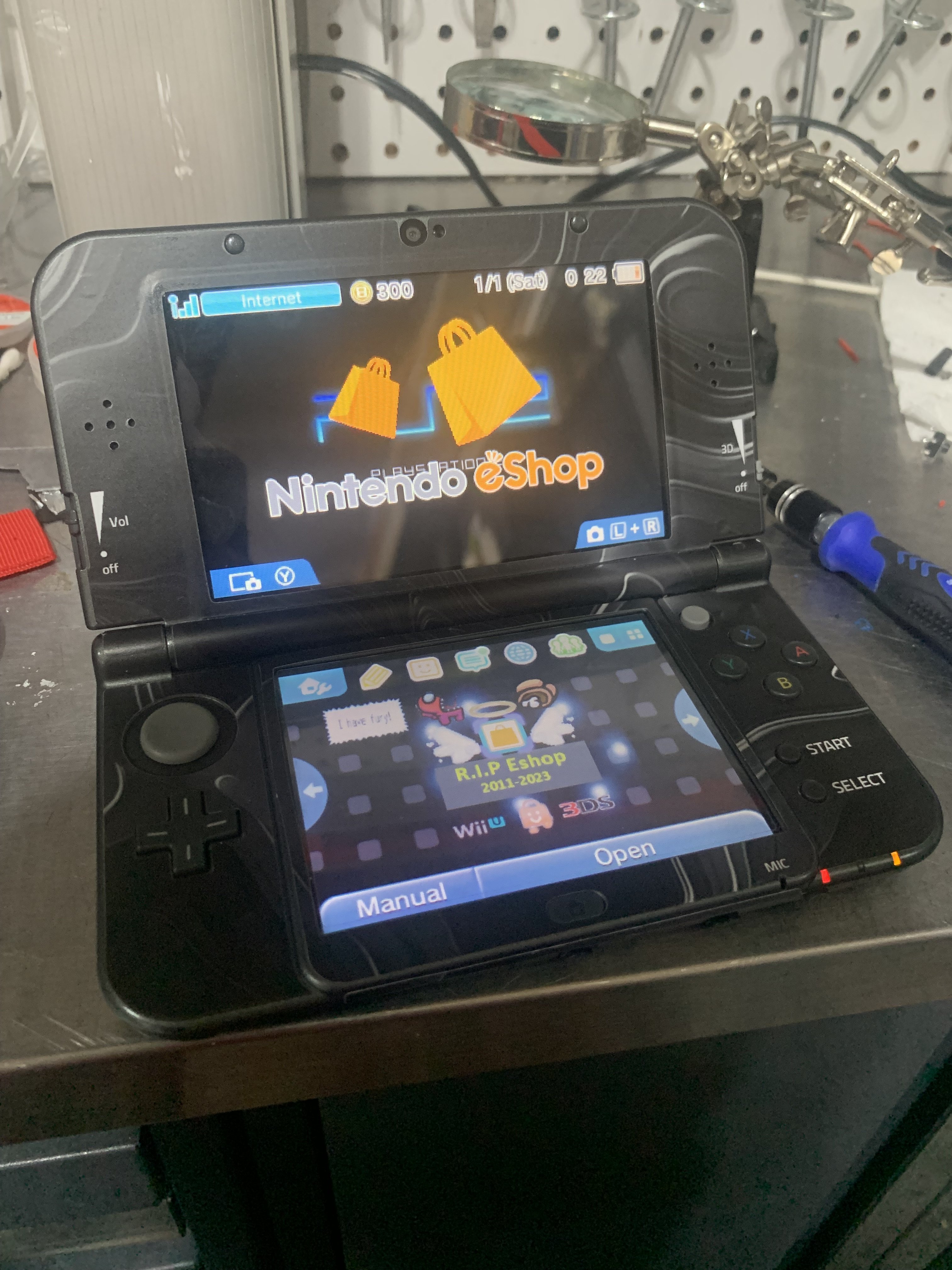

All done. A few things that have to be tweaked but I’m pretty happy overall. Latency is far lower than I thought (idk why but it was a lot worse earlier). Next up is wireless charging and usb-c, but first I’ll have to put in a switch for headphone-Bluetooth switching and find a place for the led indicator for the bt chip. Onwards to my own “ultimate” 3ds!

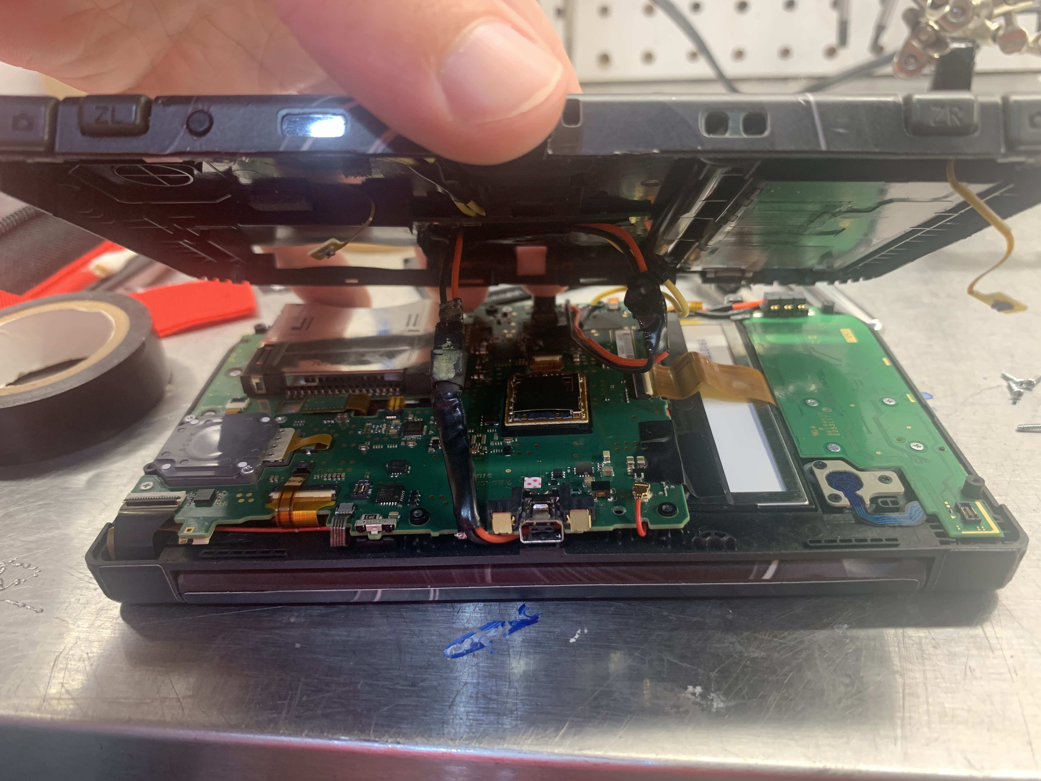

I just finished my second revision of this Bluetooth mod and it’s so much better than what I first did! I managed to find all the materials I needed that weren’t listed by people (thanks Google lens) and it turned out great
I’ll post a short video overviewing how undid it on my YouTube channel (https://youtube.com/@coconutmallman?si=I0C47FmK3xOZhHtZ)
