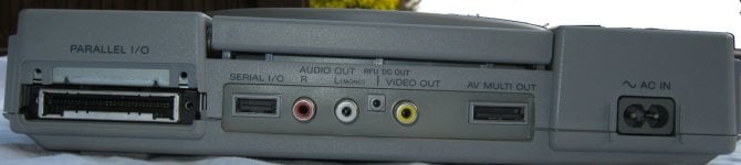

With all the interesting new exploits I decided to get a few more PlayStation 1 models. Having no console with all connectors in the collection is kind of lame anyway.
So I ordered an SCPH-1002 that was described as working but in less than ideal condition. Everything has become so expensive in 2020 and I don't think is about to change any time soon (if it will change at all). Luckily the most games, consoles and accessories I want to have are already here. I acquired my collection for the most part dirt cheap on flea markets (which do not exist anymore). Now I wish I had bought much more. Double, triple and quadruple if possible. Things used to be soooo cheap on flea markets.
Like expected when ordering a console from a professional reseller, I got a working device without a modchip. Interestingly the previous owner seemed to use the swap trick for booting backups. That is a thing a reseller will most likely not look for. I don't think that spring blocking the "lid closed" sensor button should be in that place. Pushing the lid a small bit down makes the drive start.
Like expected from an early model, the laser/drive is pretty worn down (and I expect a comment on this from a certain well-known GBAtemp member). Starting Crash Bandicoot 2 (a little scratched) took a few tries. Then Tonyhax exploit told me what I wanted to know: BIOS version 2.2
