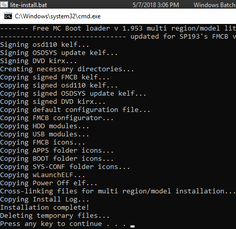

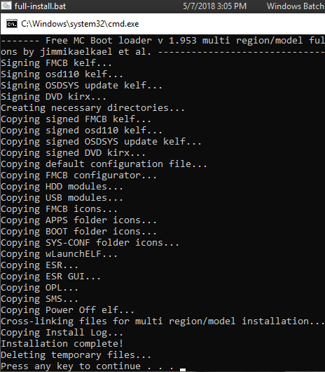

* How to install the hack with the adaptor
Windows users:
- double-click the full-install.bat file to execute it.
Linux users:
- execute the full-install.sh script with root permissions.
