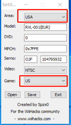

My console region is Japan, I have modified two positions,vwii becomes the english interface,I'm not sure if this is the right, the best way, but it worked:
You need to obtain setting.txt through FTP (Like FTPiiU-Everywhere), It is located in /slccmpt01/title/00000001/00000002/data/setting.txt. After completing SettingEdit editing, upload to the same location. Please backup the original setting.txt files.
View attachment 423646View attachment 423647View attachment 423648

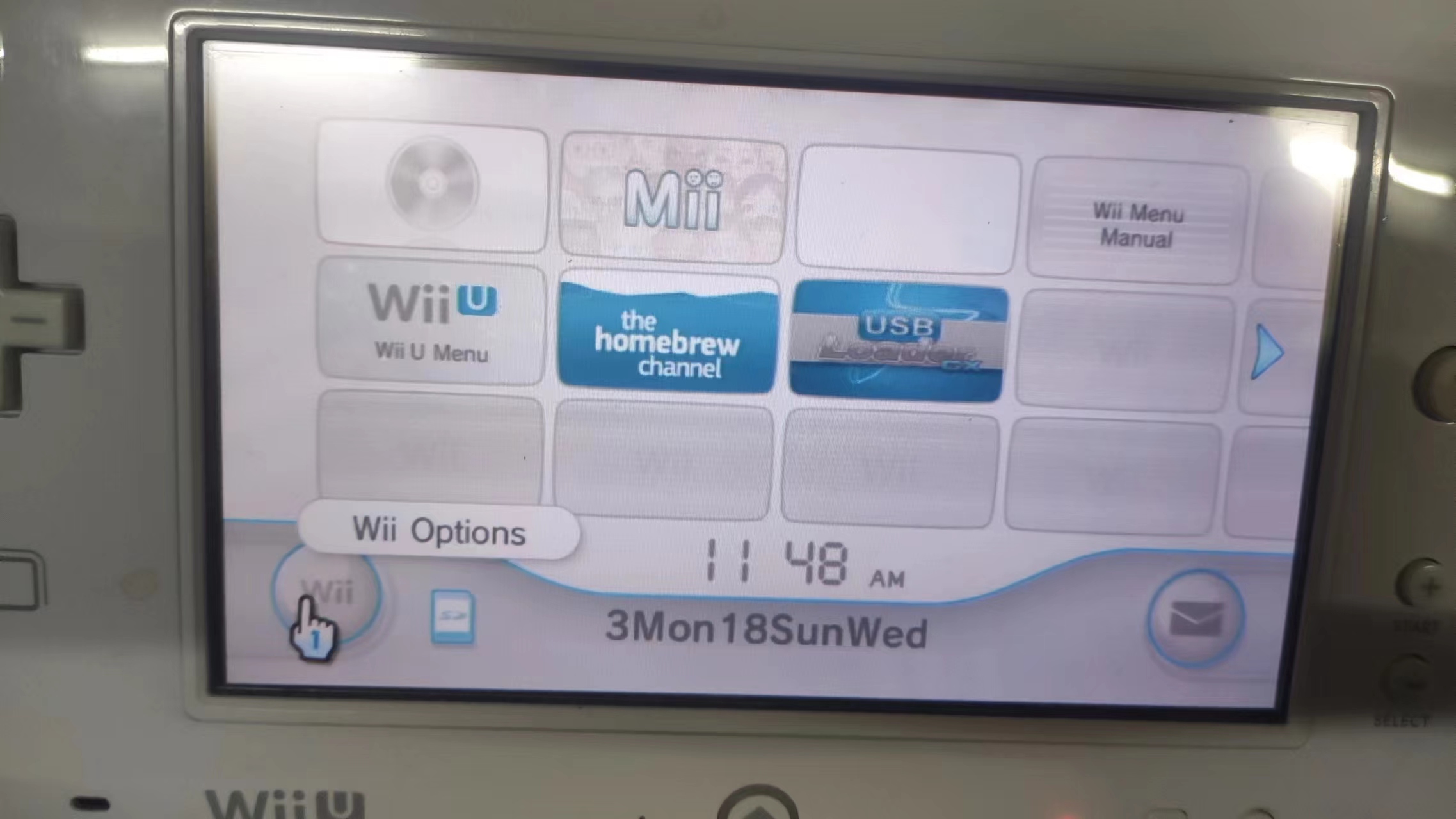

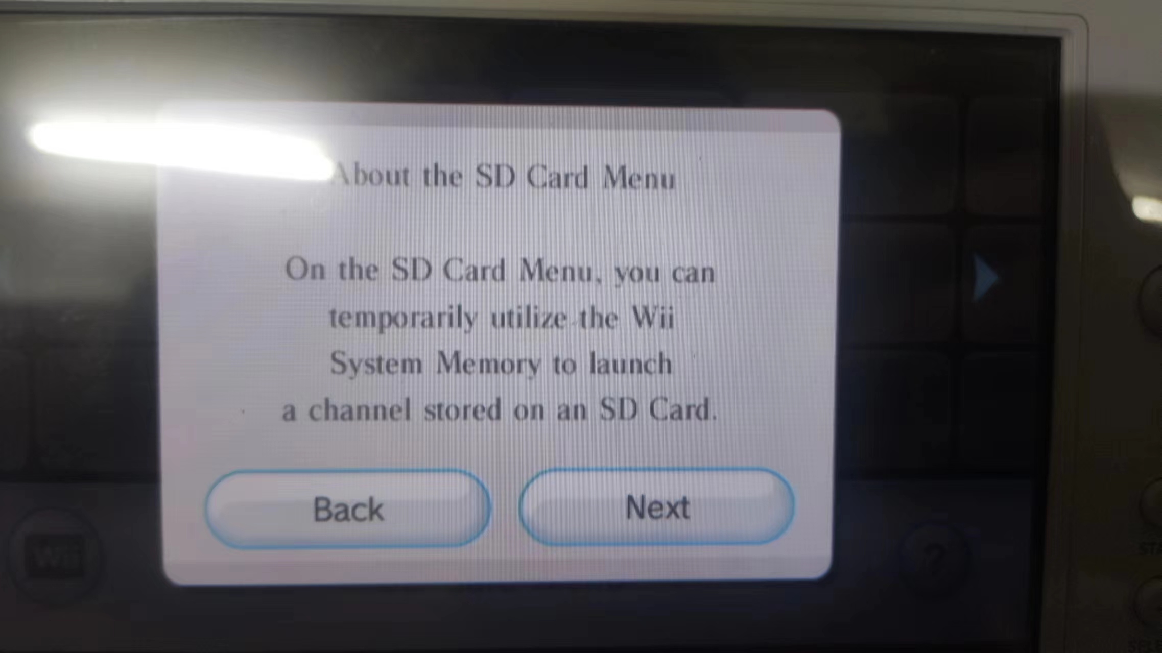

it causes issues with accessing the settings.
I'll test again, you're right. Perhaps there are other unknown issues.
Have you noticed any issues by doing this on your Wii U?
I have regained the 'Wii Options'
After completing SettingEdit ,go to vWii Decaffeinator,Advanced options,set Wii Menu Manual & System menu <yes>.
then update the system.
If you are interested, please backup first.
