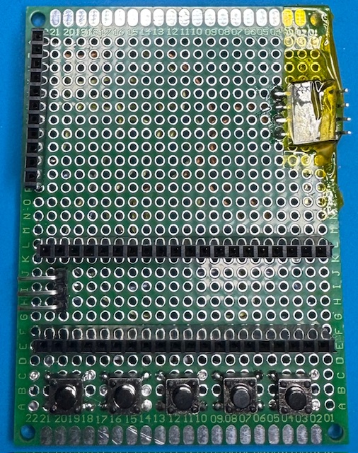

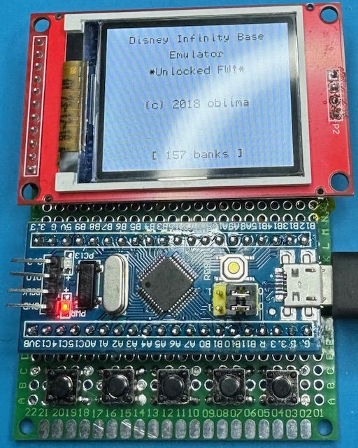

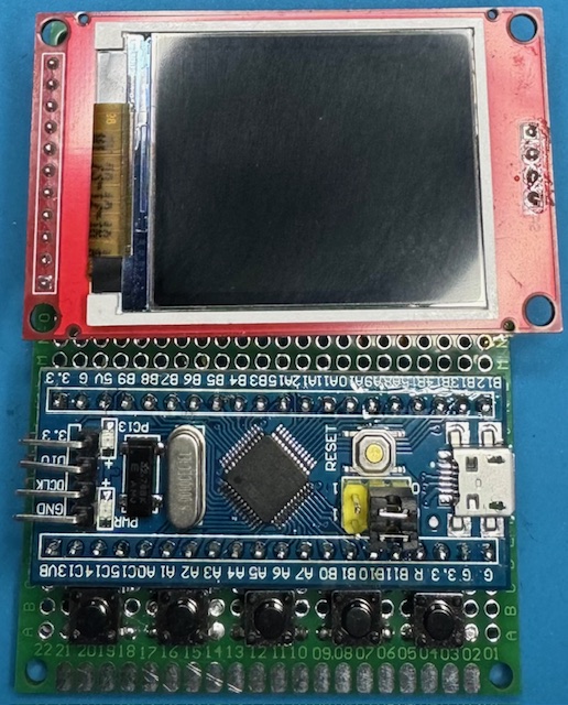

Project D.I.R.E. (Disney Infinity Reverse Engineered) is a portal emulator for Disney Infinity, Lego Dimensions, and Skylanders. This replaces the original portal in place of a custom created one to inject your own character dumps without the need for the original characters, vehicles, or playsets.
This emulator originally started several years ago after a talented coder named obiima did not release his project to the public. Obiima created and demoed a console portal emulator for 3 games: Disney Infinity, Lego Dimensions, and Skylanders. Obiima never released his project into the wild and the project he did release privately was closed firmware meaning locked to the stm32 Bluepill. This project picks up where he left off.
The Firmware allows this device to select between games by holding one of the buttons during boot. Specific Button usage can be found in the User Guide. You have the option of using limited onboard memory or by using an SD card you can increase the character count in your base emulator. By adding your own character files known as bin files, you can inject them into the game without having to keep your original characters.
This emulator currently works on the Wii, Wii U, PS3, and PS4.

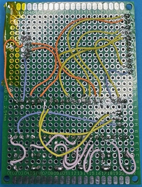

  • D.I.R.E Template A06.pdf
  • D.I.R.E._3D_Case_Files_8-25-21_multiple_sizes_of_Button_Caps.zip
  • D.I.R.E._PCB_2021-03-12.zip
