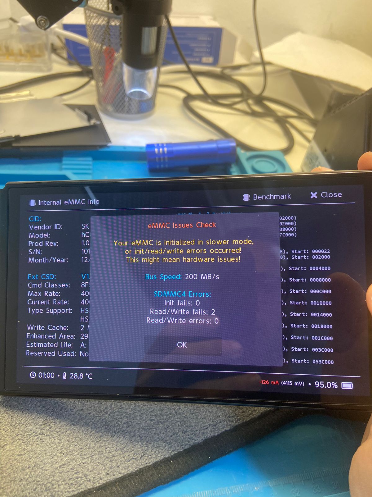

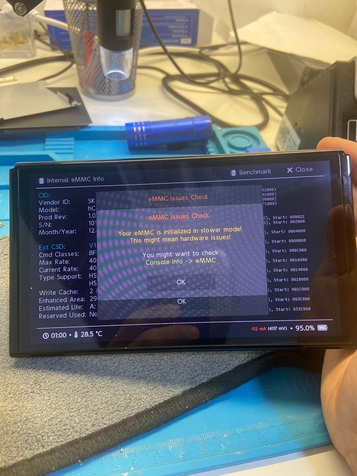

Hello, I bought some OLED unlocking kits but for the first time this happened to me, an error screen appears (EMMC SLOWER MODE).
I know that on the common Picofly RP2040 (development board) we have to add 2 resistors when this happens, but what should I do in these cases when it is a kit? any tips?
Thanks

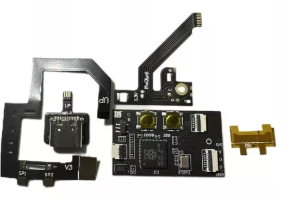

Na dont ask there its a clone won't get help there.
But u answered it yourself , you gotta change the resistors ;)
On the picture main board above the flex connector, there are 3 resistors these should be the ones.
now u need to find the correct resistors use a multimeter and find the resistors u should change.
If u check the picofly Aio thread or read the picofly guide from @lightninjay in my SIG u see what ones u need to change and just use 100ohm on CMD and DAT 0
I usually just use 100ohm on all , I only install Tiny chips

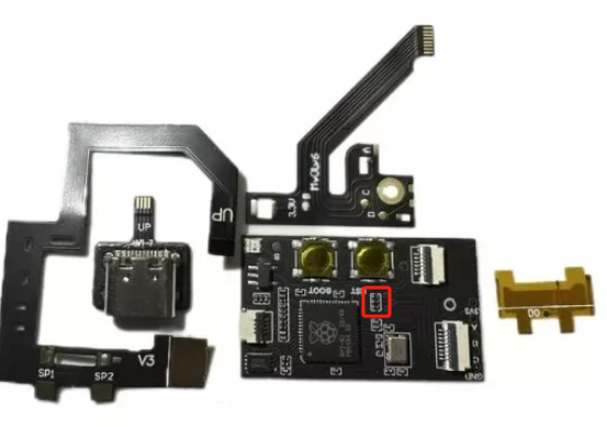

check circled resistor and test which goes dat0, cmd or clk.
Then replace them one by one with 100 ohm to achieve your best result.
