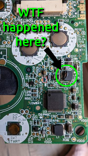

Started probing around some more, and found there's a dead short on R53. Following the short, I kept probing more components and found a short on C32 as well. Removing R53 and testing again show it's definitely defective. C32 is a working component though, and the short only appears when soldered to the board. By my understanding, it's apart of the charging circuit so it would make sense that it's not charging.
Then there's this component that's not clearly marked on the silk screen which is also showing a short to ground:
Ignore the cracked coil. The core is intact and it's still functional, thought I have no easy way to test inductance.
Seems like I'm on a bit of a wild goose chase. Anyone else have a known working AGT/101 board that can help with probing that particular component, and the other mentioned above so I don't go crazy chasing a short that may or may not exist?

Does that L4 check out okay? it looks like it could've broken down with the plastic being cracked.
If I recall Q2 at the bottom of the board there is also a semi-common point of failure for the charging
Hiya @DrunkenMonk, without an LCR meter I've no way of confirming if the inductor is working correctly or not, unfortunately. However there is continuity and no resistance, which points to a good inductor. But, I suppose if the inductance is off, then it will have issues splitting the voltage variances between the 3.3 and 5v circuits. Not sure if this would affect it's ability to charge though.

greenteagrasshopper
Jan 25, 2023
14
24
47
Australia
I dunno what happened here, but replace it. Looks like a lawn mower ran it over. :rofl2:
Haha yeah, that's the L4 inductor we were talking about. I'd love to replace it but I'll have to find the value and the exact size first. It's still showing continuity, but again not sre if it's alright. I'll get around to sorting it eventually. Next month most likely with shipping from China being excruciatingly slow/bad.
