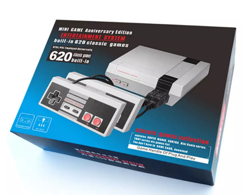

is there a way to add some new games/delete the existing ones from this NES mini Chinese clone?
