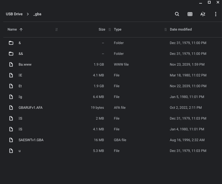

Sorry if the prefixes are wrong or I write this oddly, I'm new here, I just made the account to ask about this in fact. So, there was a GBA game I wanted and as I already had TwilightMenu downloaded and thought I had a fairly good sense of how it worked, I decided to download it. I foolishly placed it in the "_gba" folder, thinking it would be similar to placing a DS ROM in the "roms" folder. Ichecked my SD card again and went into the _gba folder, and now it just shows me this.

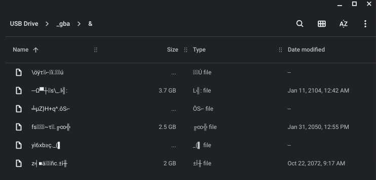

Just a mess of odd garbled files and symbols. Going into the first folder yielded this result, the second didn't have anything in it however.

Even more nonsense! I've clearly done something wrong related to the ROM I tossed in there, does anyone know how I could fix this? And on top of that, does anyone have a good tutorial on how to play GBA games on this thing? Thank you!

Sd card is Corrupted

it doesn't seem like anything else on the sd card is acting strangely, just the _gba folder. everything else looks fine...
plus, it seemed to work fine when i put it back into the 3ds. not sure if that matters.
okk it still seems to be working fine, guess the gba portion of the card is screwed but that just means i cant play the game. oh well.

it could be a fake o damage memory.
copy all files to a folder on you pc.
remove all partitions and create a new one using fat32, then use H2testW to test all the extent of the device. if all is OK, copy back the good files to de memory and start over with the game.
