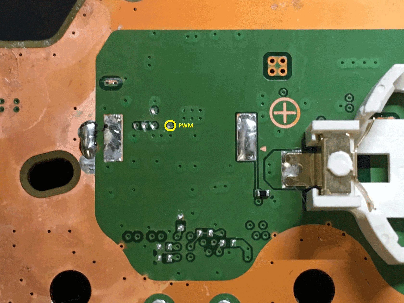

I believe you can use the 12v and ground from the disc drive connector, and theres a PWM square pad on the opposite side of the motherboard. It's on the opposite side that the fan connectors are on. So flip over the board.
I can try, but the terminal for the pwm doesn't have a way to trace on the motherboard. I can turn the console on and start testing for the voltage, but the voltage fluctuates due to temp changes so it would be fun trying to locate. That is my next step, but I was hoping someone already found the source of that signal
You should be able to use the 12v and ground from the disc drive connector, and there's a PWM square pad on the opposite side of the motherboard. So run a wire from back side of motherboard to the fan connector, run junker wire from 12v from disc drive connector, and run jumper wire from ground of disc drive connector.

Here is the pwm point on back side. You have to rout the jumper wire around
