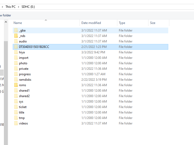

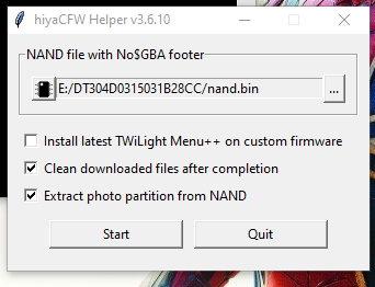

I think i got a really old version of HiyaCFW, I ra-ran Hiya Helper V3.6.10, it says browse for NAND File with No&GBA Golder
What folder do I browse to? Here is what my root of my SD Card looks like. I just updated Twilight++ and I got unluanch 2.0 still
Then once that is done, how do I update it? And how do I confirm I got newest HiyaCFW? And is Unlaunch 2.0 the newest still?
When using hiyaCFW Helper, open the NAND .bin file. Whether it has the NO$GBA footer depends on what you last used to backup your NAND.
When it tells you to select a folder, select the SD of which you use hiyaCFW on.
Also, to confirm the version you're using, hold the SELECT button when turning on the console. And yes, Unlaunch 2.0 is still the latest.

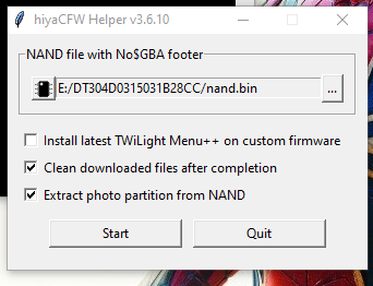

I open the NAND.bin file from my sd card?
So i launch the app on the computer, and browse to the root of SD? Or NAND.bin file on my sd card?
And the original backup of my NAND (before modding) is on saved on an external location, not my sd card. So on hiya fw helper. I choose that? I’m kind of confused. Sorry
haddad
Aug 12, 2010
1,740
928
Wherever you placed it should work.
Browse to the SD root.
when I browse for the NAND.bin (first step), do I browse to the current on on my SD Card? Or the backup NAND I Made before modding a couple years ago (in my external location?
And this will update hiyaCFW? How will I know i got the new version?
The current one should work fine.
Yes, it will update hiyaCFW. To know that you got it, I already told you earlier on how to check it.

So I browsed to the .NAND BAckup I made, then browse to root of SD Card, and now I am stuck here? What do I do?
haddad
Aug 12, 2010
1,740
928

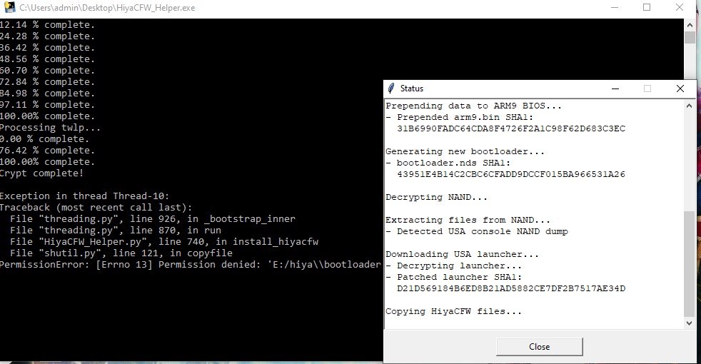

Ensure the SD write-lock switch isn't set. If it still gets stuck, please post a photo of the console window behind the "Status" window.

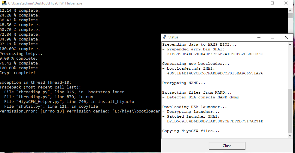

SD Write lock is not set, here is log behind status window:
Opening HiyaCFW Helper...
Initializing GUI...
Searching for 7-Zip in the Windows registry...
Searching for 7-Zip in the 32-bit Windows registry...
TWLTool v1.6.1
by WulfyStylez
Special thanks to CaitSith2
reading consoleid/CID from nocashinfo block
Processing twln...
0.00 % complete.
12.14 % complete.
24.28 % complete.
36.42 % complete.
48.56 % complete.
60.70 % complete.
72.84 % complete.
84.98 % complete.
97.11 % complete.
100.00% complete.
Processing twlp...
0.00 % complete.
76.42 % complete.
100.00% complete.
Crypt complete!
Exception in thread Thread-6:
Traceback (most recent call last):
File "threading.py", line 926, in _bootstrap_inner
File "threading.py", line 870, in run
File "HiyaCFW_Helper.py", line 740, in install_hiyacfw
File "shutil.py", line 121, in copyfile
PermissionError: [Errno 13] Permission denied: 'E:/hiya\\bootloader.nds'
Initializing GUI...
TWLTool v1.6.1
by WulfyStylez
Processing twln...
0.00 % complete.
12.14 % complete.
24.28 % complete.
36.42 % complete.
48.56 % complete.
60.70 % complete.
72.84 % complete.
84.98 % complete.
97.11 % complete.
100.00% complete.
Processing twlp...
0.00 % complete.
76.42 % complete.
100.00% complete.
Crypt complete!
Delete the "hiya" folder, and then try again.

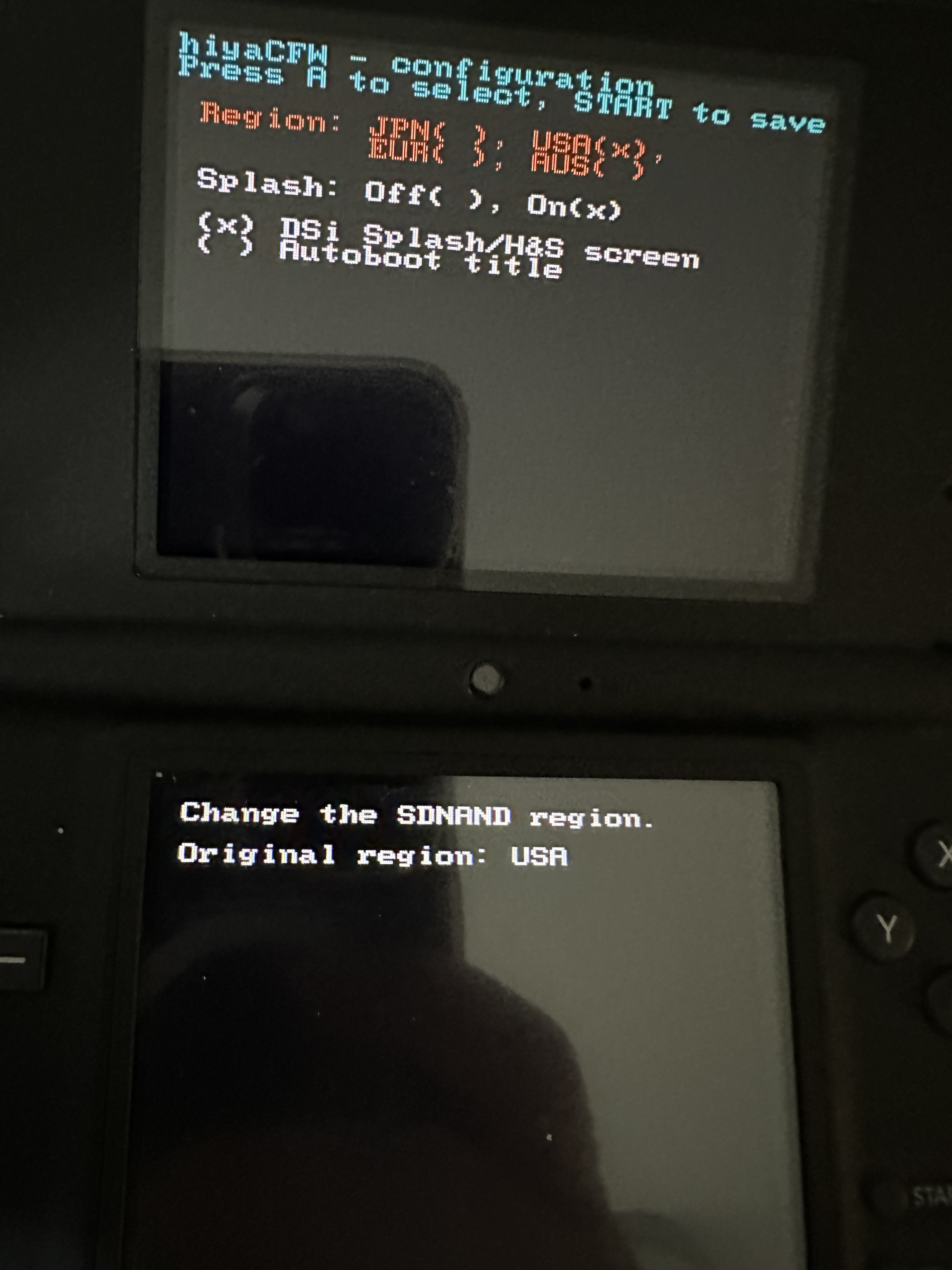

I'd say "Like I said, the top of the top screen", but unfortunately, there's a bug which prevents it from showing.
With the addition of the region setting, you are indeed using the latest.
Thanks! Sorry for all the newb questions lol...
