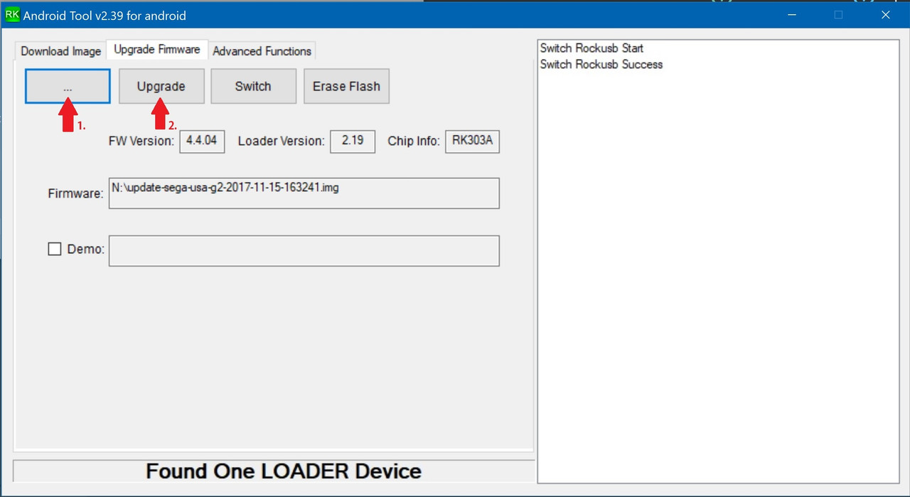

Same backup and recovery tool but the process is a little different.
Connect to the console with the tool and then click on the Upgrade Firmware tab.
1. Load the img
2. Upgrade the Flashback 2017 HD firmware. https://i.postimg.cc/FFYWkDf4/Update4.jpg

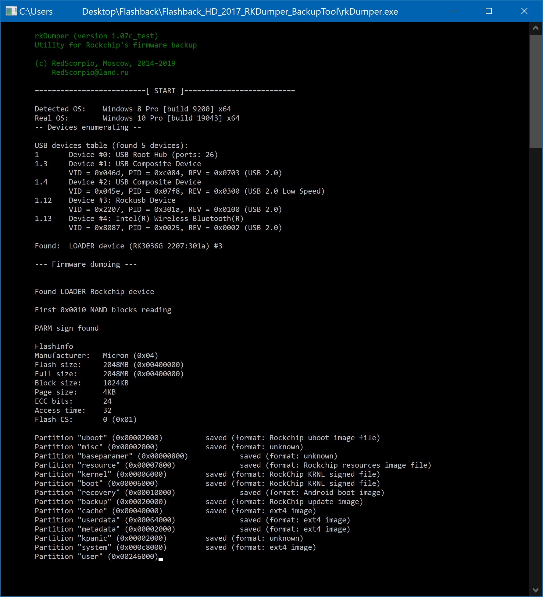

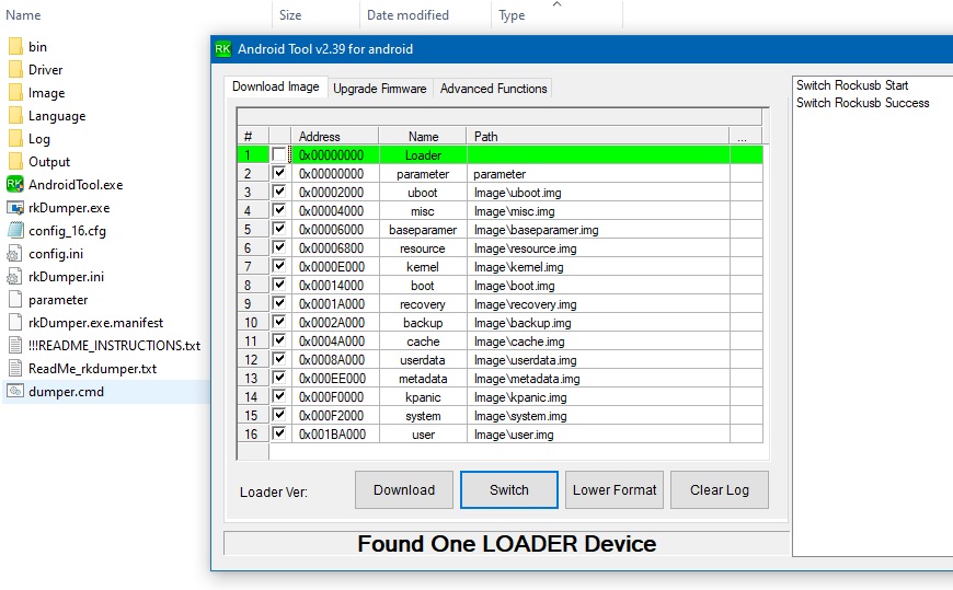

Put the console into Loader Mode and run the dumper.cmd (Might have to rt.click and RunAs Administrator)
Backup will be stored in the "Output" directory.
The unchecked Loader highlighted in green is not needed. https://postimg.cc/0K0nLtbP
Make sure there are no spaces in the directory paths or the dumper won't run.
This is an example of the output: https://postimg.cc/Cz1ZnvwH
The example above shows a 2GB console: Partition "user" (0x00246000)
The easiest way to determine if you have a 2GB or 4GB console is to back it up first and then read the dumper output.

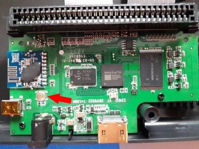

The built in Firmware Reset button.
And Thank you! @astuermer
You've pointed out one of the most over looked features of the 2017 ATGames Sega Genesis console.
The built-in firmware reset button.
Press and hold to reset the firmware or put the system into Loader mode.
Its hard to brick the rock.
