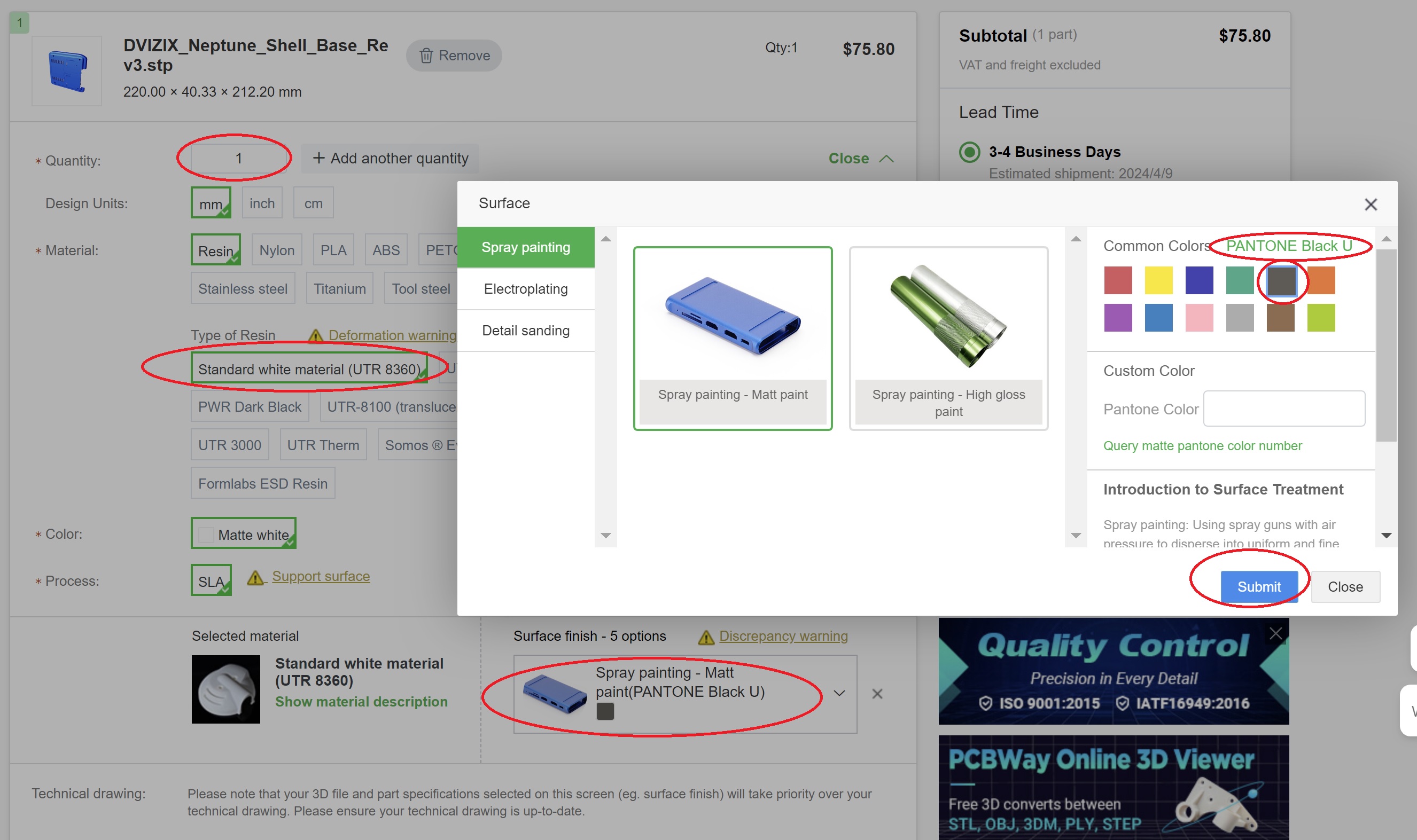

Also, the cost of using PCBWay to manufacture the case is insanely expensive.
Plus, there isnt a guide on how to configure the order for specific parts for the case either.

It all aspects PCBWay is the cheaper option when compared to Shapeways.
About Ordering from PCBWay
I think you'll have to spray paint the buttons gloss black on your own.
PWR black and UTR black can be used for internal parts to reduce cost. But do not use for the main shell.
Order main shell painted Pantone Black using Resin Standard white material UTR 8360.

In regards to PCBWay, do you press "submit request" for each part to add to the order?

PWR black and UTR black are cheaper types of resin.
There are two internal parts for the switches that can be made using the cheaper plastic, shave some pennies.
Macho did a great job. Deciding what to order thru PCBWay, was and is still confusing.
Yes. PCBWay is a pain like this.
We wanted a one click option but PCBWay doesnt work like that so DVIZIX went out of his way to make the ordering page as easy as possible.
Hexa Chrome Black U for the shell in matt are good for the top, bottom and ext. cover.
and Hexa Chrome Black U with gloss... Perfect. I totally forgot that parts can be ordered painted in gloss black.
Maybe shave some pennies on the two internal switch parts that dont need paint or presentation.
If its all ordered at the same time then they will package it all in one box.

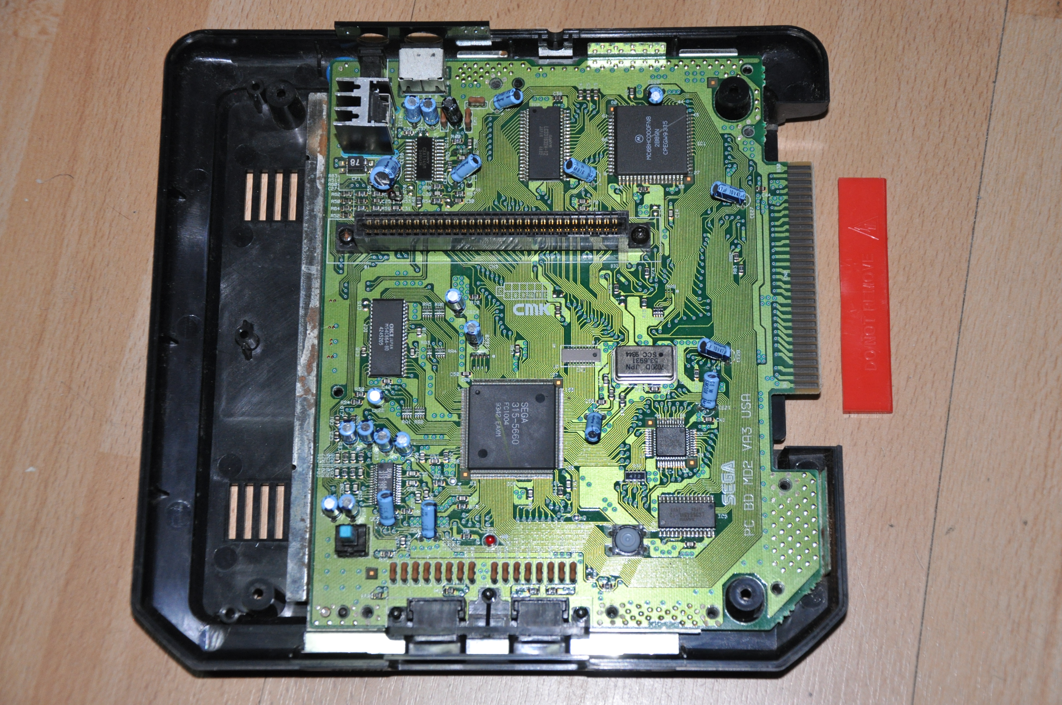

So its easy to find a VA3.
Look for the short board by finding pictures of the back the device and looking thru the plastic grill.
The chrome plated ESD shield is clearly visable.
If it takes up the entire view of the grill then its a VA1 or variation.
If it does not and there is empty case to be seen then its a VA3

My Longhorn is mostly my modular design changes with the wires, esd shields and cartridge flap mod.
So while the Longhorn does make room for the cartridge flaps, the absolute carnage it takes to get there is easily over looked.
In terms of destruction and difficulty thats why I make it a point to state just how different the Modular design is.
Primary differences.
1. The long wires required. There is a great method for this by the PunkNDisorderlyGamer on the YouTubes.
2. Homemade Aluminum ESD shields, At least two are Required and if these dont work the project could be doomed.
3. Shaving down the 32x catridge port. Irreversible and while replacements are easy enough the original part cannot be replaced
4. Cutting the cartridge flap chassis to fit. Again Irreversible, destroys the better made original and while replacements are possible with DVIZIX parts, these are printed, expensive and not nearly as good as the original part.
So you can see here, the airgaps and differences between MD2 VA1 and VA3 and VA4 models.
You'll be able to see this difference when then console is flipped over.
https://segaretro.org/Sega_Mega_Drive/Hardware_revisions

You could buy a printed low profile flap chassis from PCBWay, created just for that purpose.
Its the one thing I worked directly with DVIZIX to get made. I dont like destroying vintage parts. (even while driving)
