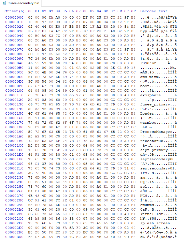

fusee_primary.bin needs exefs_patches and kip_patches.
fusee_secondary.bin needs exefs_patches and patches.ini.
I already did some comparisons alongside what the user at the other thread said, and so far it has been narrowed to 29CA1C792CF3AB63 and 987521753F9B8CE9.
The first one is not in IPS format in this pack, while the other seems to have 4 more bytes patched in from the fusee-primary pack.
So we might need to implement the recent/updated changes from those two into the fss0 pack ith patches.ini
Is someone creating patches.ini from scratch? It should be easy to convert working kip_patches to the patches.ini format.

So, how it works is that fusee-secondary has a header that contains information on where the various kips, exosphere, sc7fw/lp0fw, etc are stored in the binary.
This header is specifically intended to allow other bootloaders (ex. Hekate) to pull the kips and all that stuff out of the fusee-secondary binary and boot with them (previously you'd have to manually extract them or compile Atmosphere yourself, throw them on your SD card, and create a config pointing to the individual kips, secmon, etc).
The header had specifically been added by Scires for that purpose.

Yes i understand that, scires added support for atmosphere to be booted via other methods. However supporting the ability for devs to develop fss0 is not the same as scires himself making fss0 and its definitely not the same as fss0 being part of atmosphere. I even double checked with pika on this because i was second guessing myself.
fss0 is part a of Atmosphere, and can be used by other developers to more easily boot Atmosphere with other bootloaders. Open fusee secondary in a hex editor and you'll see it right there at the start of the file.
