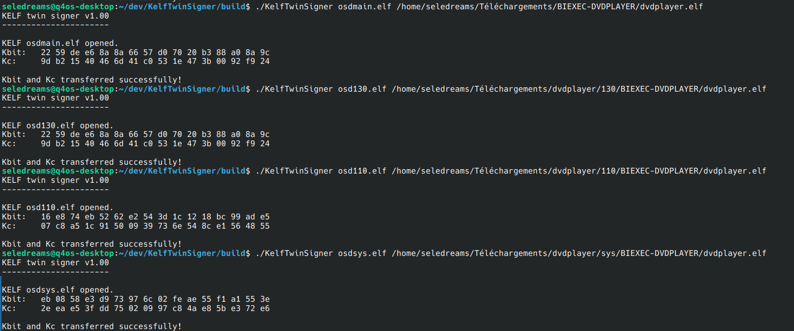

  9. Download and extract KelfTwinSigner, made by SP193, on a system capable of running x86 Windows software.
  10. Fire up a command line and run KelfTwinSigner, with the path to your osdmain.elf as first argument, and the path to B?EXEC-DVDPLAYER/dvdplayer.elf (inside the folder we extracted earlier) as the second one.
  11. The program should display the keys, then "Kbit and Kc transferred successfully!".
  12. Copy the B?EXEC-DVDPLAYER folder, with all its contents, to the memory card.
  13. If you go back to the Version screen with the memory card inserted, the DVD Player version should show as "3.11J (RPC-1)". This proves the files have been detected by the console.
