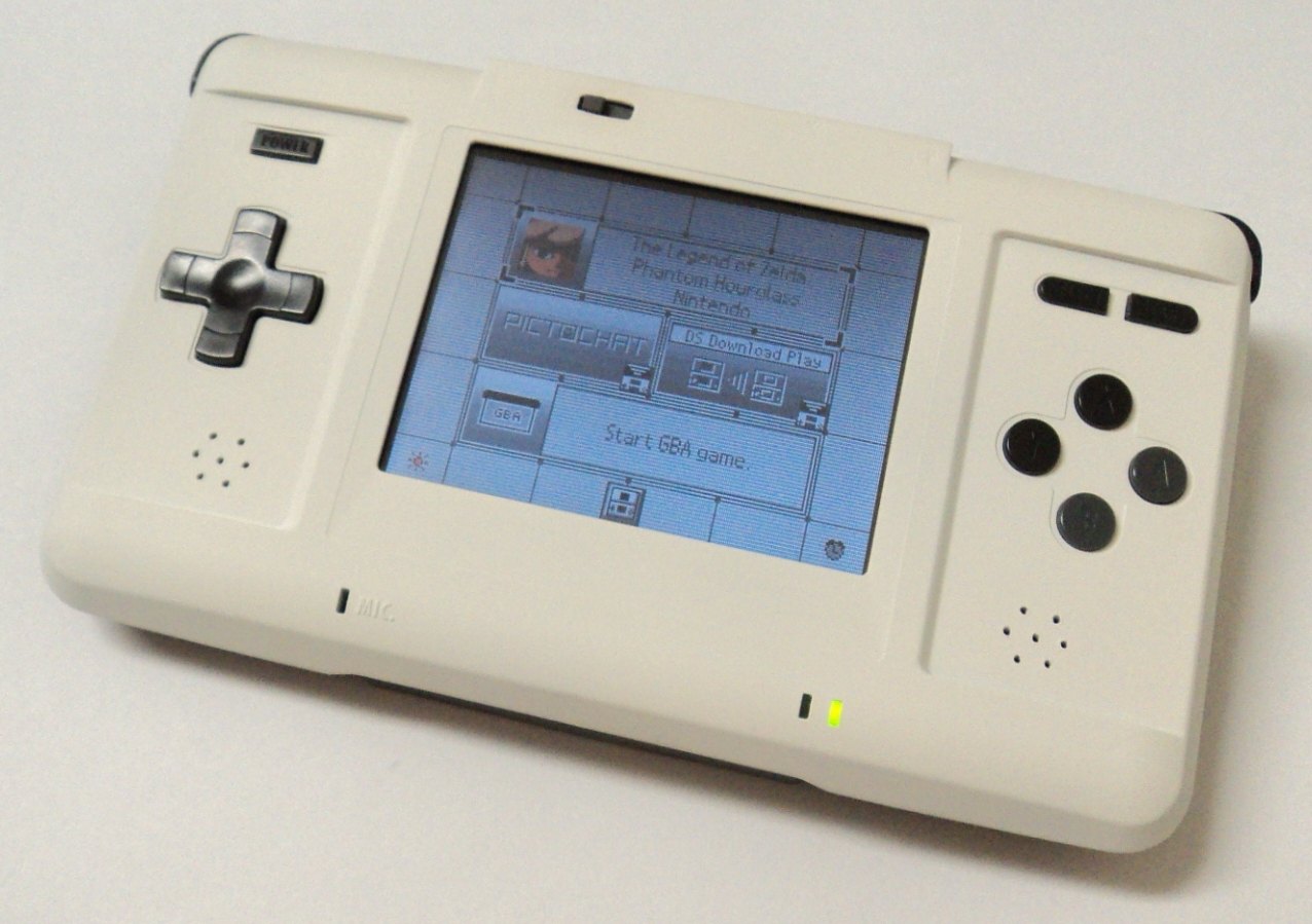

View attachment 99346 View attachment 99347
gimme

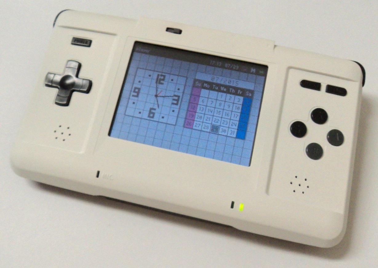

A couple years ago a guy modded the bottom half of a broken DS lite to make a custom GBA, and it is a sexy beast.
I want this desperately. Do you have this guy's contact info?
