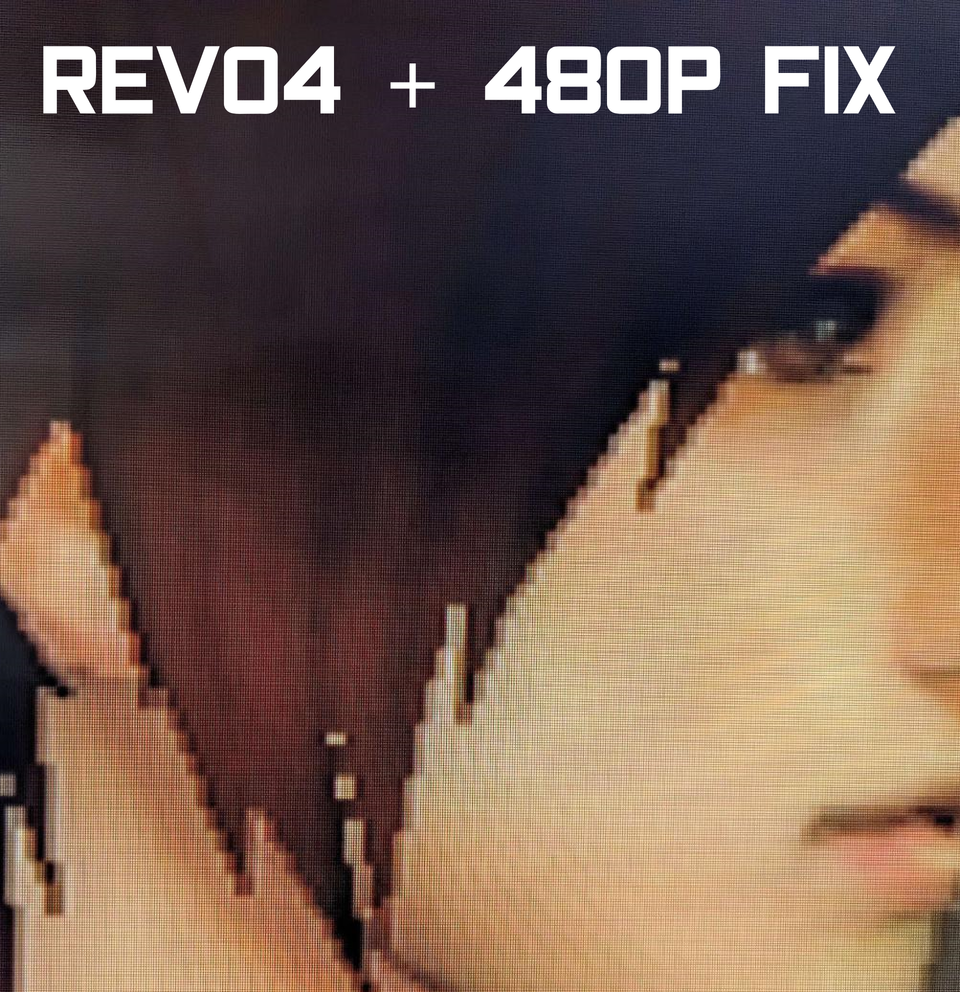

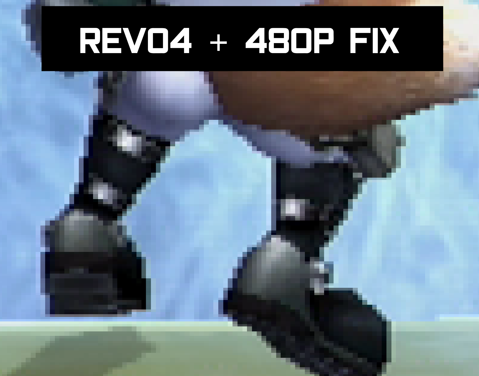

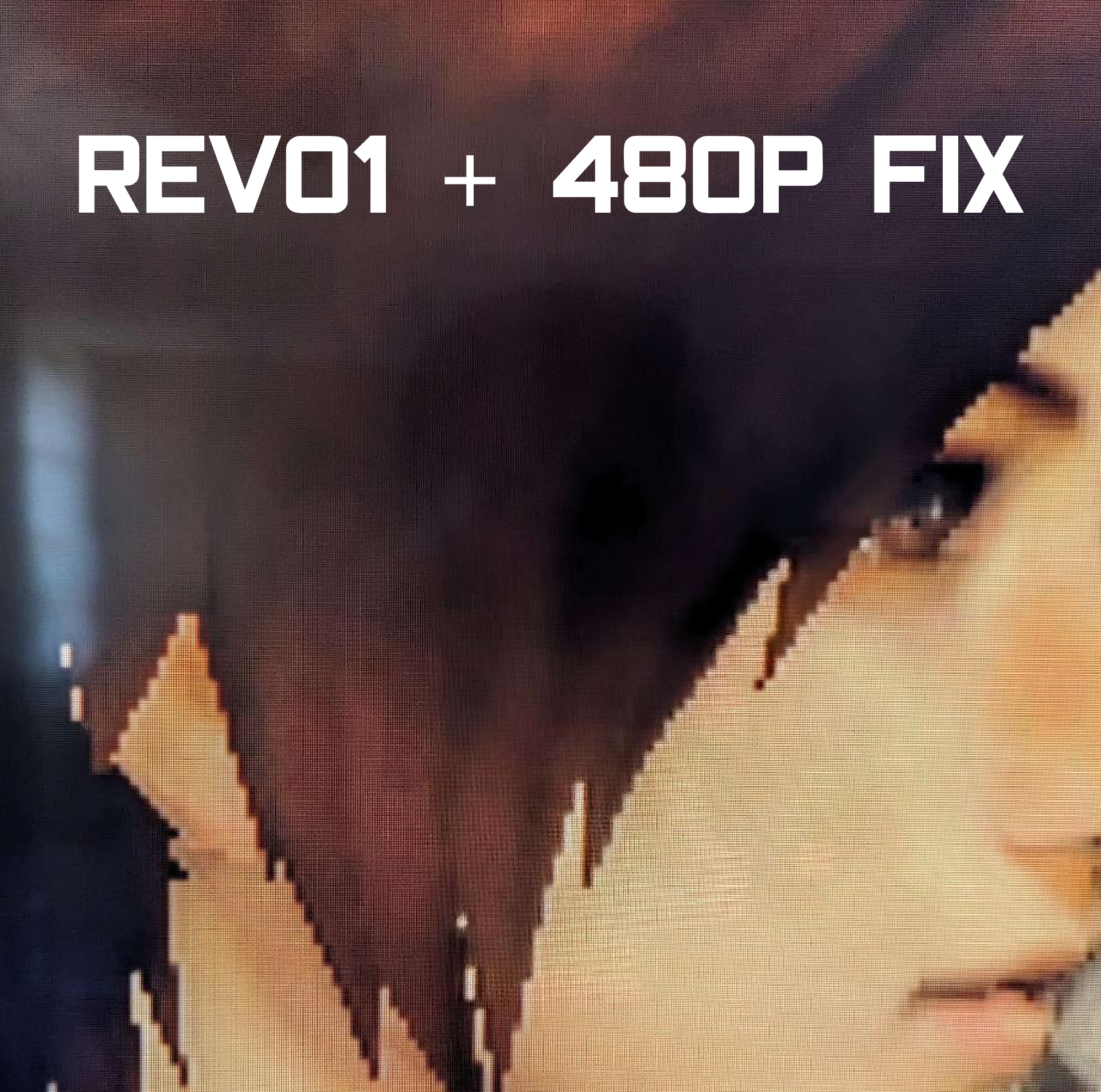

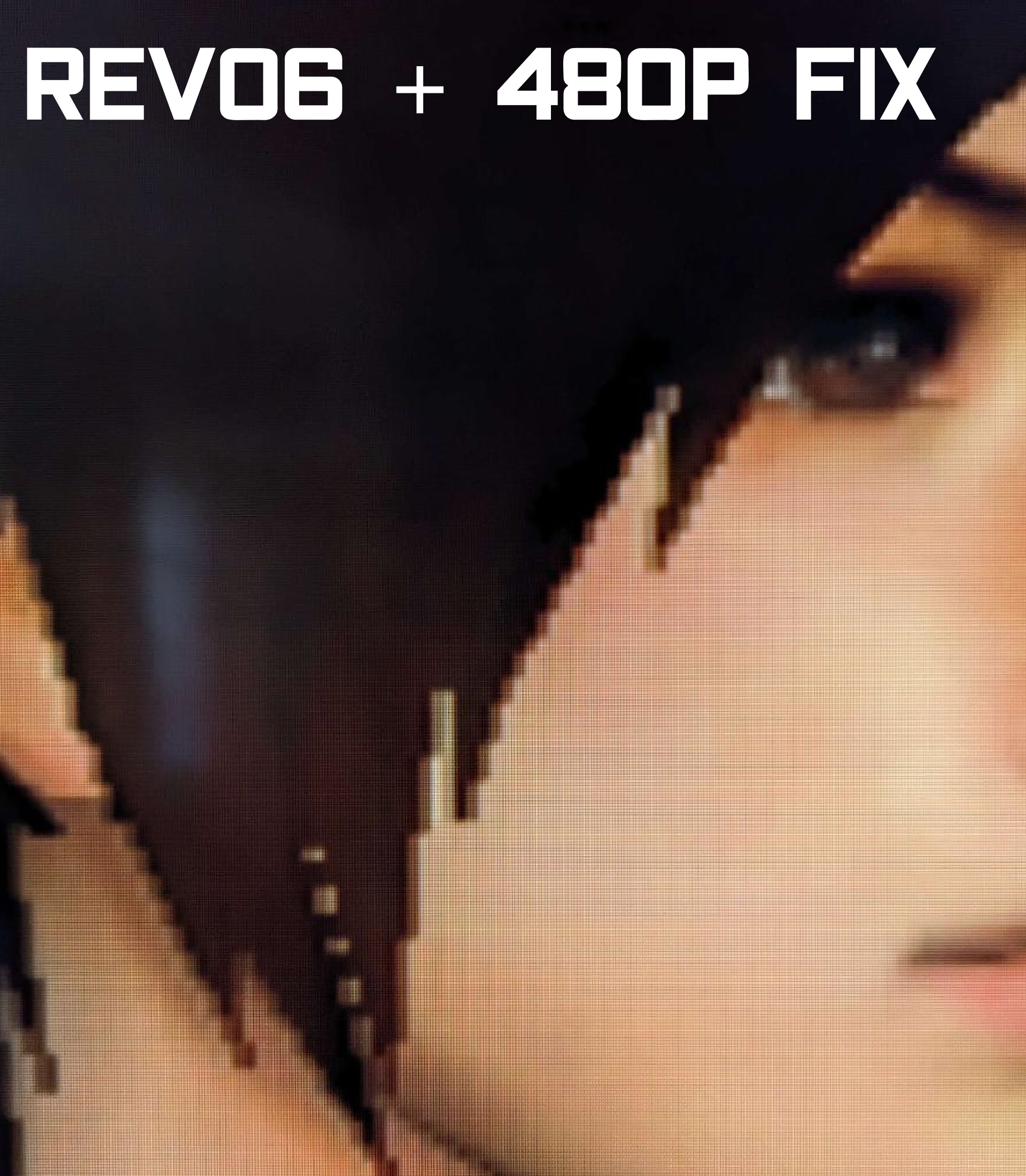

Looks like the bug is also present in later models (all?) and the 480p fix has zero affect with these models.
It took me a while to realize that this is the same 480p bug as with rev01 because the common knowledge was "Nintendo has fixed it after rev01" Thanks to the user "kimbapslice" for testing with rev04 and rev06 NTSC consoles and confirming the same blurry output as with my rev04 PAL console.

Maybe it's just me, but the rev04 and rev06 shots seem zoomed in and stretched, I don't know if a comparison between those and the first is fair.
Are all the shots made with the same settings? The deflicker looks turned off on the first, but for the others it feels like it is not.
With that said it'd be worth testing more, sure. The input from experienced people like Extrems would be wonderful too.

They are not stretched. The first images are offscreen photos. The last one is done by me. I have tested several games (and 240p testsuite) using retrotink5x with optimlal timings (all same settings), 480p fix enabled, framebuffer resolution enabled, 4:3 and I couldn't understand why all the interpolation is visible despite the assumption Rev04 shouldn't have that bug. Same goes for the user who was able to confirm the test results.
I guess I am not experienced enough to trust my test results?! ;-D
This is how rev01 without 480p fix applied looks like.
More info: https://shmups.system11.org/viewtopic.php?f=6&t=70398

I wasn't saying you did not know what you're talking about, I remember you did a video with OSSC settings a couple of years ago so I know you have experience.
It's just that the proportions seem wider on the other shots. The interpolation is visible of course. I have a rev06 wii and never saw a difference with the 480p fix on or off, but it was always said that it wasn't for my model so...
If it indeed is still there on the other revs I hope it can be fixed too. I remember reading the shmups forums for years trying to follow on this.
Looking at the 240p testsuit little snatcher guy on my wii looks cleaner than that, for whatever that's worth, but that's hardly technical.
