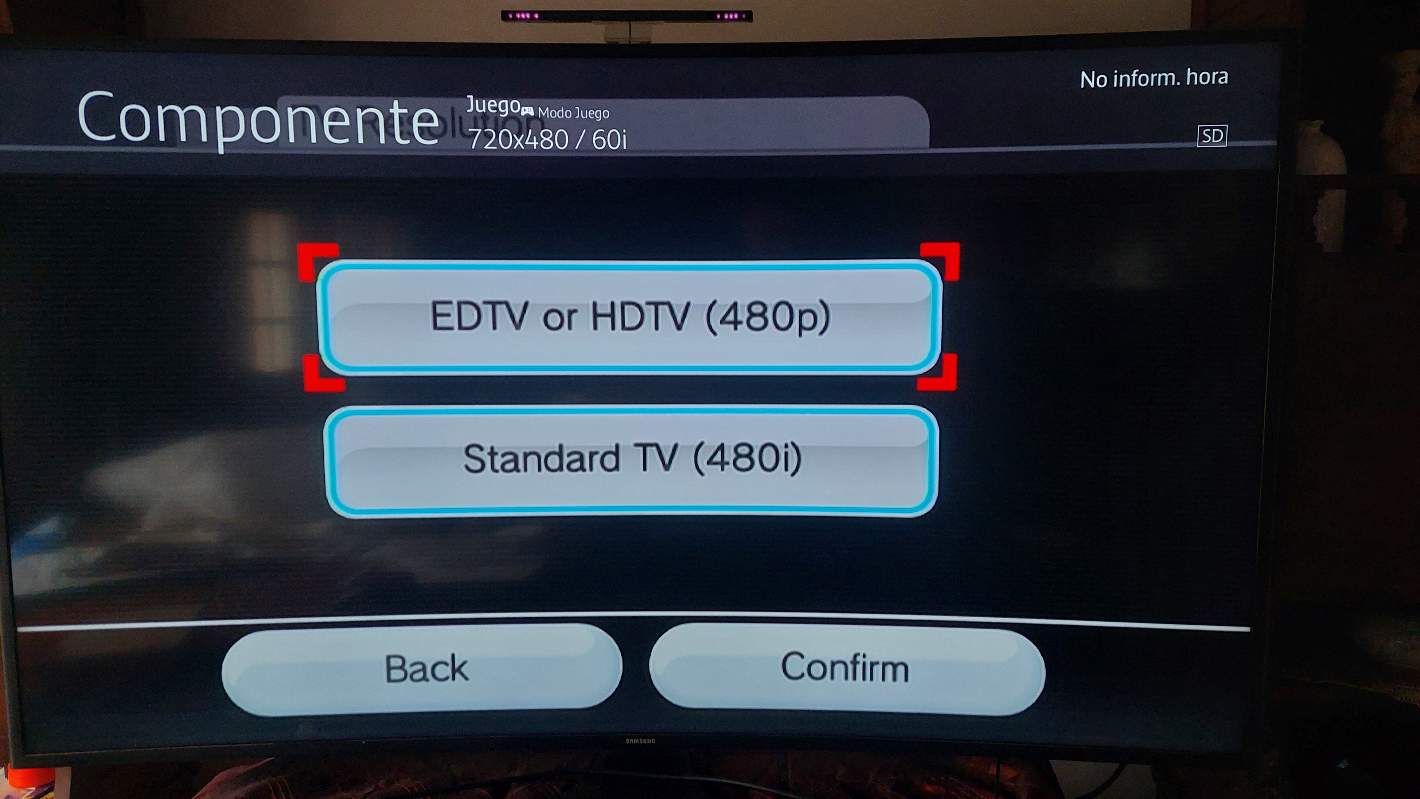

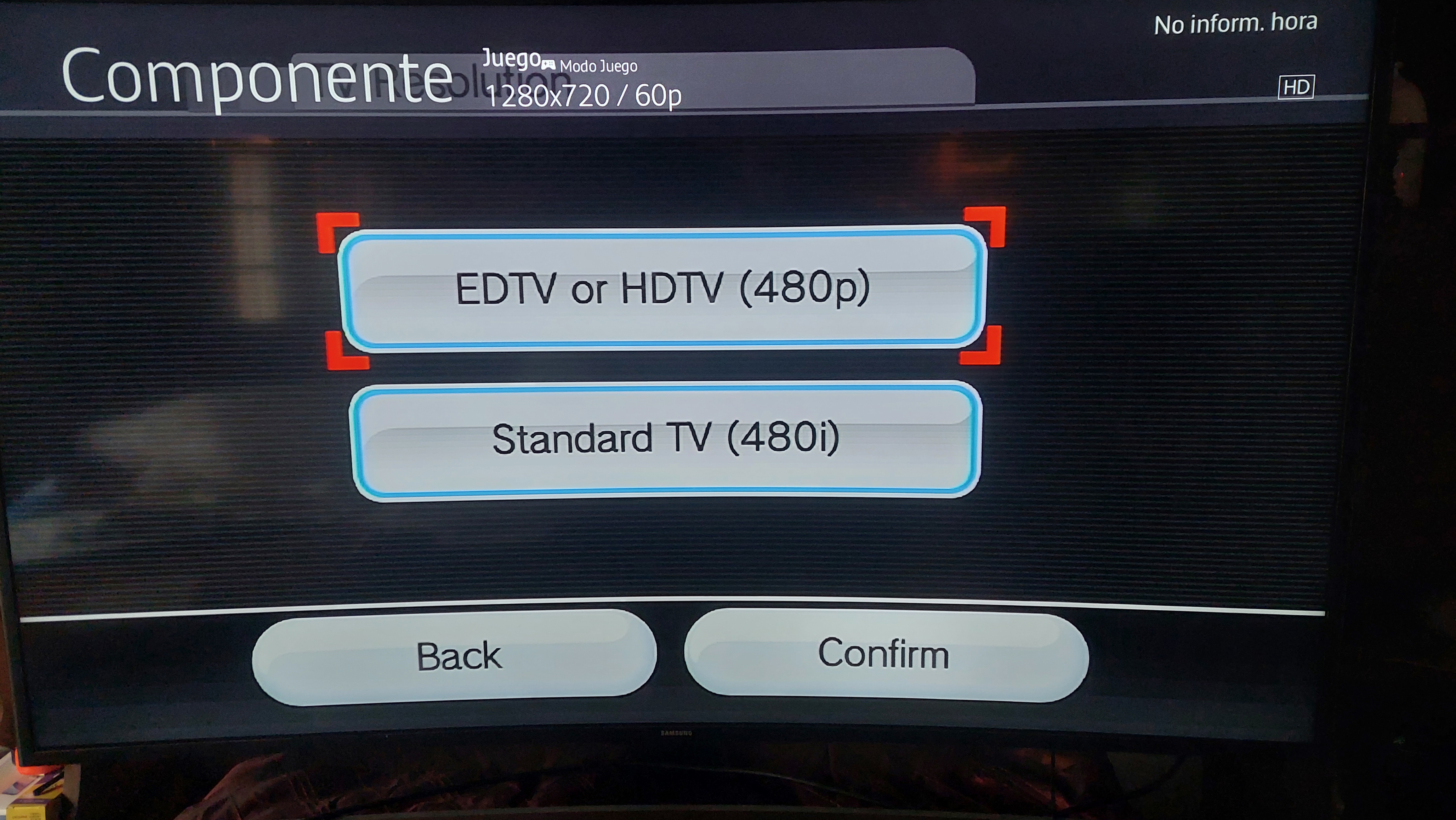

Well another big thing here though is that you changed a setting on the Wii U menu. The settings there are completely separate from the vWii. It is an entirely different OS with it's own filesystem and everything. There is barely any connection between the two past controllers.

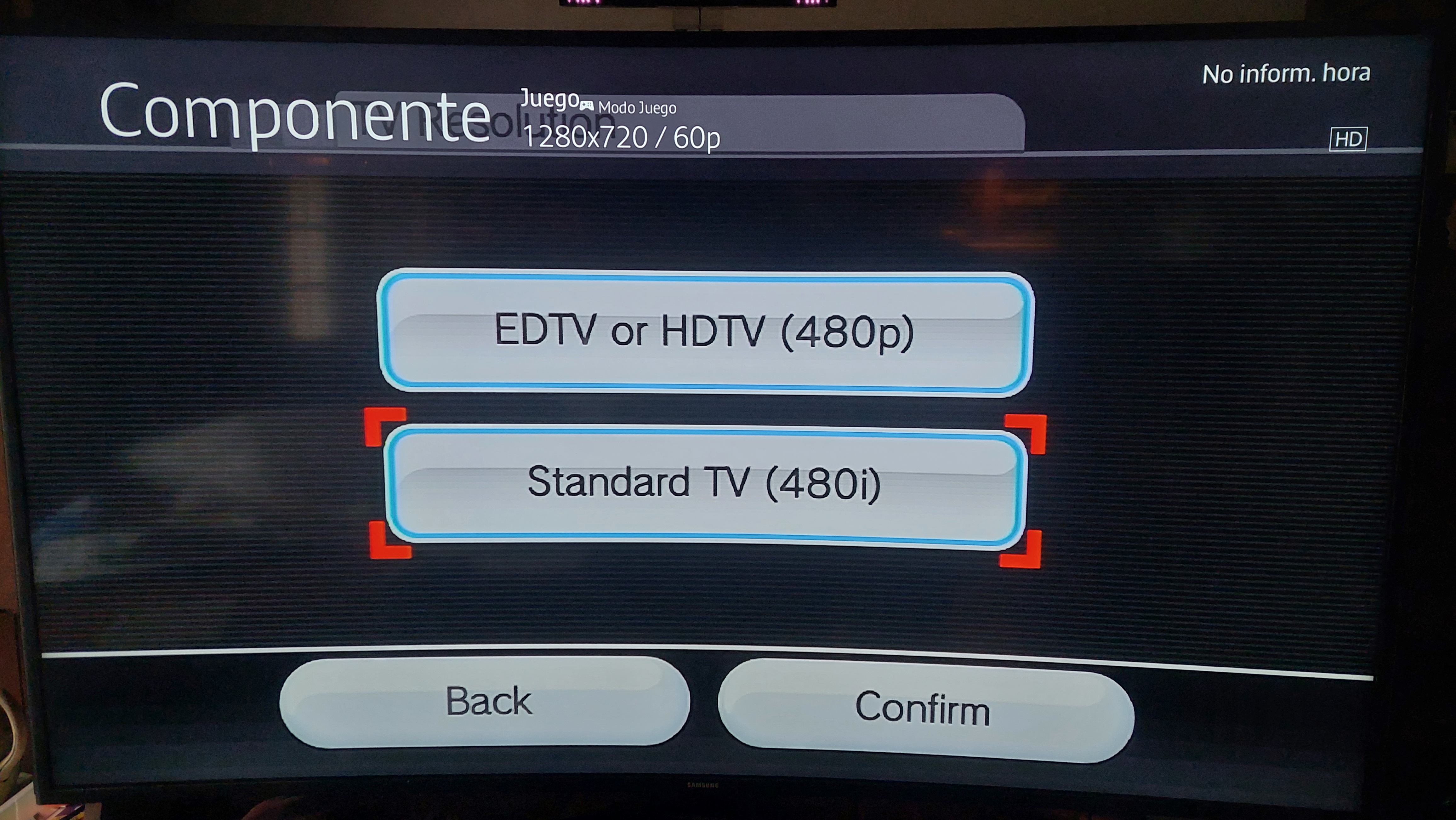

What do you mean “changed a setting”?
The only thing I changed was setting the resolution to 720p.
The results are the same regardless if you set it to 480p.
I was pointing out that the resolution changing when booting into vWii is normal. That is how it was intended to function.

To my knowledge only PAL Wii U consoles were affected.
I can confirm that my unit is capable of displaying progressive over component.
Yeah, seems it's a bug with PAL units. It's weird that region changing it doesn't fix it... I'm having a hard time seeing this as a hardware issue, aside EEPROM saying your Wii U is PAL or NTSC, and maybe some SLC setting? Hardware should be the same across regions I believe.
Also, it's possible that your unit is rendering progressive internally, but outputting interlaced content.
For example, I'm setting here for interlaced video while my Wii U is still doing 720p, it doesn't go into 720i. But I know it's interlaced because my resolution gets cutted, stuff pixelates a bit when DMCU has to deinterlace.
You can try priiloader and access the vWii settings, it will not change DMCU so it will still display whatever you already got, but you can control at least how it behaves internally.
Edit:
Funnily enough, if I set the console to 480i... vWii always render at 480p, same if I set 1080i...
Edit:
Yeah so the question is, if the Wii U side is doing the resolution switching, then the issue should be on the Wii U software, and not within vWii. The question is if it would be fixed when switching the Wii U region to NTSC? In theory I can't see why it would fix it. After all changing the region within vWii to NTSC didn't solve the issue. I was pretty sure that it would fix it but it didn't. Hence my theory that the issue must be on the Wii U side.
I haven't seen anyone change their Wii U region from PAL to NTSC. If anyone have done that I'm curious to see if it also affects this issue.
Assuming your vWii works like mine's, then you should be getting progressive over component, it's just that the DMCU is wrongly configured and for some reason it switchs to interlaced.
Region changing the Wii U may help in the sense that maybe the Wii U side will behave like American units, and will stop doing the switch. But I don't fully know the internal working of the Wii U, so you can only try. I read on WiiUBrew that OSv0 (the OS that enables Wii Mode) checks something on the EEPROM? I know that region is also stored there, so there is a chance that even region changing will not fix it, but I could be wrong
But you are running a NTSC Wii U right?
It was mentioned back in 2012 that it only affected PAL consoles. https://www.eurogamer.net/digitalfoundry-wii-u-backwards-compatibility-analysis
