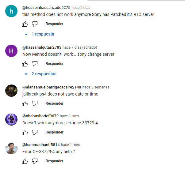

On youtube, they say that this method was patched by sony
see comments
link:

conforming the info, out there, the trick is not longer working because sony did changes on Dev network. The big problem is again here because, consoles with 1.76 5.05 and 6.72 will reach that moment when the battery will reach the end of life...
I know that goldhen is bypassing the problem, but i wanted to know what happen with the original discs... i have read they wonk work at all... what a problem :(
