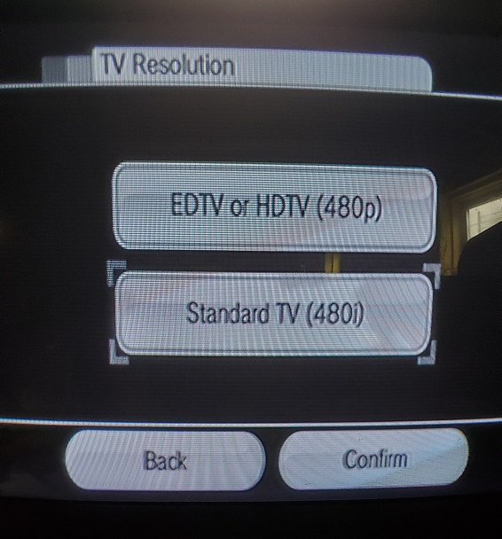

Use the old TV, navigate to System Settings and change the TV output mode, see if you can get it to be in color, then try the HDMI adapter again with the new setting.
Is this what you mean? I tried both of them and then hooked it back to HDMI with no luck. Just flashes the Wii menu for a second and then no signal.

Is this what you mean? I tried both of them and then hooked it back to HDMI with no luck. Just flashes the Wii menu for a second and then no signal. View attachment 327243
I forgot that those options existed.
I think what's happening then is that your newer TV's doesn't support such alow resolution like 480p.
There's no way to "fix it", other than using older displays such as old Plasma/LCD panels.
But to be honest, you can't go wrong with CRT's, so that's very good in my opinion.
