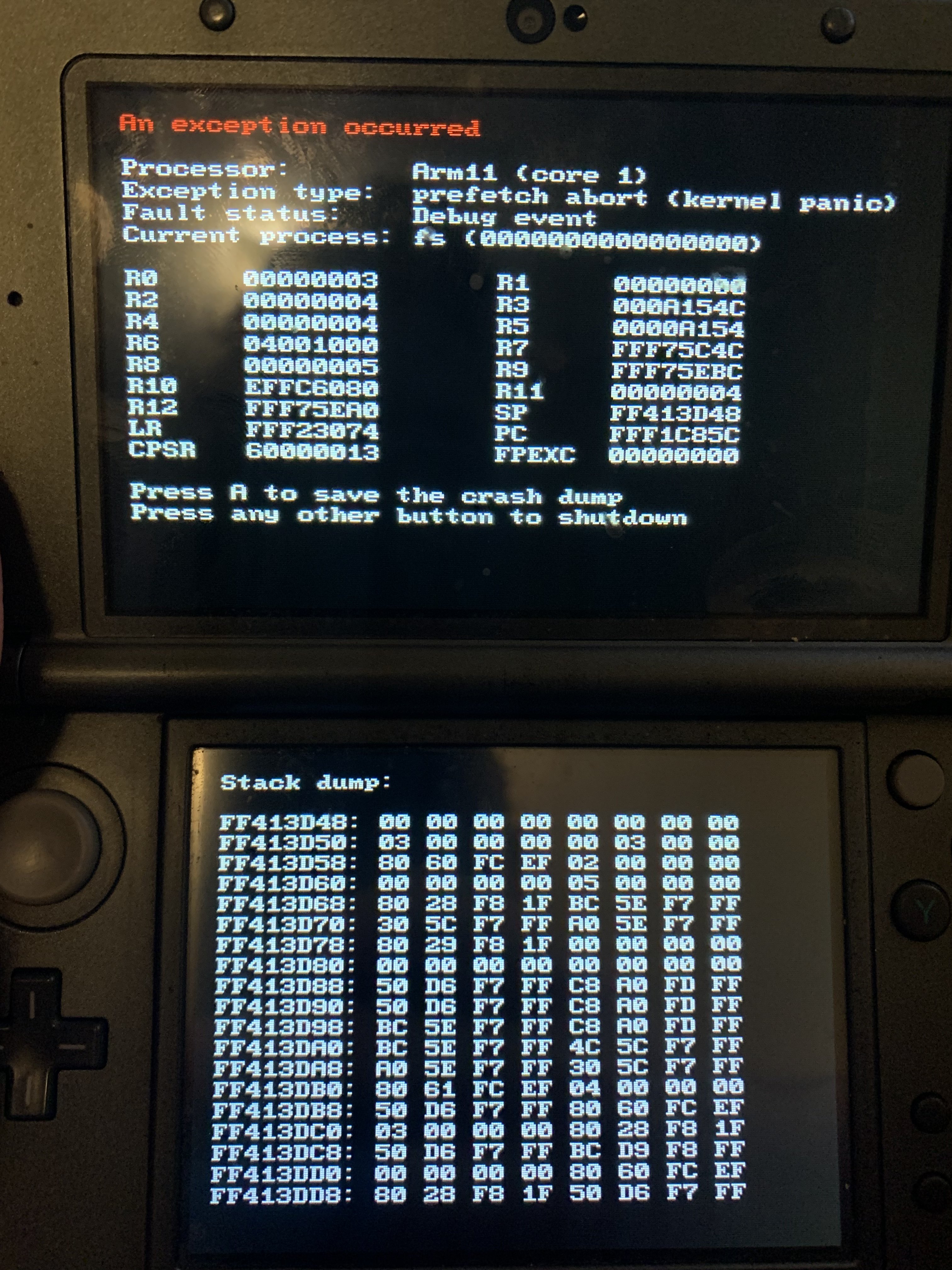

So I was using it normlly and nothing was happening but when I was installing a 3ds game using a fbi rq code it randomly crashed my 3ds and didn’t turn on again which resulted in this when I go to godmode
Can I fix this or is this gg?

The Arm11 error appeared in GodMode9?
Anyway, i suggest checking the sd card for errors with h2testw. Do so with the read & verify option.
You'd need to back up your data beforehand.
Format the sd card as Fat32 32kb cluster size before and after the test.
Post the results here.

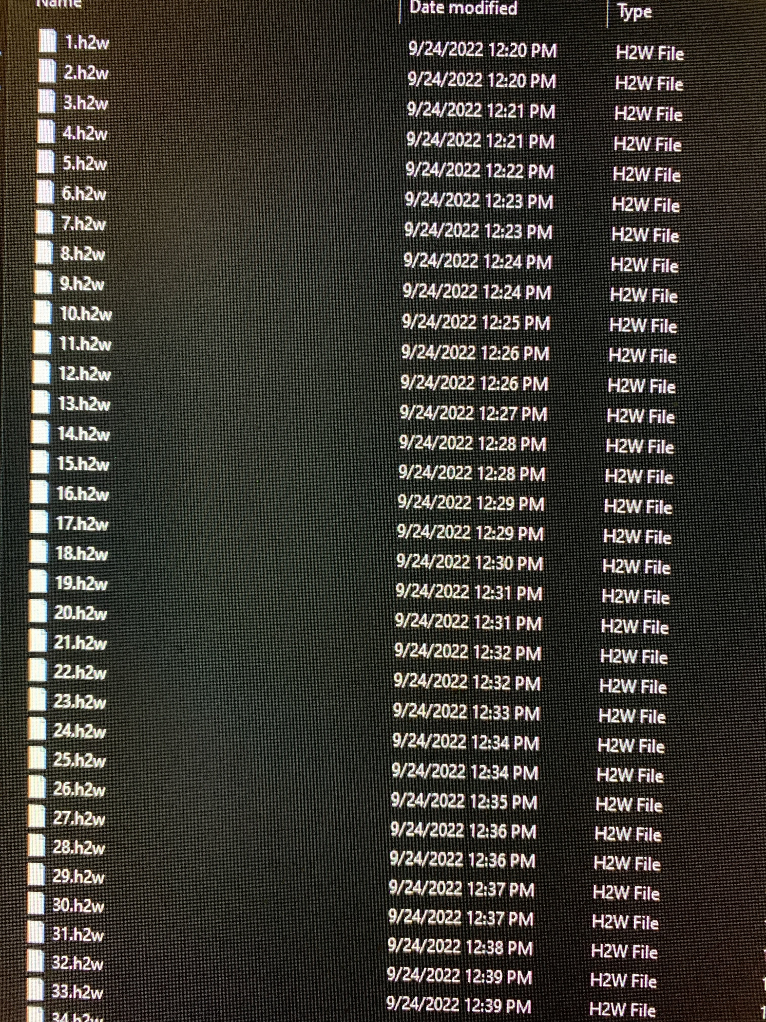

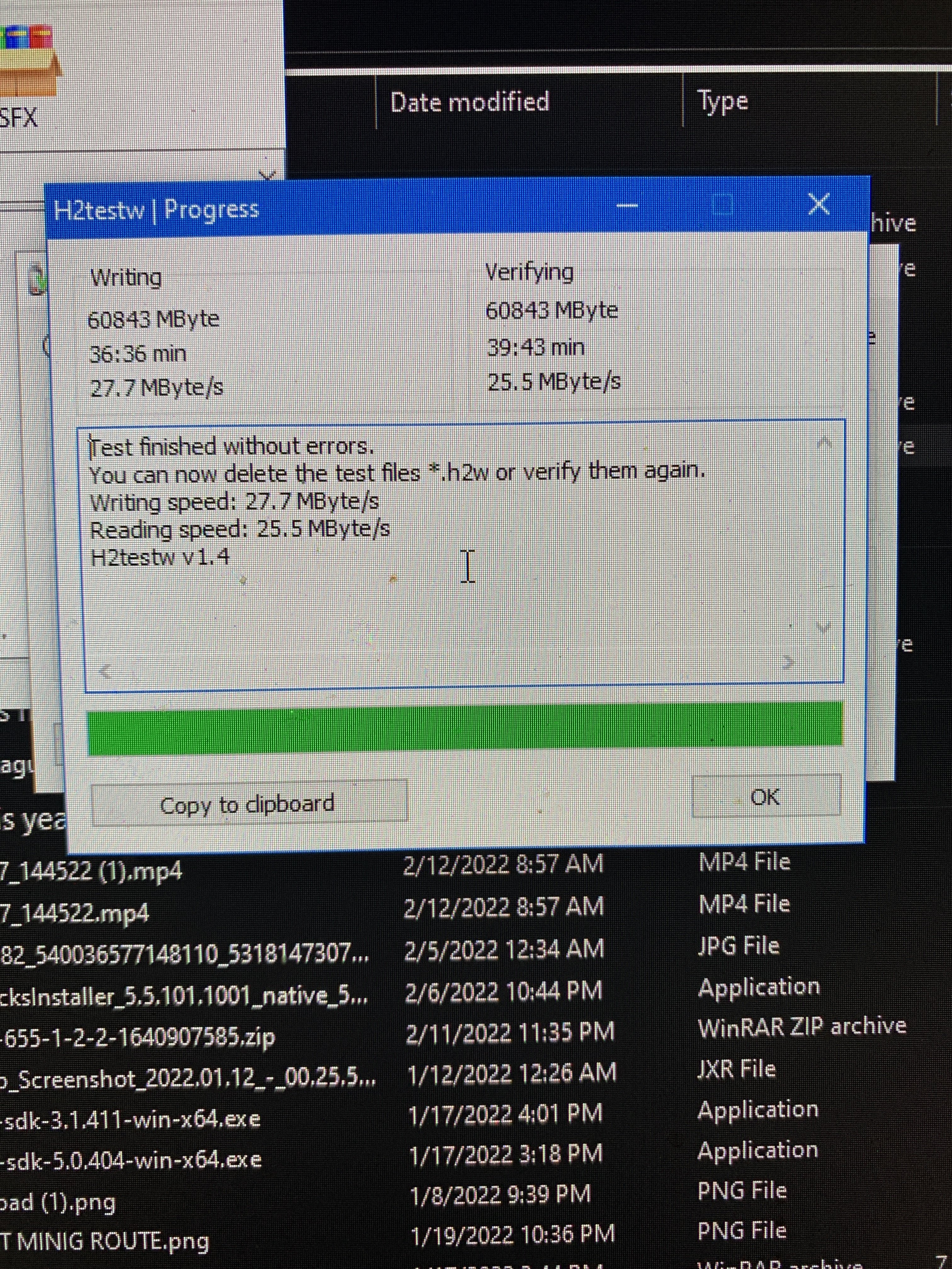

Like this?

Cool yout card is ok
Cioy firmware and godmode payload to it and try to load god andmode (keep pressing start and press briefly power without let go start until the lima chainloaders menu shows
