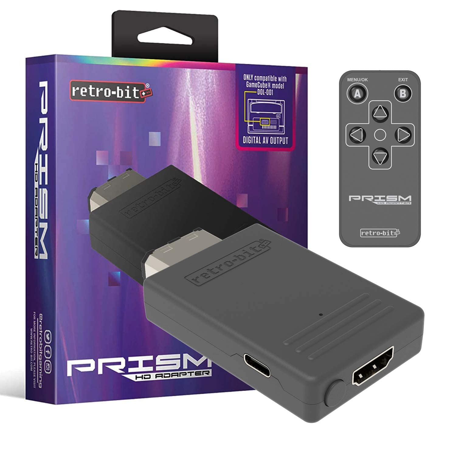

well if you want 480p you need an adapter that plugs to the digital out i recommend the Retro-Bit Prism HDMI Adapter for GameCube
The Kaiko cable that you got is for the AV out and that will never look good on a modern tv. the fact that it can also be use on the N64 tells you how poop it is.
If your going to play on Gamecube you need something that plugs into the digital out
Thanks, I'll look at getting this.
