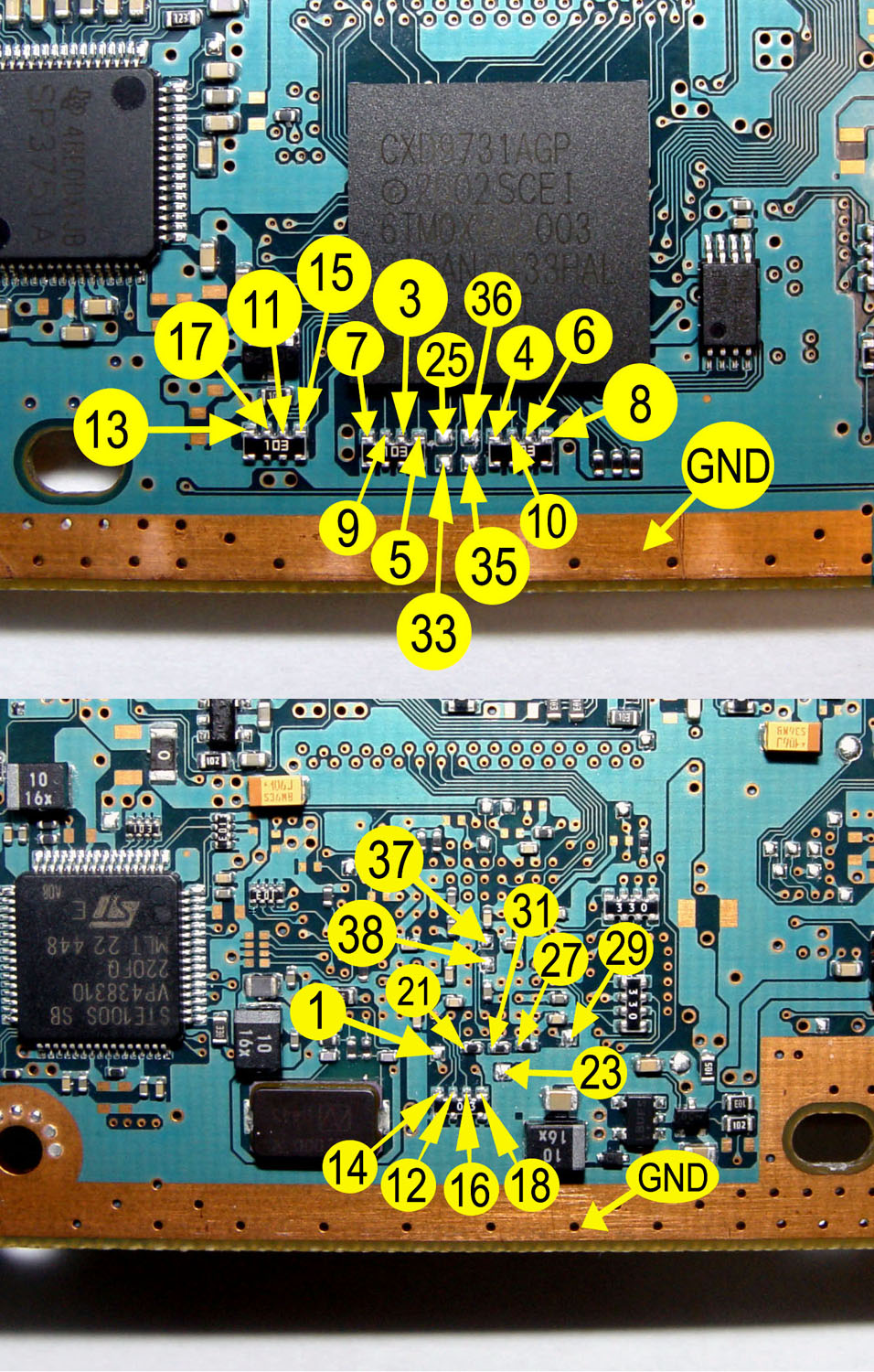

Anyone ever perform this mod or similar? I have been bored and I have been looking at new soldering projects. From the videos I have watched, it looks like a lot of fun. For those that have performed the mod, was it worth it?

Adding the disk connector (on a 700xx) is a legitimate, though tedious, soldering job and works :) (with the caveat you need FMCB anyways to make the disk bootable for FHDB/HDDOSD/PSBBN)
Never tried a SD to IDE converter (most every CF card has that natively with a plain mechanical adapter, which - although of course it has happened, with ones missing the DMA lines - is much harder to screw up than the common conversion chip with performance and compatibility issues; on the other hand, if you want a stupidly large drive* partitioned with PS2's APA, any form of instant-seeking SSD will make it bearable)
* that, for a PS2, is "give or take more than 80 GB full of game backups", at which point the amount of partitions doesn't fit in cache anymore so a sequential read of one sector every 128 MB or so turns into restarting from the first sector at each partition

No because I am probably not going to play it. I just really want to solder something.I need either a microSD mod which fits completely inside the system or a microSD mod that you cut part of the case for the slot. I am fine with an internal SD mod, but not sure if I can FTP to add or remove games.

Gou Mods previously sold microSD modded PS2 slims on Etsy. The installation is spaghetti heaven.

Any schematics available? I am iffy if I will ever do this mod, but I am definitely considering it.
You need to buy an SD to IDE adapter, remove the IDE connector and then wire the pins up to the points on the diagram.
