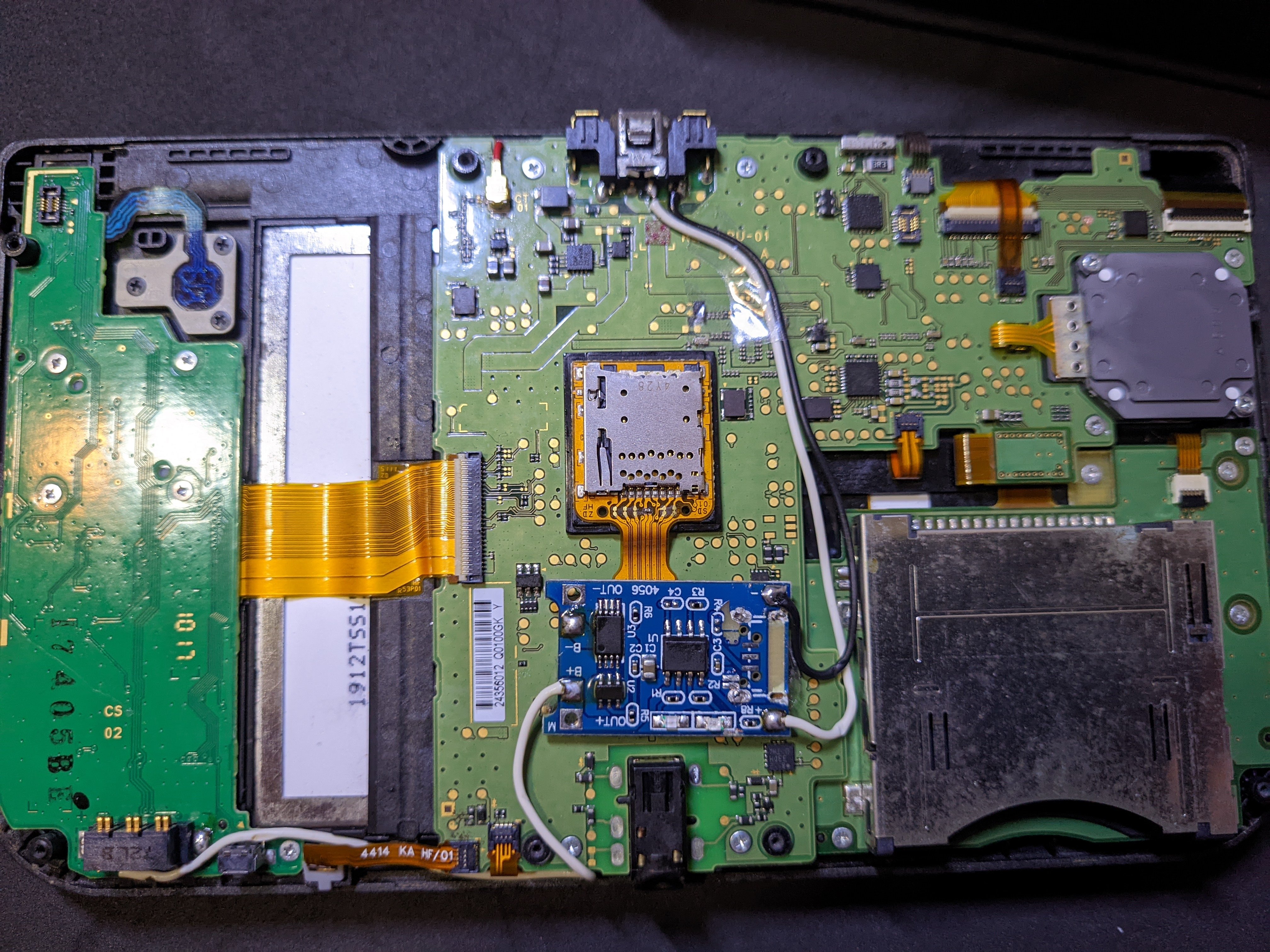

Hello everyone, I had a problem with my New 3DS XL because of a mistake I made, I reversed the battery when I was doing maintenance, I changed the daughter board, it worked, however, it did not charge the battery anymore, it only worked connected to the power.
I had an idea, but I wanted to see if there was someone who had already done the same to be sure if it would work, but I didn't find anything, I decided to take a chance and it worked, 3DS completely repaired, what I did was install one of these TP4056 modules, there are already 2 I've been using it for months and it's charging normally.
I'll post a picture of how I did it
Obviously, behind the plaque, it is isolated so as not to touch the motherboard directly and I removed the USB port from the TP4056 module so that the height was low and it could fit comfortably when closing the 3DS.
yes that works, but please insulate that chip or you will potentially short something on the MB

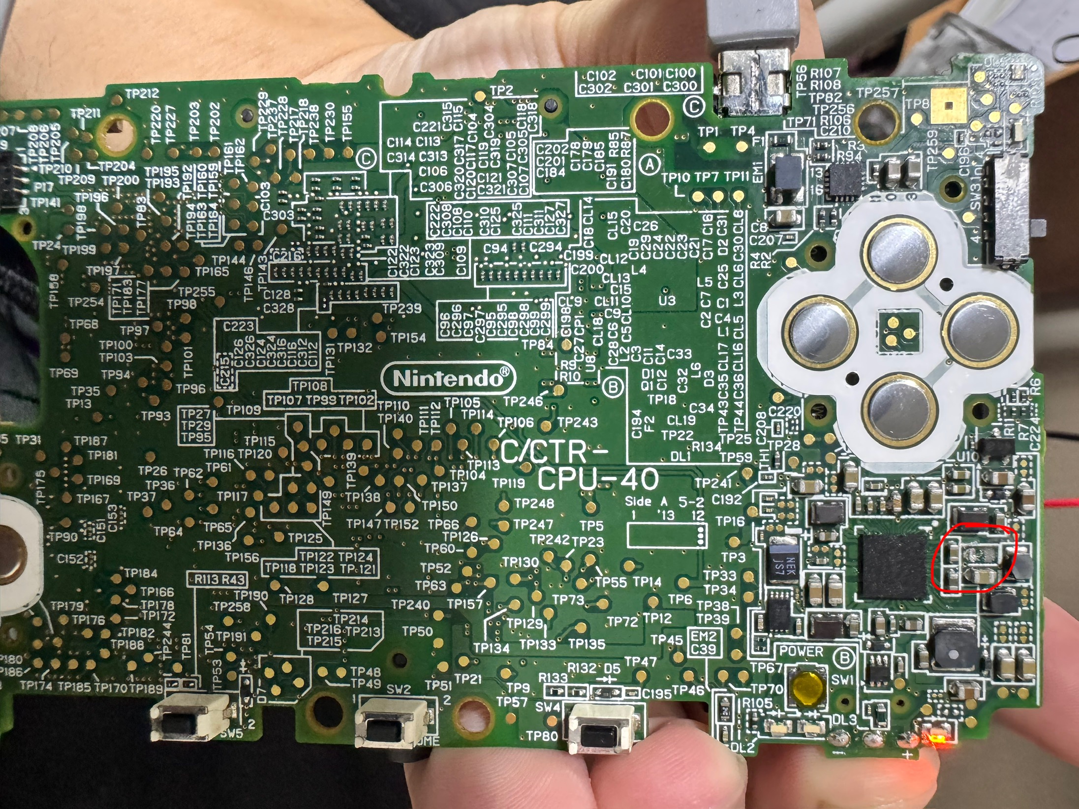

In short I'm in the same boat and I tried to buy one chip but the links in this thread are outdated I'll attach a pic from my new 3ds xl motherboard. I want to know if this chip will work or not
https://a.aliexpress.com/_EuXLEo5
I'll be grateful of any advice thanks
it's the same as the ones from regular 3ds.
