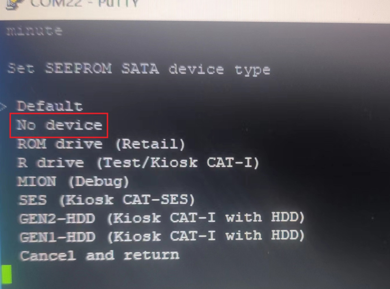

As you know,I messed up a wiiu SLC&MLC, created additional corrupted directories in the usr folder. So i used De_fuse to restore. De_fuse PICO 0.5 support refreshing SLC, MLC....
I restored the original backup. But new error have emerged, The console told me 160-1400.I am very certain that my Disk drive is not damaged. So I checked CM9 and CM10 according to this. But they all work normally. Later, I found an option in Minute_minute that can fix 160-1400. I don't understand the principle, but it does work.
" Backup and Restore >> Set SEEPROM SATA device type >>No device "
If you have an irreparable 160-1400 console, Maybe you can try this.

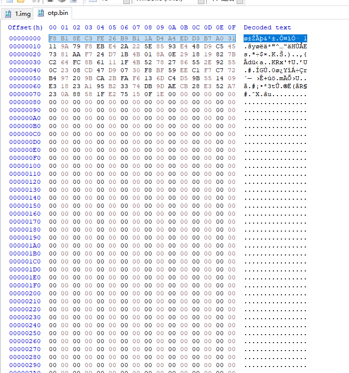

In recent days, I have been fixing the third WIIU. My last one. This is a thorough Brick:ohnoes:,Stuck on Logo ,UDPIH is not working。It has a Samsung SLC, I use De_ Fuse connects it to download OTP,I read this OTP by HEX,I feel very sad,because it appears that the OTP data has been corrupted. this is very strange。:ohnoes:
Might be a bug in de_fuse? I mean de_fuse zeroes the OTP area and what we see looks like an (almost completely) zeroed OTP to me, no? So maybe try a few different de_fuse versions (I remember this had been fixed in the past, so maybe we see a regression?).
//EDIT: To make this clear: The OTP / eFuses are not zeroed. That's impossible (it's called one time programmable for a reason) but the Wii U copies the eFuse registers into transient registers and that's where de_fuse kicks in, so the transient registers will be zeroed and the eFuses will no longer be accessible after that. IIRC early de_fuse versions gave a zeroed OTP dump thanks to this but a workaround had been added.
//EDIT²: A zeroed OTP tells the Wii U it is in factory mode, loading an unsigned firmware image from the SD card. That's the whole point of de_fuse.
Thank you, your reminder has given me another glimmer of light. I am using De_ Fuse PICO 0.5, maybe I should try another version or wait for an updated version.
Does it mean that my Wiiu still has the possibility to fixed? Sorry, I need to read multiple times to understand.

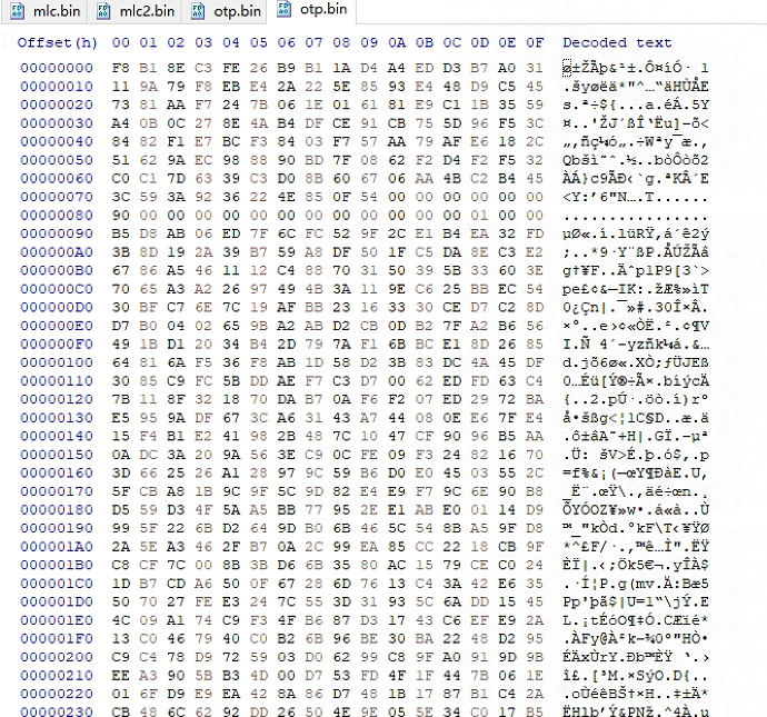

To be fair I'm not really familiar with de_fuse nor minute_minute but from looking at minute_minutes source codes it seems there are two ways to dump the otp: "Dump SEEPROM & OTP" and "Dump OTP via PRSHhax".
I'm not sure if I'm understanding the codes correctly but try "Dump OTP via PRSHhax" immediately followed by "Dump SEEPROM & OTP". In case I'm understanding this correctly PRSHhax is the workaround to not get a zeroed dump but it does the dump to RAM only, so you need the normal dump option afterwards to write that good dump from RAM to SD. That said: Does this give you a good dump?
Oh and make sure to use latest versions from https://github.com/shinyquagsire23/wii_u_modchip and https://github.com/shinyquagsire23/minute_minute (can't see releases there so you might need to compile for yourself).
Nice! copy that!I will try it tonight.Thanks!!!
I don't know how to compile, perhaps I should wait for the subsequent release version. Thank you again for your guidance.:D
You're right. I successfully downloaded the correct OTP.

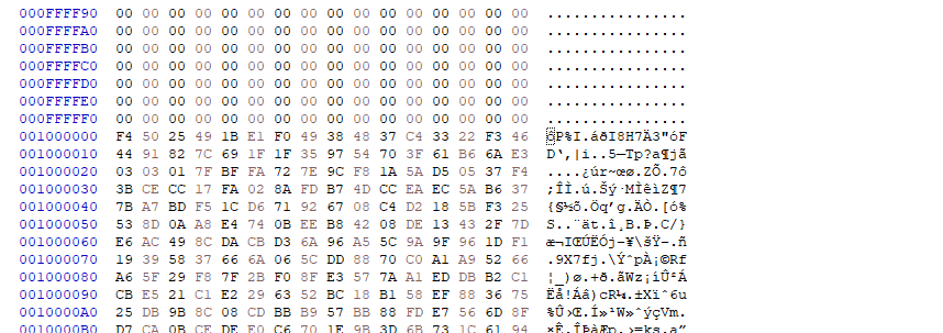

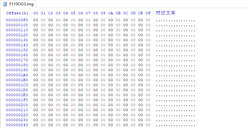

Without the mlc it shouldn't be able to display the logo
Right!without the mlc or sd card,there is no display the logo。
I dumped MLC by sd cardreader , the header of the file is empty,Is it possible that this is the problem?
Or, it seems that the CPU cannot connect to EMMC?

I think @Lazr1026 saw something similar.
If that was a brand new never touched console, I could Imagine, that this part is only in the slc cache and wasn't evicted yet to the eMMC. But I also could be wrong.
Can you upload the SLC and the OTP somewhere and share the link in a PN with me? If you could also upload the mlc that would be great, then I could run it in the Firmware Emulator. If the mlc still has lots of zeros it could zip very well.
