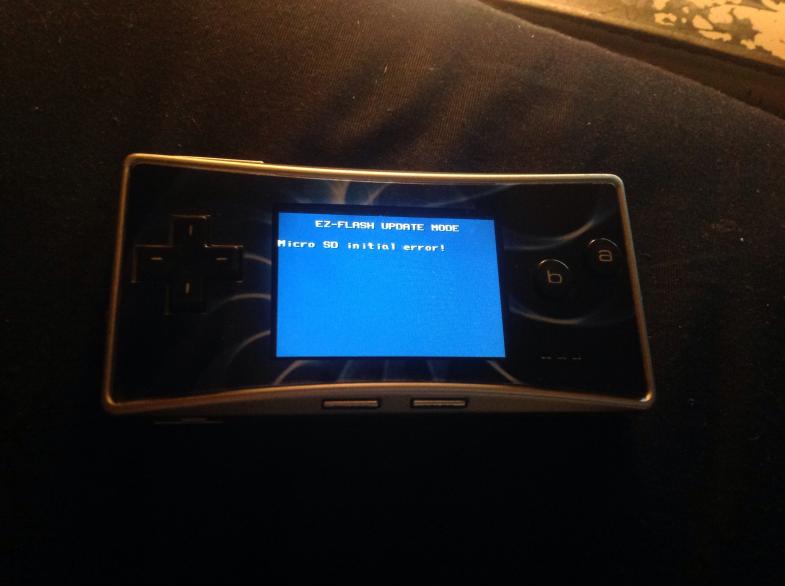

I just bought the EZ Flash Omega, i have followed the instructions for setup and I keep getting the error "Micro SD initial error!".
I am using a Game Boy micro (model OXY-001)
The Micro SD card I am using is a SanDisk ImageMate microSDXC UHS-I 128GB, it is formatted as exFAT 32kb
I have attempted reformatting, cleaning the contacts, making sure the screw is tight, and jiggling the cartridge.
When I turn the system on (holding R) it shows the gameboy logo screen, then the ez flash logo screen, then shows the initial error screen (image below)
Any help would be appreciated

Try a smaller card 2-4-8-16GB
