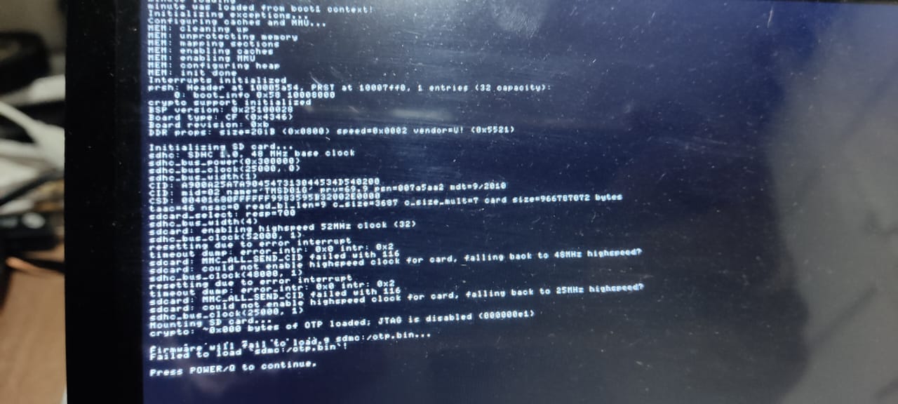

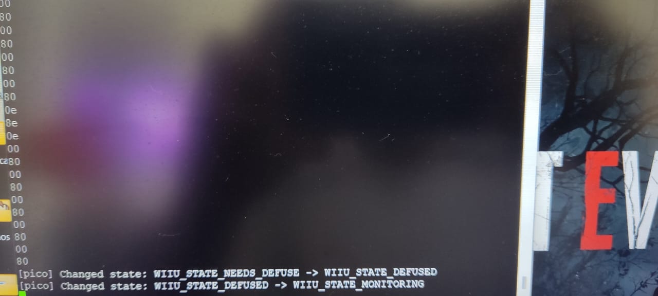

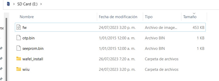

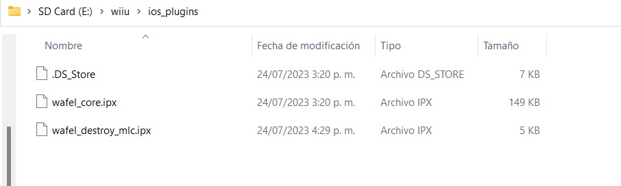

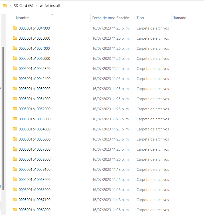

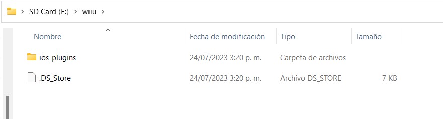

I downloaded de fuse 0.7 again, rewritten boot1.img, and downloaded wafel _ Destroy_ Mlc.ipx again. But the problem hasn't changed, it still sticks on
U▒U▒U▒U▒U▒U▒U▒U[Pico] Switching to data mode...
fe 00 02 07 21 00 00 43 46 25 10 00 28 4d 45 4d
32 4d 45 4d 30 50 52 53 48 5d 5d 00 01 5d 5d 00
02 84 00 00 00
Please refer to the pictures. Do these files appear to be correct?

I find it strange that the serial output stops there. Normally you should see the minute menu on the serial and then you can select patch and boot ios. Maybe try without the wafel_destroy_mlc.ipx

Without the wafel_destroy_mlc.ipx ,the situation has not changed either.
I don't know if this information is helpful.
This is a functioning console, fixing by nand-aid. The SD card I am using can run normally with De fuse 0.51 ,The TF card with nand-aid is ADATA 32GB,

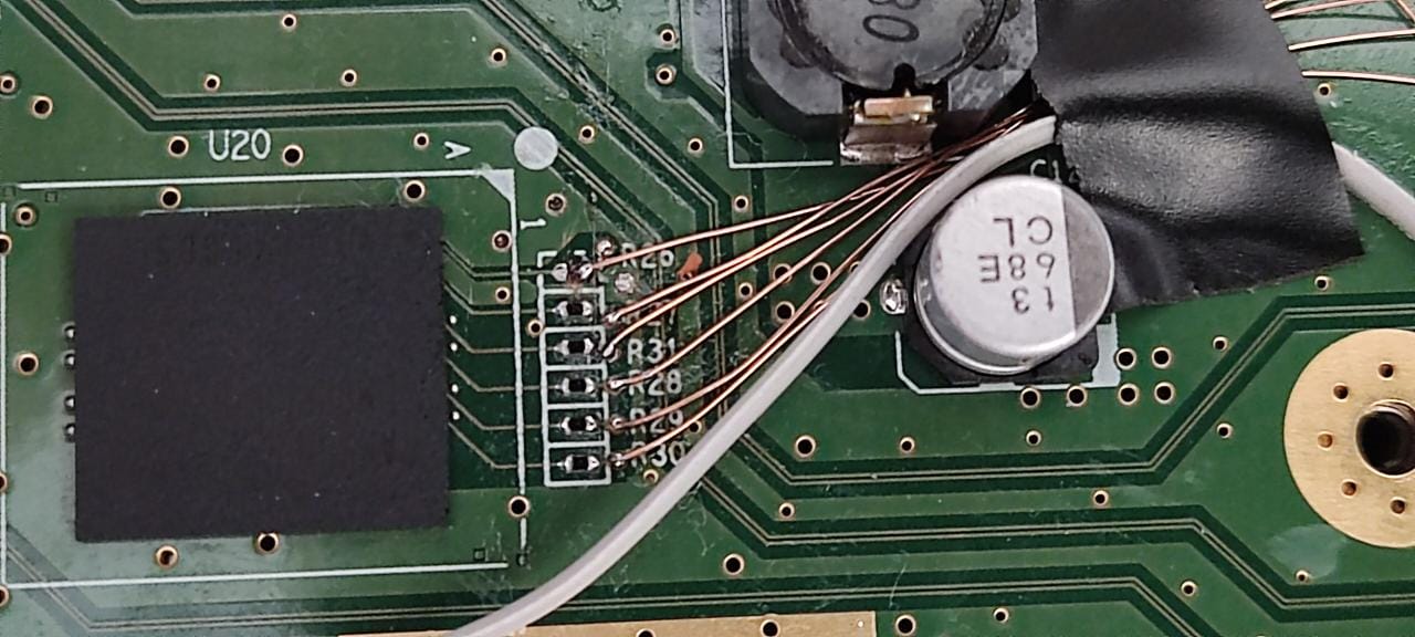

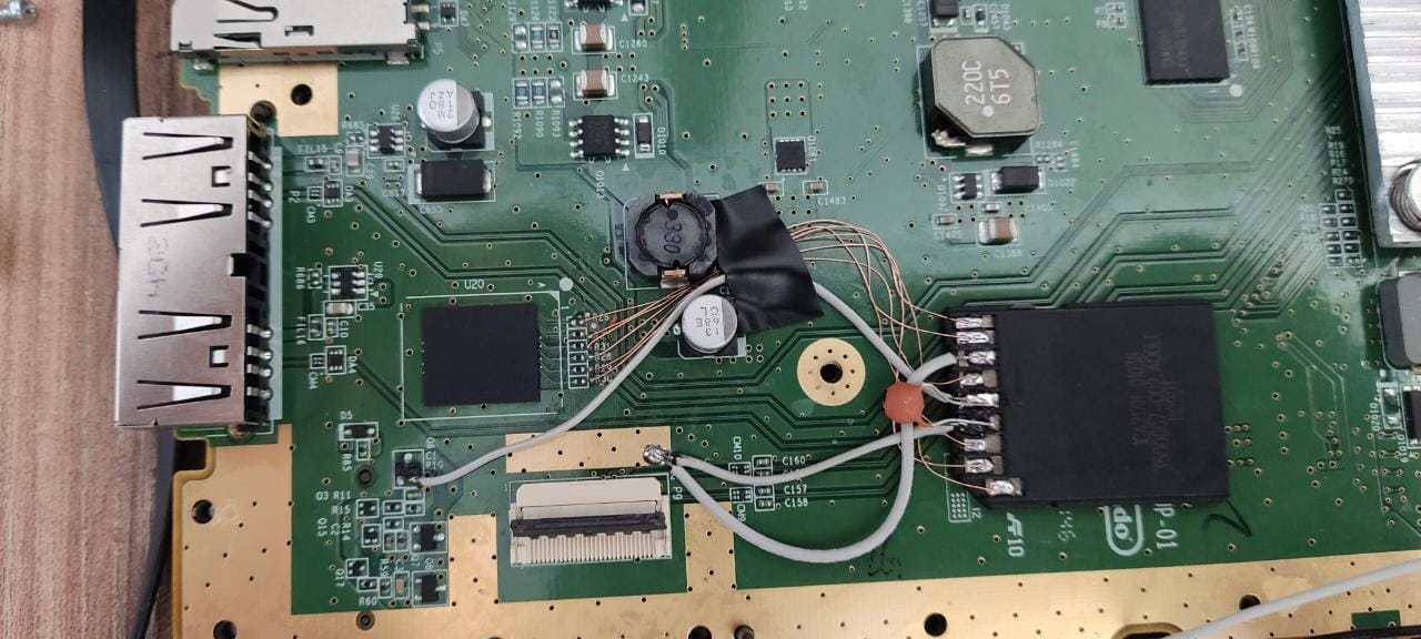

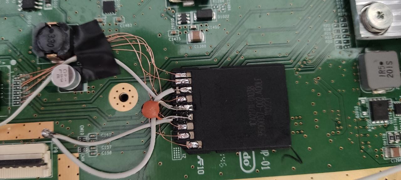

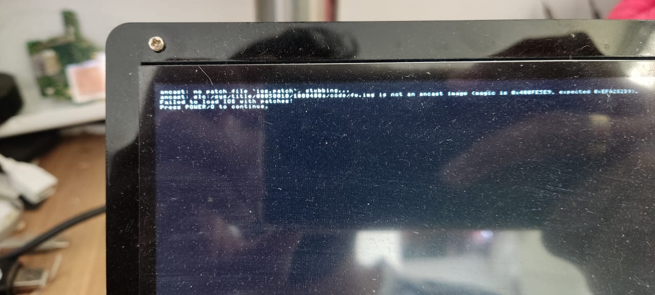

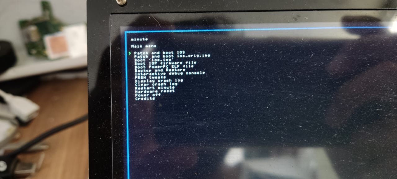

Hi thanks for the tutorial i am trying to revive a wii u with blinking blue light.
I have the RB pi pico already connected, I also installed a 32GB SD module, made the cut in CLK and took that point on the far side of the EMMC.
The other points are taken from the resistors next to where there is a kind of test point.
I initialize de_fuse and the minute menu appears on a monitor, in this tutorial it is indicated that you have to enter stroopwafel mode. But I don't see that option or it refers to the first item in the minute menu, the one that says patch and boot ios. I will attach images of the menu that appears on the putty monitor, the menu does not appear. I will also attach images of what I have on the SD card. thank you
Note, in the image of the installation of the SD module, the cap and the bridge of the two GND are missing, which are already in the final installation
Yes, that's it.
//EDIT: Am I allowed to use your picture of the soldered micro SD adapter for https://gbatemp.net/threads/using-nand-aid-to-replace-a-hardware-damaged-mlc-160-0103-error.636361/ ? :)
//EDIT²: And you're missing the capacitor at the microSD slot. It might work without but in case you have one it might be a good idea to add it (esp. if we want to use a picture of it for the linked tutorial).
//EDIT³: Also hard to tell but it looks as the second ground PIN on the adapter isn't connected. Just use a short cable (enemerald wire works, too, it's just a short distance after all) to bridge it to the other ground PIN. ;)

Si eso es.

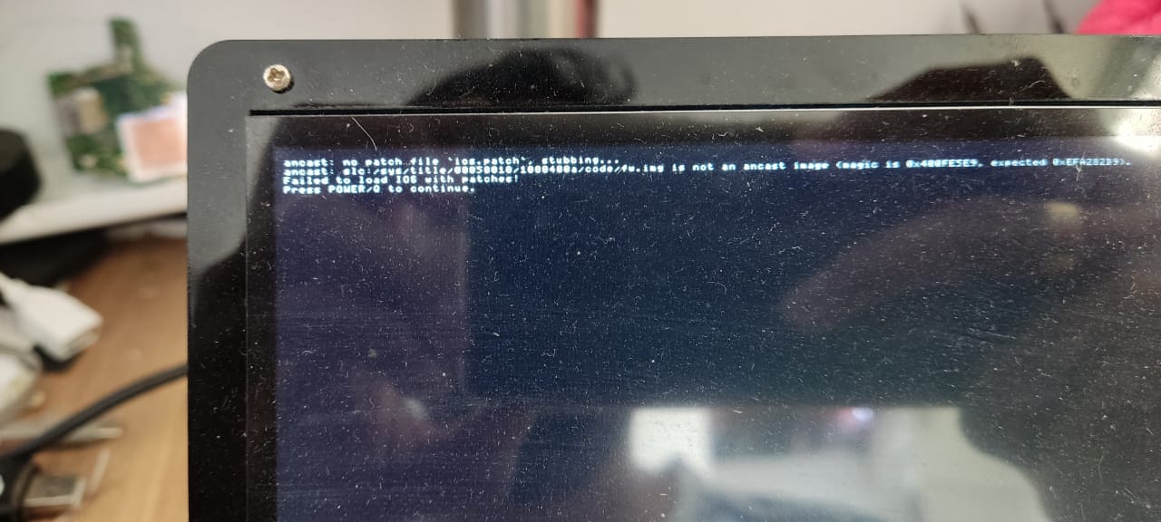

me sale error en la imagen adjunta
Yes, that's it.
They are already corrected, I will disassemble the console to take an image, so that you can add it to the tutorial, I would be very proud to see an image of my authorship in the tutorial so that it can be of use to more people.
I don't want to intentionally mislead you, but what SDIO said above, I think you can also try. I think it also applies to your console
SDIO:
"If you just want to make it work fast, I would siggest downloading the latest iosu with jnus and put the fw.img from it as ios_orig.img on the sd. Then you can use the second option in minute `Patch and boot ios_orig.img`.
I wouid then suggest you download also the SLC titles and put them also in the wafel_install, so the titles on the slc will be updated to during the mlc rebuild"
If I am wrong, please correct me or delete the reply.
SDIO:
EDIT:
First, backup SLC&SEEPROM before all operations.
thank you,
How do you do that download?
"downloading the latest iosu with jnus"
I'm not sure what it is Jnus is it a software for windows or how do I download the latest iosu or what I have to do is change the name of the fw that I already have to ios_orig.img
on the other hand I already have MLC and SLC in the wafel_install folder I also have backup of SLC&SEEPROM
@Fabioperez You case seem to be a bit more complicated (I completely overlooked your statement about the blinking blue light). We (other devs and me) need some time but will try to help you ASAP.
Please don't do anything until you get a reply from someone with knowledge (Gary, Lazr, ShinyQuagsire, Quarky, SDIO or me).
Well, a few things you could do: Reconnect the original MLC and extract your SLC backup (we need the app.xml file from there). Also yea, as @Ysecond said download and extract latest IOSU so you have a fw.img at hand. Most likely we'll need this. But again: Don't do anything witht hat fw.img yet but wait for reply, please.
Thank you so I'll wait more to continue on the other hand as I download iosu it tells me it's with jnus, which is jnus where I can get it from, and in advance apologies for so much ignorance, how can I extract the app.xml file, since I have SLC.raw and SLCCMPT, I had already made that backup
