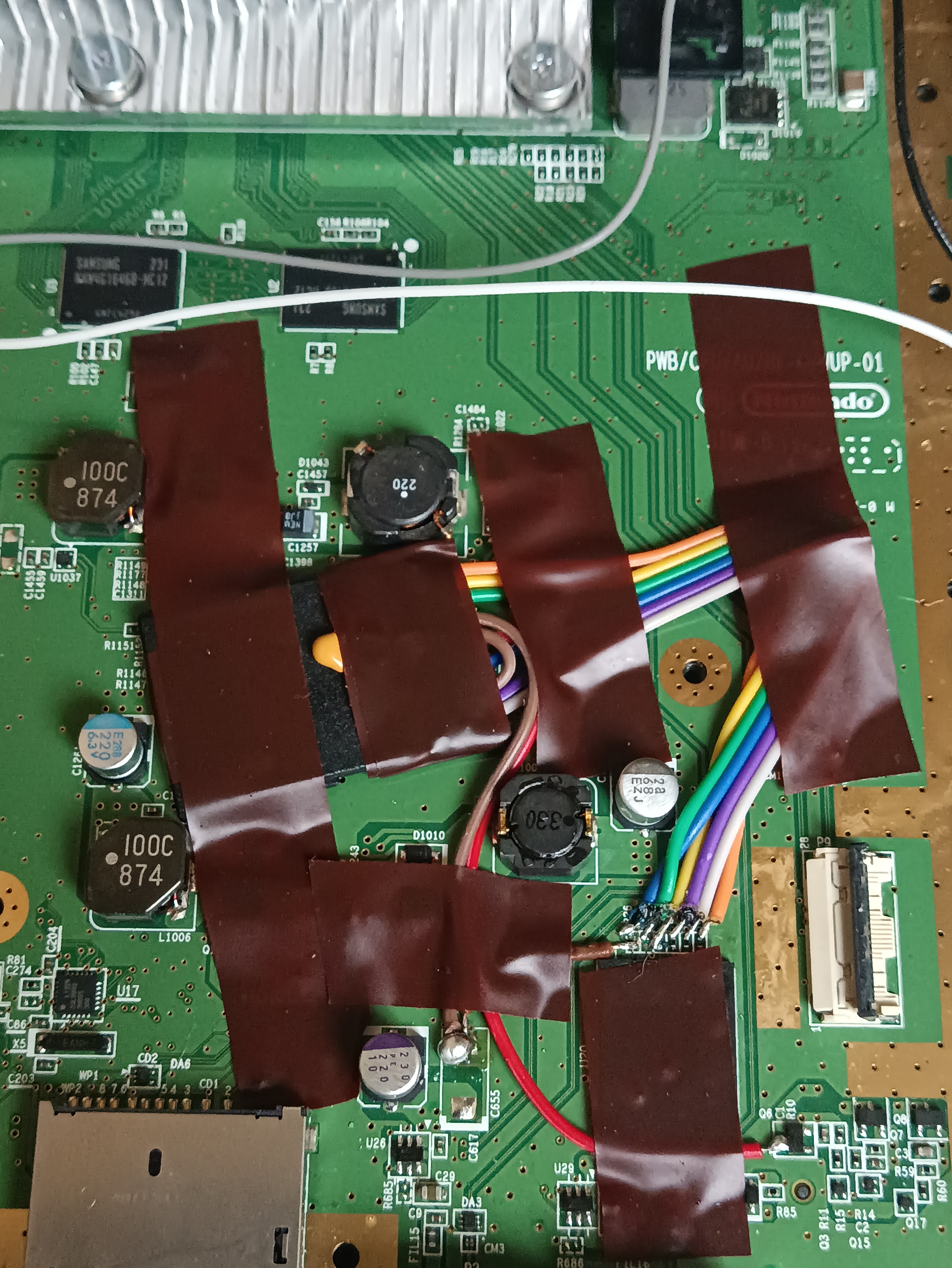

We highly recommend the NAND-AID for this:

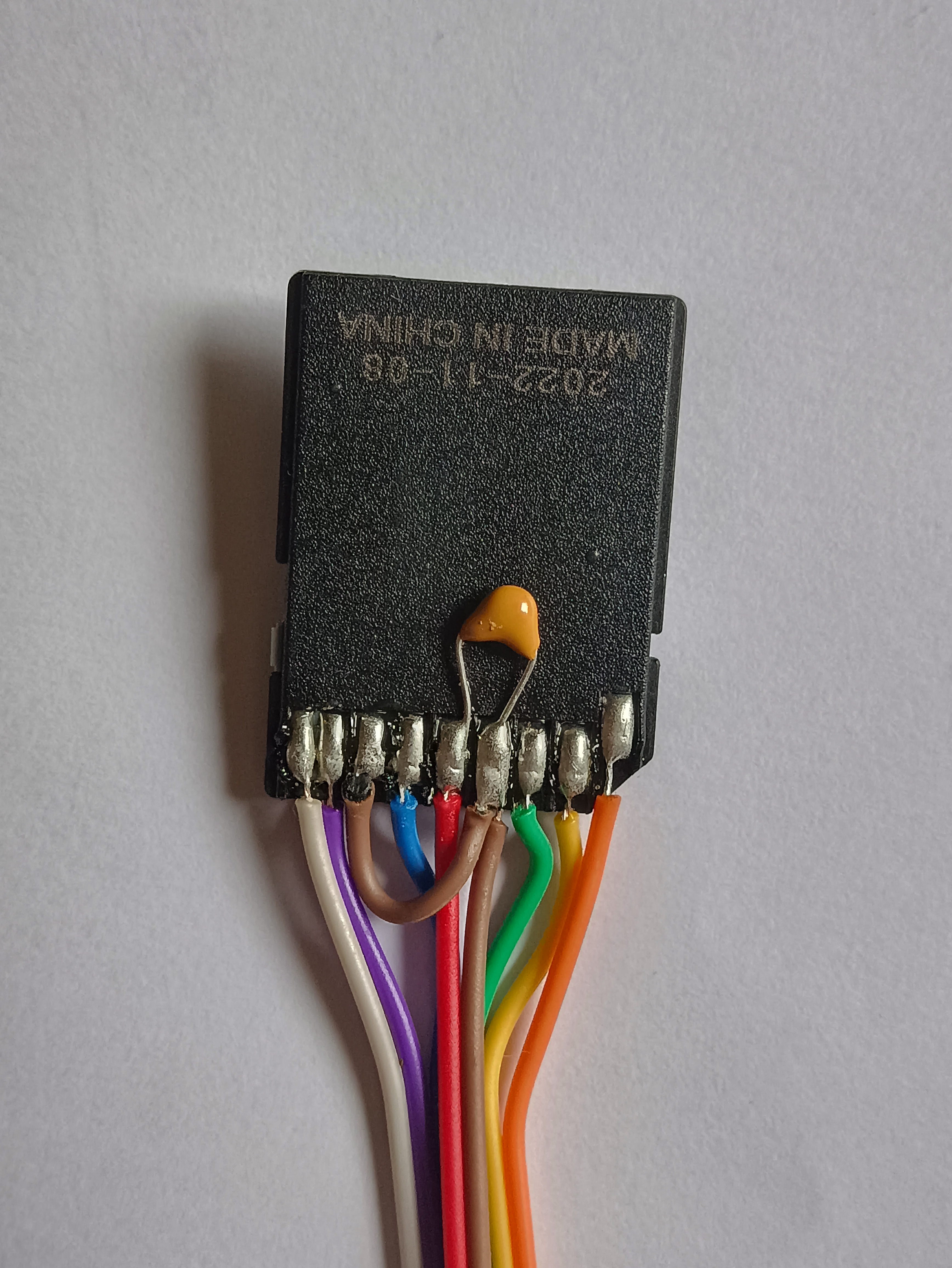

But ofc. it's also possible to DIY with some cables, a cap and a micro SD to SD adapter:
sdemmc-jpeg.354296
(note that these pictures are from the first tries, so there's a small mistake (3.3V line beeing grabbed from at the wrong spot)).

what is the value of that cap ?
IIRC it was 0.1uF but it's not that important (it might work even completely without the cap... basically anything between 0.1uF and 1uF should work (IIRC)).

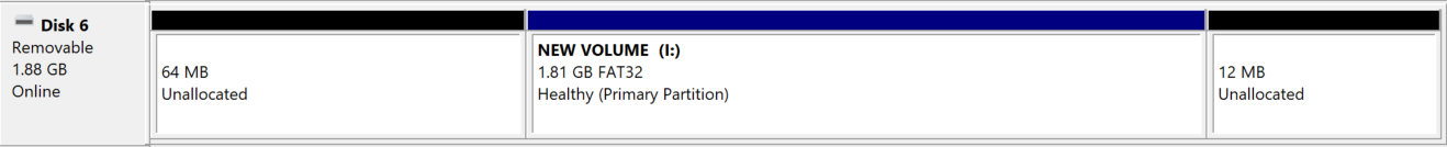

no, the 2GB card should be big enough. Maybe you didn't resize the partition? the 52 titles should take around 1,1GiB and a 2GB SD should give you 1,8GiB of usable space
Ah, wasn't aware resizing the partition was an option. I did look in windows disk management and the expand option was greyed out so figured it might have been somehow set to that size for a reason. I'll look into some partition software that should allow the resizing. Thank you.

try resizing after you formatted the partition. I dont knowwhat other tools might do to the sd, that yould breal defuse. Make sure to only move the end and not the start of the partition.

I just gave it a shot. Removed all partitions from the sd, wrote boot1.img, it created a 1gb raw partition. I was able to either shrink or delete this partition, expand was still greyed out. Formatted as Fat32, then the only option was to delete the partition with both shrink and expand being greyed out. I'll give a shot with partition manager and see what options it has so it doesn't destroy defuse. Still have yet to solder in a pico and receive the nand-aid so just making sure I got the steps down before messing with it so, no real way to test it just yet.
This is what the partition looks like now so I think it should be ok. Just didn't resize it to the full size as it would have also removed the 64mb at the beginning.
