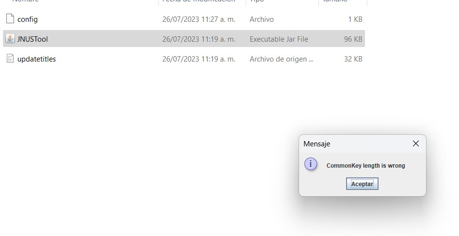

I already have it but I get an error when trying to open it. It has three files, one is the executable jar, another is the config and another I edited the config file with the commonkey but nothing or I don't know how I have to put the commonkey
config
1http://ccs.cdn.wup.shop.nintendo.net/ccs/download
2[COMMONKEY] ## commonkey here no brackets?
3updatetitles.csv
4https://tagaya.wup.shop.nintendo.net/tagaya/versionlist/EUR/EU/latest_version
5https://tagaya-wup.cdn.nintendo.net/tagaya/versionlist/EUR/EU/list/%d.versionlist
my wii u is USA edit line 4 and 5?
config
3updatetitles.csv
Edit: @V10lator I already got it to work but it opens is a list of games I don't see the iosu or how it works jnus thanks
Just use the command line or create a batch file with the following command:
java -jar JNUSTool.jar 000500101000400A

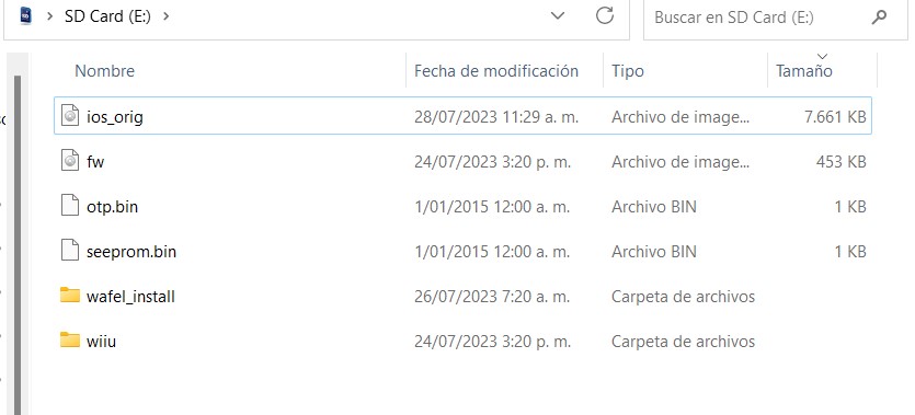

i am trying to revive a wii u with blinking blue light.
Blue blinking means boot1 has problems loading IOSU from the the SLC. This is not a MLC problem, so you can remove the SD replacment and connect the eMMC clk back.
Also we shouldn't try to install anything yet, so please remove all ios_plugins except the stroopwafel.ipx.
In 2.jpg we can see the opt.bin is missing. We need that, for both minute to load anything from slc, also to boot an iosu and to extract the slc.
You can dump it with minute. Got to the Backup and Restore menu and select "Dump OTP with PRSH hax".
With the otp dumped you can then select the first option (Patch and boot IOS) again and see how far it gets. Depending on the errors we will decide what to do next.

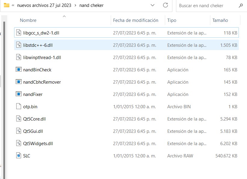

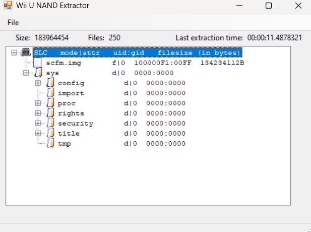

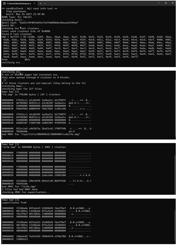

@SDIO, I am writing to let you know that I am still working on this, I do not have the gamepad at hand because the battery is damaged and I asked for a replacement, I wait for it to arrive more or less two months, I am working on a battery mod while the new one arrives, everything that is seen in putty does not load on the TV monitor, the wii u stops there with the purple led, I will perform the SLC download again and perform the requested extraction
@ I already made the backup of SLC again, download the indicated tools and in wii u nand extractor I enter the sys folder but the log folder does not appear the other requested files app.xml and system.xml if I found them I attach them as an image of the file tree of my SLC
On the other hand, with the nand checker I have problems I try to run it but it does nothing, I am running it by copying otp.bin and SLC.RAW in the same folder where the nand checker files are located, attached image of the files found in the nand checker folder
Edit 1
I attached info.txt which was what was shown on the screen when I made the backup of SLC, I also made backup SLCCMPT nand extractor and checker I am doing them with SLC
Edit 2
take the SLC file and drag it to the nand bin checker executable a console window opened but no file is generated so what I did was make a screen recording and frame by frame take images and the result is in the attached image number 5, a "bad hmac" error is observed

Strange that the log folder doesn't exist. Maybe the Wii U never worked and therefore never created logs. Do you know it's history?
From the system.xml I can see that the console still uses OSv9 <default_os_id type="hexBinary" length="8">0005001010004009</default_os_id> That is probably the reason why it didn't boot, in your last attempt, because minute_minute is hardcoded to load OSv10 (what it did, but it probably doesn't work with your old firmware).
I have the strong suspicion, that your OSv9 is corrupted.
You can extract the OSv9 from your slc dump /sys/title/00050010/10004009 and then take a look at its app.xml to see it's version (int the <title_version> tag). The verion will either be 1005 or 1006
You can then use JNUS to download the OSv9 (change the last part for the right version):
java -jar JNUSTool.jar 0005001010004009 1006
You can then copy the fw.img from that download to the SD and name it ios_orig.img and then select the second option in minute and see what happen.
Also you can compare the files you downloaded to the ones extracted from your slc to see if there is any difference.
EDIT: nandBinCheck showed that the fw.img of OSv9 is corrupted, as I predicted. So what I wrote above should be on the right track.
<?xml version="1.0" encoding = "utf-8"?>
<app type="complex" access="777">
<version type="unsignedInt" length="4">14</version>
<os_version type="hexBinary" length="8">0000000000000000</os_version>
<title_id type="hexBinary" length="8">0005001010004009</title_id>
<title_version type="hexBinary" length="2">03ee</title_version>
<sdk_version type="unsignedInt" length="4">20605</sdk_version>
<app_type type="hexBinary" length="4">1000000a</app_type>
<group_id type="hexBinary" length="4">00000000</group_id>
</app>
<title_version>03ee
SDIO
Feb 13, 2023
2,417
28
1,685
Germany
Thats hex, so in decimal it's 1006, whch is the latest version. So yoou can just omit this parameter and jnus will get the latest, which is 1006 (0x03ee) for you

wow my level of ignorance
edit1
I already downloaded with jnus, I had to edit the config file with the common key in case anyone is interested, I continue testing in 2 hours, I have to make lunch for my son
edit2 @SDIO

I didn't expect anything interesing on the console, since stroopwafel dosn't support that for OSv9. But I hoped the console would boot.
I assume it is still sitting there with no screen output?
You can also try to rename the OSv9 fw.img to ios.img on the sd and try the third option from the menu "Boot 'ios.img". You can also try running the "Dump OTP with PRSH hax" option and when that is done, without rebooting agin try the "Boot ios.img" again.
In case none of this works do the following:
Download OSv9, but this time with the encrypted option:
java -jar JNUSTool.jar 0005001010004009 -dlEncrypted
This will create a tmp_0005001010004009 folder. Put that in the wafel_install folder on the sd and make sure there is nothing else in the wafel_install folder.
Then put the wafel_install.ipx in the wiiu/ios_plugins folder.
After that put the fw.img of the latest OSv10 renamed to `ios_orig.img` on the SD.
Boot to minute and select the second option. You should now see more output. The LED should change to blue blinking and after that to static blue. Then you can turn off the Wii U. If it turn orange or red send me the wafel_setup_mlc.log file that will be created on the SD.
Then start the Wii U without defuse (just remove USB and 3V3 from the Pico) and see what happens.
  • wafel_install.ipx.zip
Fabioperez
Jul 31, 2022
32
40
San Gil
227
Colombia
No esperaba nada interesante en la consola, ya que stroopwafel no es compatible con OSv9. Pero esperaba que la consola arrancara.
¿Supongo que todavía está sentado allí sin salida de pantalla?
