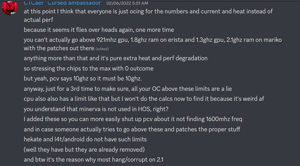

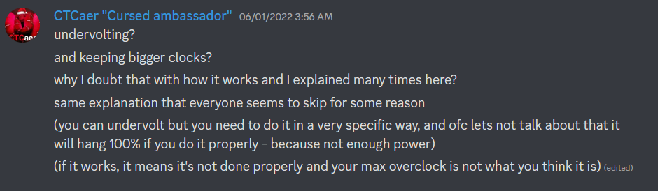

About undervolting quoting directly from ZachyCatGames (the original creator of the 1862 RAM patch)
'the system will claim it's running at X frequency but calculated voltages will be too low and the GPU will drop frequency, hang, or spew errors'. It's not a bug with status monitor its just how the Switch's operating system Horizon is. Status Monitor is just reporting what's in the PCV which is modified by the loader.kip. You couldn't do this same thing with L4T (Linux) for Switch because it will get rid of these 'fake' clocks.
I would highly recommend reading his entire post about the pitfalls of undervolting and why Cooler's stuff doesn't work the way he think it does: https://gbatemp.net/threads/sys-clk-under-overclocking-sysmodule.531372/post-10054079 (TLDR it's crazy undervolted so the clocks in status monitor are lying and you get worse performance then you would at stock voltages.
Also if you make an 'optimized undervolted' loader.kip please don't share it as it's only going to work on your Switch and you know already but thoroughly check using benchmarks. If you have any more questions about this undervolting stuff I'd probably ask CTCaer. Honestly I'm a bit unsure if you should do it at all.

Crash Trilogy doesn't have dynamic res its always 480p in handheld and 720p in docked, and I seriously doubt Hot Wheels Menu uses dynamic res.
